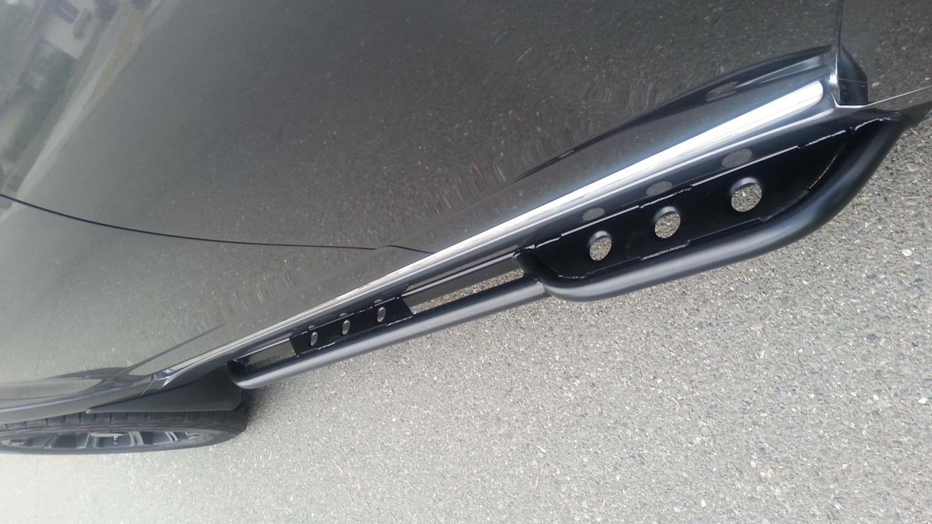

I got 12 bolts also plus the 2 bigger ones for mounting the extra bracket... Maybe on the drivers side back you don't have to use 3 (there are no instructions so not sure) but since I can I'm going to fill every hole that takes a bolt... All the "empty" ones in the pics don't have threads to screw into except the drivers middle one that I'm going to buy a bolt for.
Got some naval gelly in the drivers middle hole today to clean out the rust with it and some dollar store pipe cleaners... This was my first time using the stuff but it worked flawlessly! Also picked up a grade 8 bolt (m8 x 1.25) and put it in, so now all possible bolts are on the sliders.
Then, just because I'm anal, I covered the bolt heads with liquid electrical tape so their less likely to rust.
Finally!

Powder coated.. Just received it this afternoon and installed it within the hour. =) haha. It wasn't easy, that thing is heavy trying to lift it by myself.
