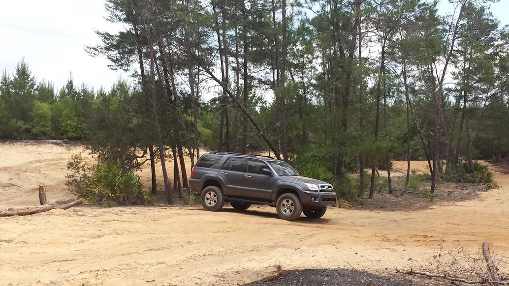

I've got the Roger Brown 1.5" body lift and I did not have to extend any lines or wires. I still rub a tad on full lock in forward and worse in reverse. Current tires are Nitto Terra Grapplers size 285/70/17. I too plan on upgrading to 35's by losing my current suspension setup (spacer lift) and upgrading to radflo's in front and all pro lift springs in the rear. I am 2wd, so I can also look to lift spindles up front if necessary.
Here is a pic of how it sits currently.
