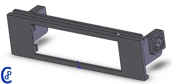

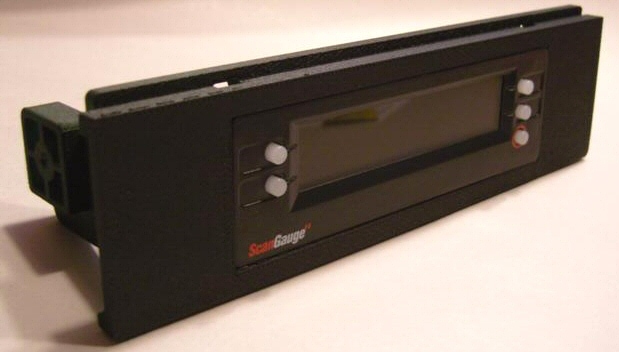

Agreed. Scanguage's are awesome! I took mine apart and flush mounted it in my Titan's dash. It went with the truck. Probably more to come regarding that...:)
i'd like to see pictures of that.
Don't have any pics of it. I can tell you that it turned out really well! The faceplate comes off easily with just a few screws, but the sides of it are curved, so it won't sit flush with the dash. That's where the mini tablesaw comes into play. :wow2:
Somebody send me a free Scanguage and I'll show everybody how to do it! (hopefully that'll be the next MOD)
Where would you mount in a 5th Gen?
