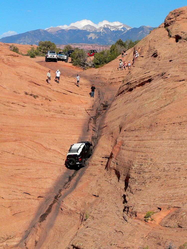

This is what Hell's Gate looks like from the bottom (and it's me spotting someone up it):

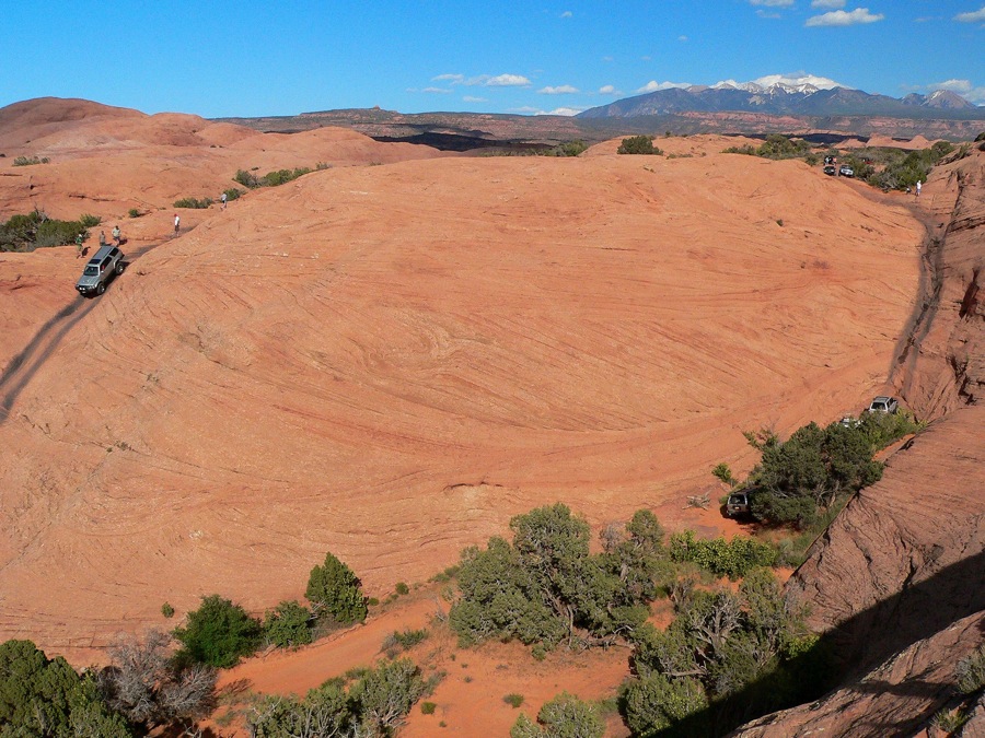

This is a shot of the down and up parts of Hell's Gate:

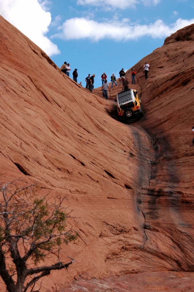

This is me going up Hell's Gate in my FJ (haven't been there yet in my 4-Runner):

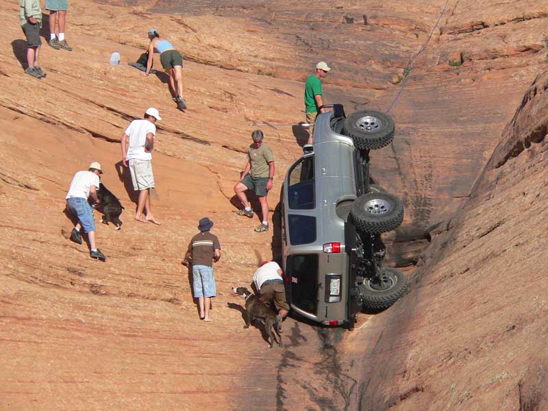

And this is what can happen on Hell's Gate (result of way too much throttle):
You can do it with ATRAC only but I'd also advise having your rear locker engaged. It's not a particularly difficult obstacle but as you can see, the consequences of making a mistake are rather substantial. Having a very good spotter is paramount. I've seen many bad spotting jobs on Hell's Gate and far less really good ones (it's amazing the number of folks that will jump in to spot someone up it without having much of a clue what they're doing). Airing down to 15 lbs. is a VERY good idea. It makes slipping off the wall with your passenger side tires much less likely. You can pretty much see the proper line by looking at the tire tracks. I'd be careful of areas where there are oil spills since that seems to happen quite often. I've done it in the rain and the traction is fine so I wouldn't worry much about that. Find the absolute best spotter you can find that has experience with the obstacle and make certain you're on the same page with respect to his/her directions. Have fun should you try it.
