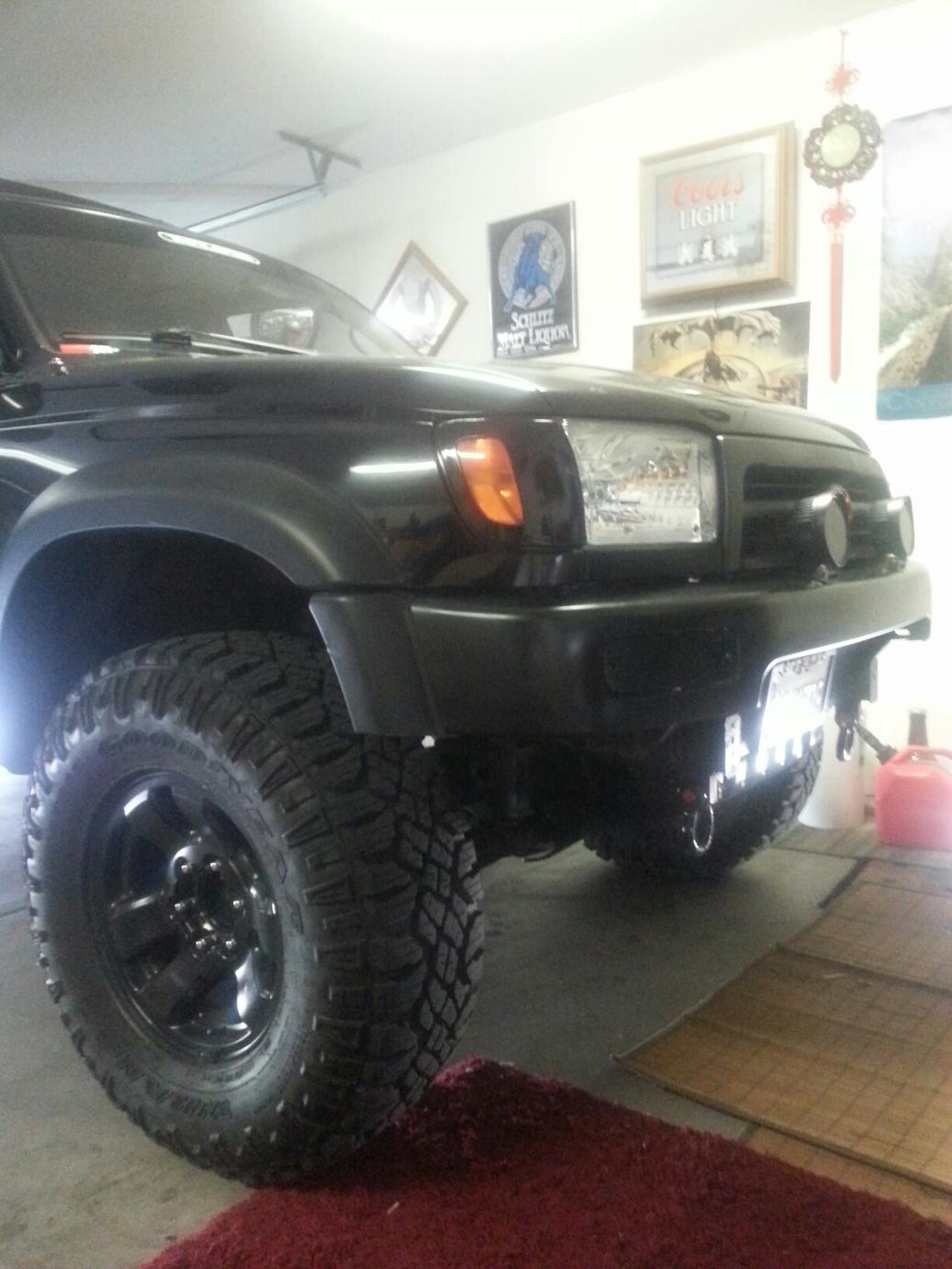

Here's mine before/with and after/without the lower portion. I don't have a preference either way with the stock bumper but mines off and I do like the tube design in place of it with the stock bumper. I think that looks good.

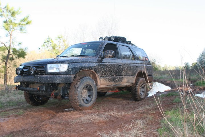

Dous' original build had no bottom part.
Didn't really pull the same look as the 96-98 bumpers
^^^My first time seeing it done with the 99-02 models^^^

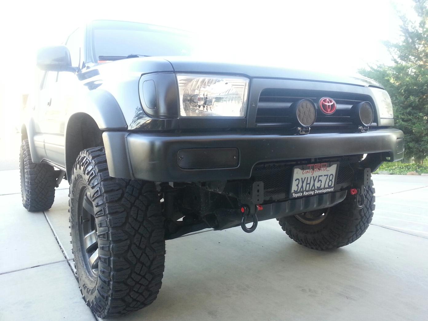

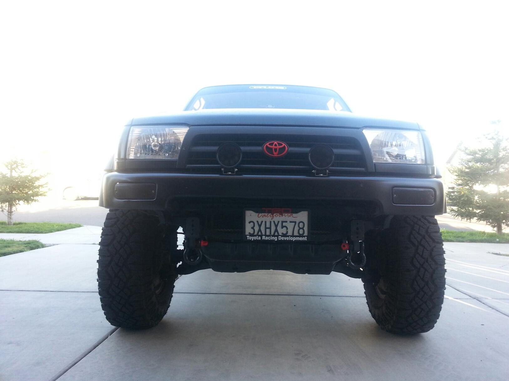

anyway here's mine- :hatsoff:

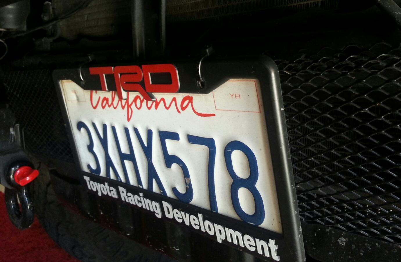

How'd you mount your front plate? And do you have any type of body lift on that? I don't remember my bumper being able to see that much when I didn't have my valance on. I think I might take the valance back off o.o I like how yours looks...
Hey thanks-
I mounted my plate using zip-ties over some steel mesh aka= gutter guards from Home Depot, which is only like $3. Try it out if you don't like it, you could always put the valance back. Question though? Do you have Limited fender flares? Because I had to cut mine to make it look good and flow right...
I'm not using any body lift of any sort- Just a 3" suspension lift (1st page of my build)
*post up a pic here if you decide to do it :photo:
