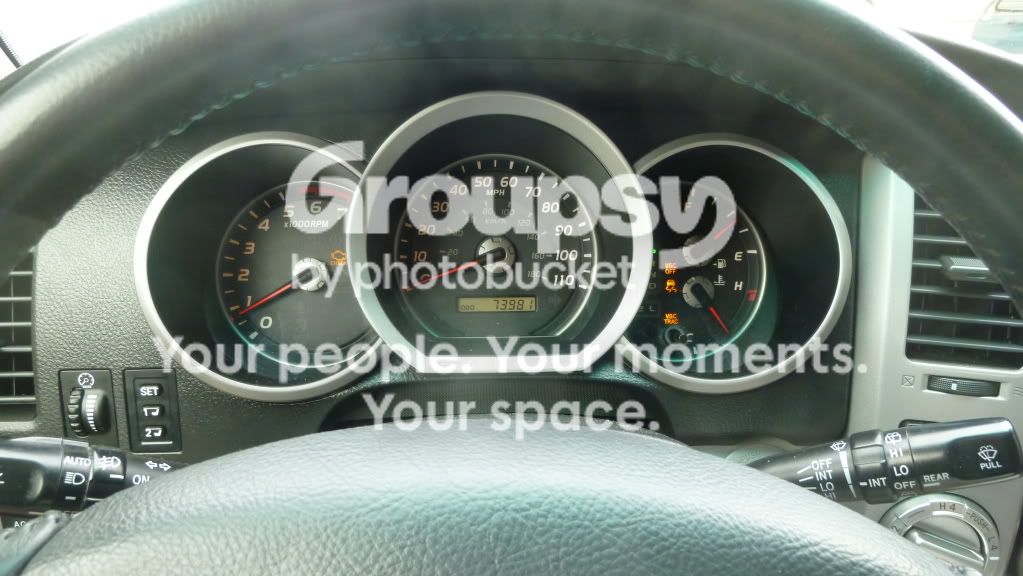

We have a 2007 v8 with 51k miles. Today at start up, the cel, vsc, traction control lights on and did not go off. everything was fine last night when it was parked in the garage. We turned it off and restarted it and all the lights came back on. Any ideas?
