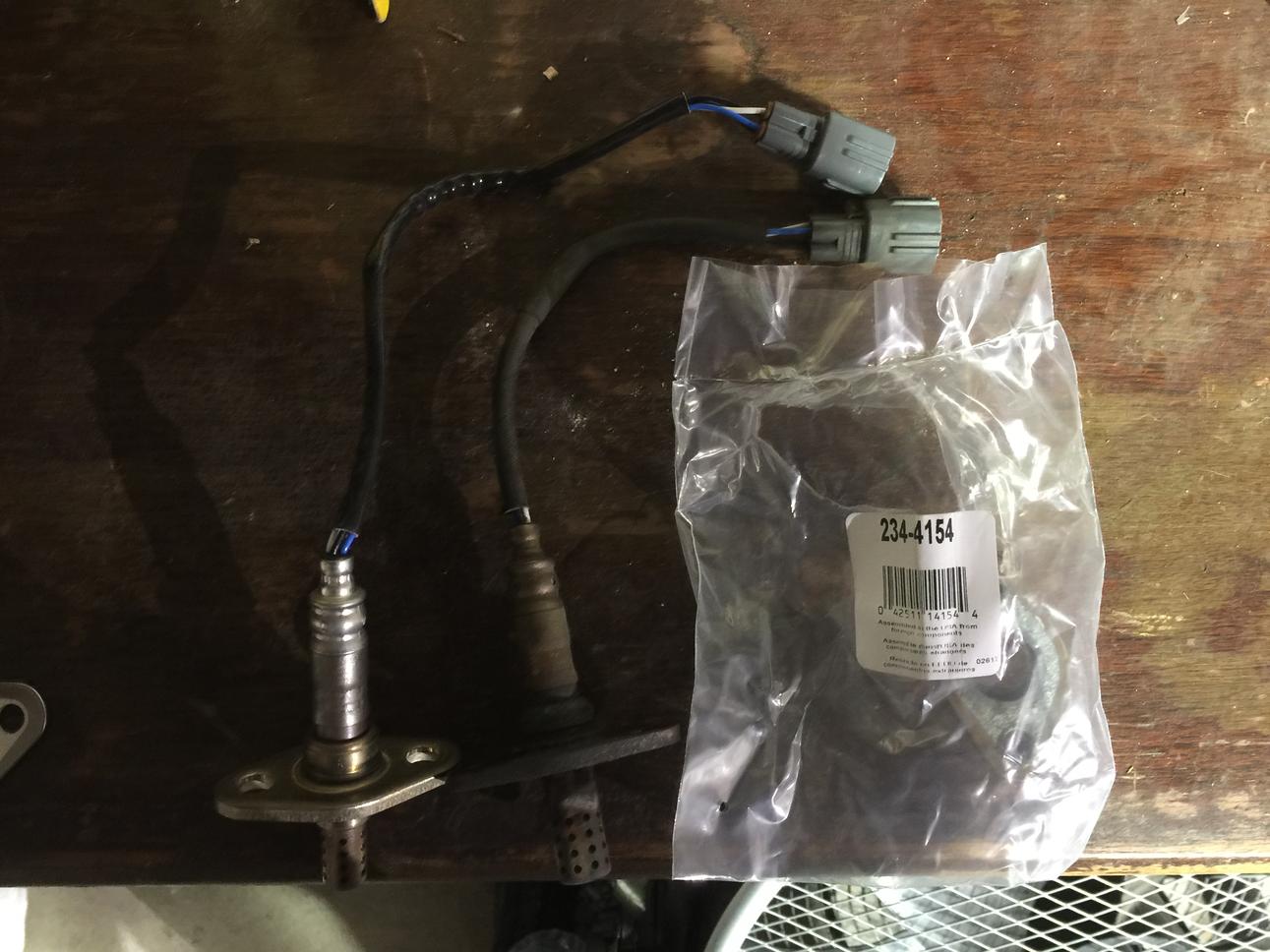

Today I put the new rear O2 sensor in as first step to get rid of my P0420 code.
The sensor I bought has a longer pigtail than what's there. I just looped the excess cable and zip tied it.
