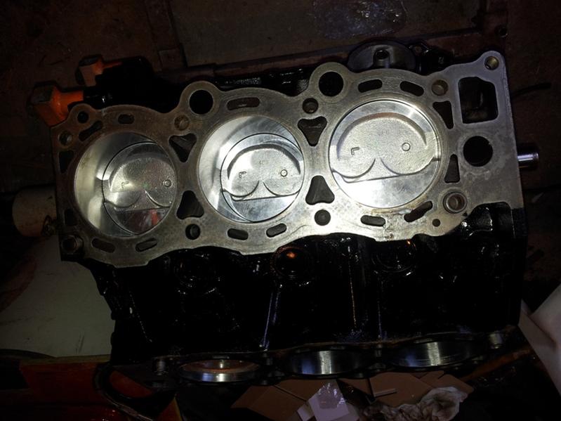

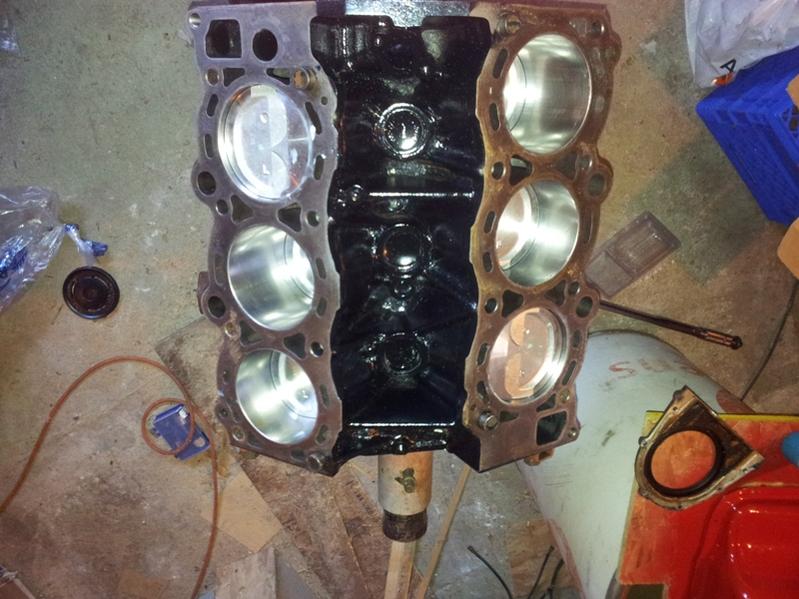

The second bank of pistons installed.

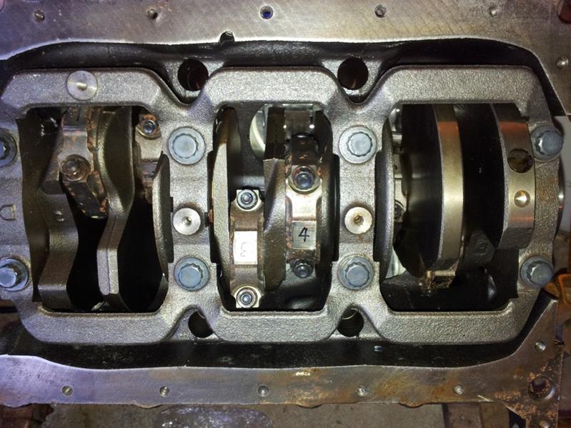

The view from the bottom of the motor. All connecting rods get torqued to 18 ft. lbs. then an additional 90 degree turn.
The view from the top of the engine.

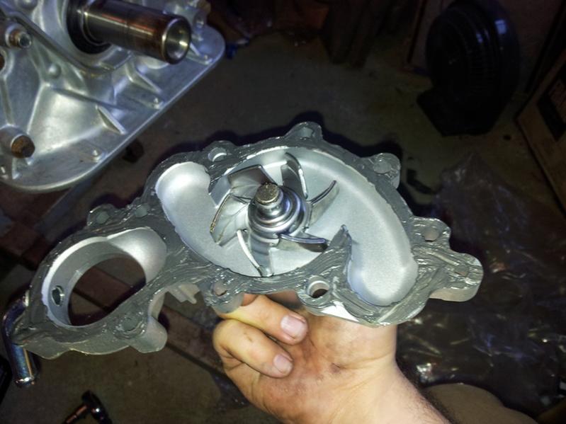

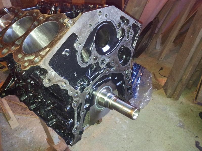

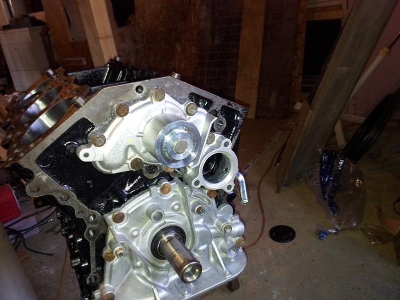

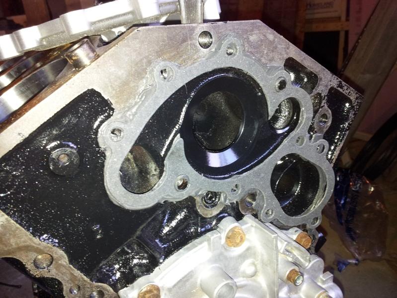

Prepping the surface for installing the oil pump and the water pump. I ended up scraping off the paint that I had painted on the block where the gasket mating surfaces are. An easier way is to keep your old water pump and oil pump (if you replace them) in place until after you paint the block.

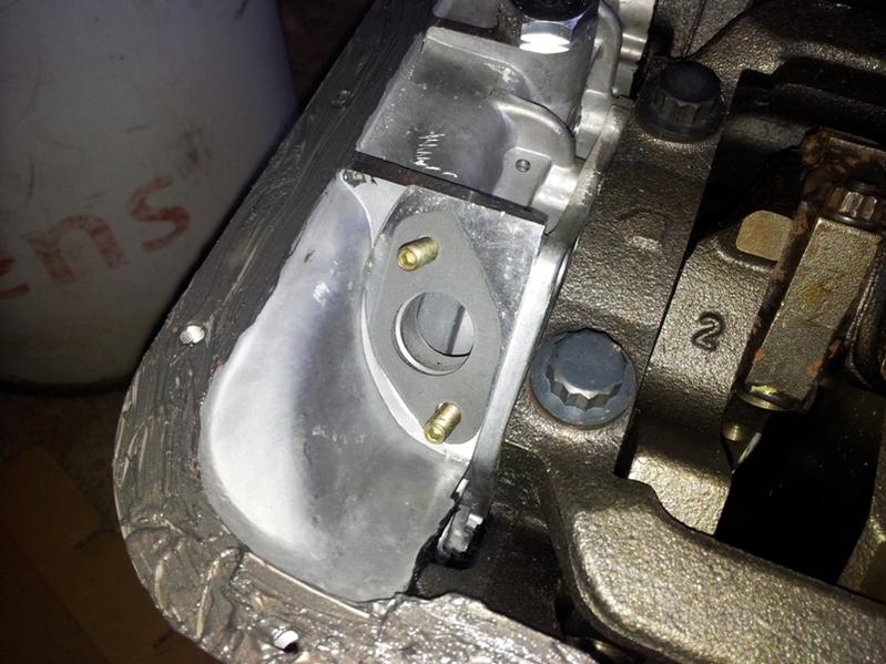

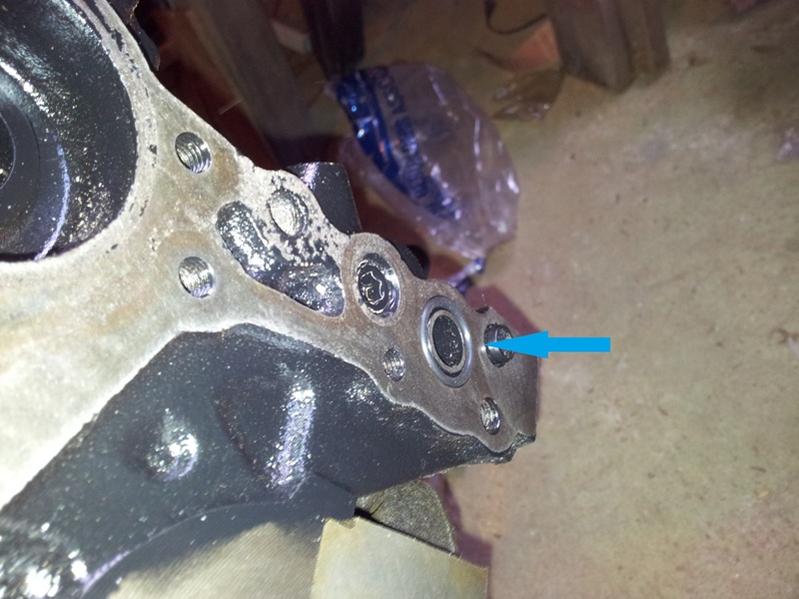

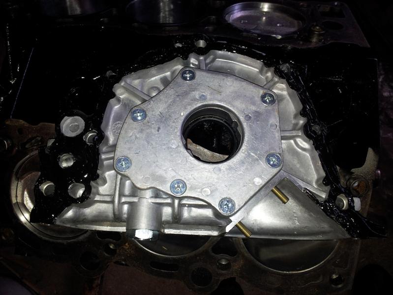

Be sure to have this O-Ring in place before installing the oil pump or it's going to leak.
I usually dab the gasket sealer on and then spread it around like cake frosting. This ensures that you cover all the surfaces and also leaves less extra material which can ooze out when you tighten things down and get into your oil, coolant, etc.

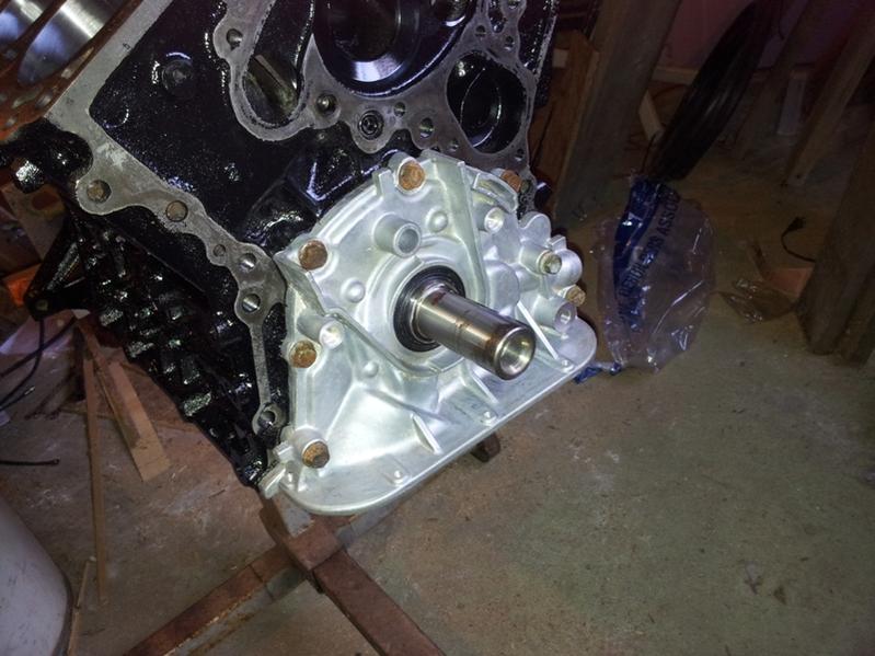

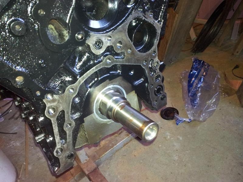

The oil pump installed. BE SURE to apply assembly lube to the crankshaft where the oil seal sits or it will not seat properly.

Apply gasket sealer to the block and then position the gasket on the block.
Apply gasket sealer to the water pump and then position the water pump on the block.
The oil pump and water pump installed.

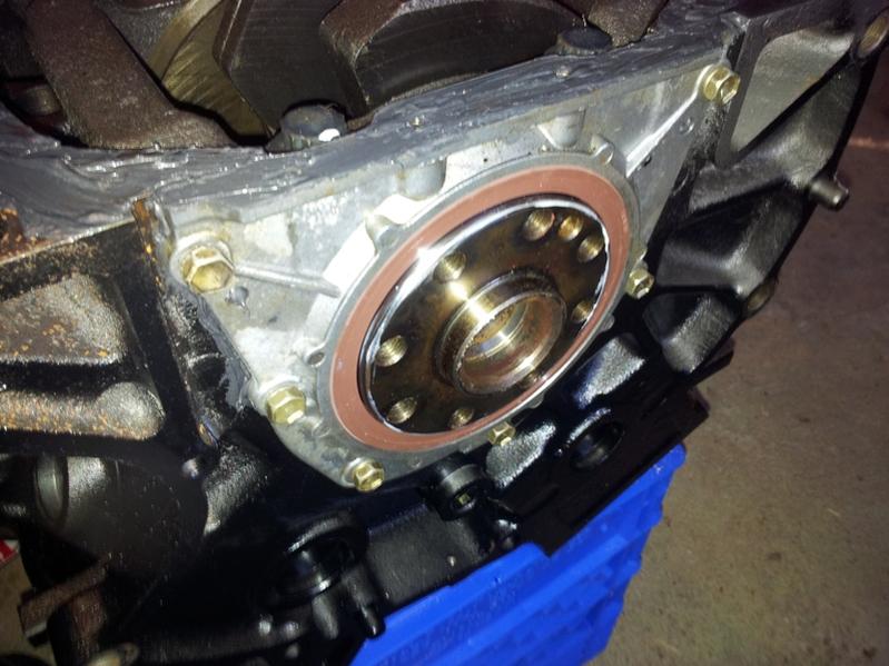

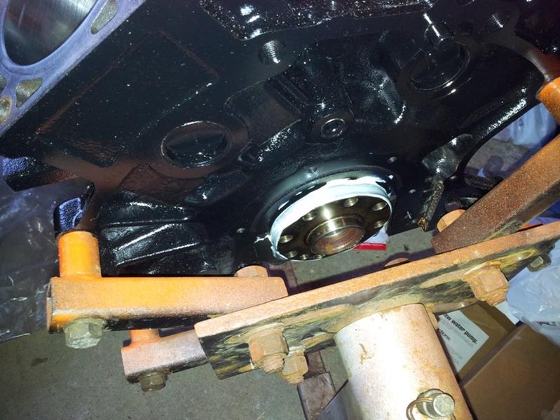

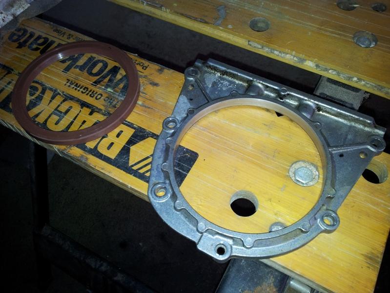

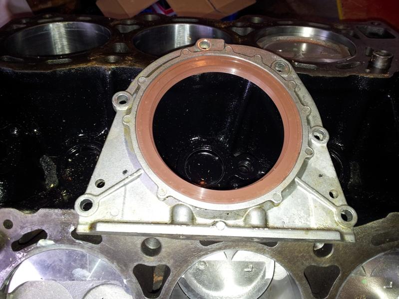

The rear seal and retainer plate.
The rear seal installed. Be sure to use care when installing crank and cam seals. If you damage or distort them, they will leak.
Lube up the crank where the seal sits. The rear seal plate also has a gasket which is installed the same as the water pump gasket.
The rear seal installed. The book calls for 69 in. lbs. which is equal to about 7 ft. lbs. I simply hand tightened these because my torque wrench only goes down to ten. Don't overtighten these small bolts or you'll snap them off.

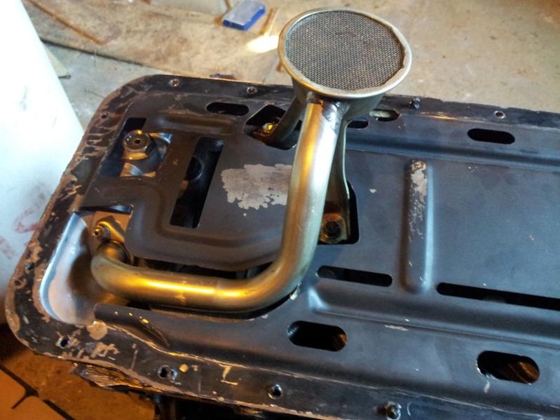

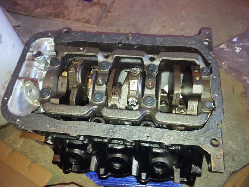

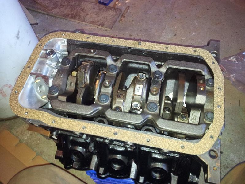

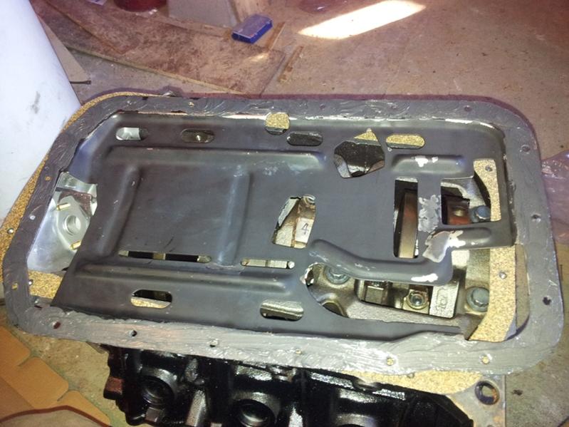

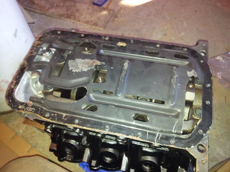

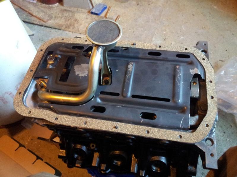

Install the oil pickup tube gasket. DO NOT use gasket sealer here!
Apply gasket sealer
Position ONE of the two cork oil pan gaskets.
Apply gasket sealer to the "underside" of the windage tray.
Position the windage tray in place.
Install the pickup tube AFTER the windage tray. Now you can see how big of a PITA this is to do when the engine is in the truck...

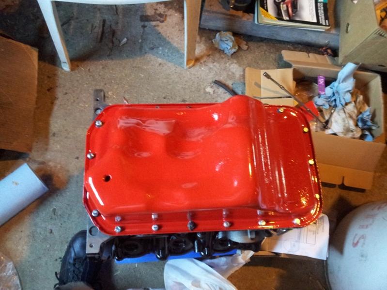

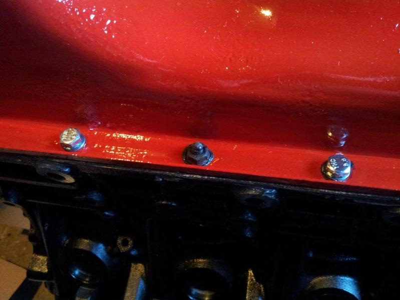

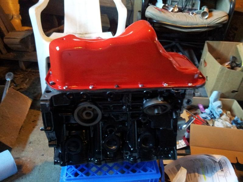

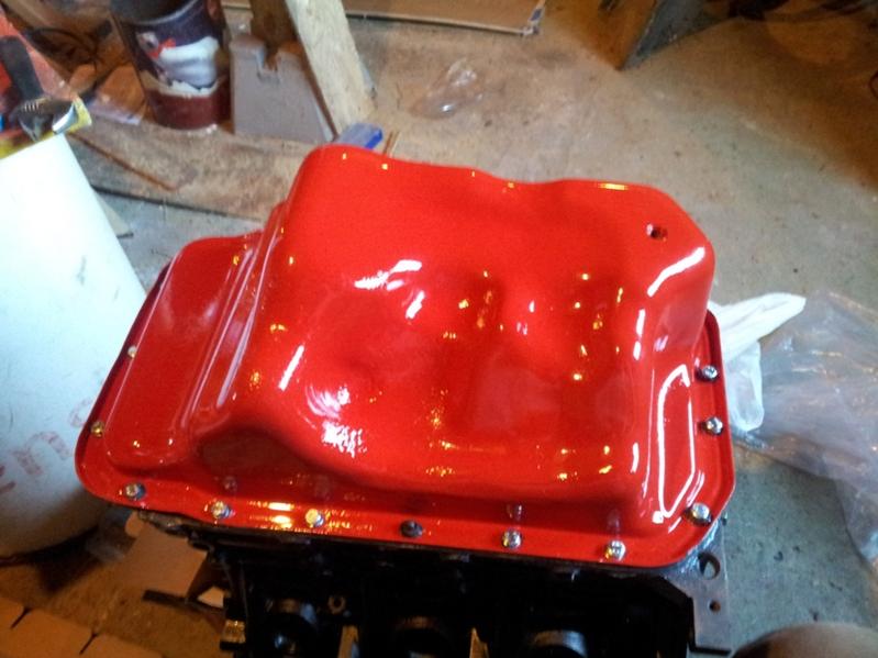

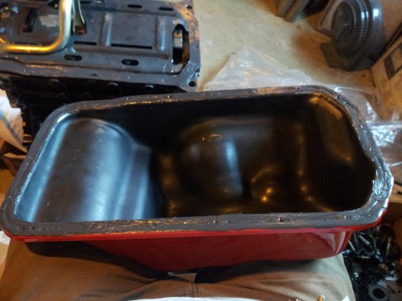

Apply gasket sealer to the oil pan
Apply gasket sealer to the windage tray and then position the second cork gasket.
The oil pan installed. If you choose to use the cork gaskets in the set, you WILL have to buy longer oil pan bolts. Also, the two nuts that go on the positioning studs will have to go on after you snug the pan down. You can cheat and buy the Permatex 1 Minute Gasket Maker instead of the cork gaskets, but you have to work fast! As in five minutes fast!
Again, I hand tightened these bolts and you start in the middle and work your way out. Snug all the bolts first, then make a second pass and tighten them all up.

well there's two things I totally forgot to do... no gasket for the pickup tube and I didnt reseal the rear main plate. no wonder it weeps.
