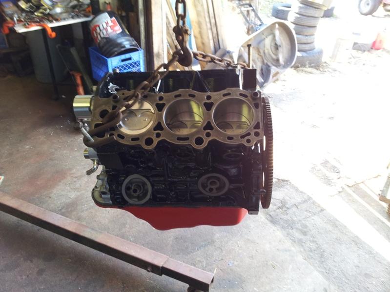

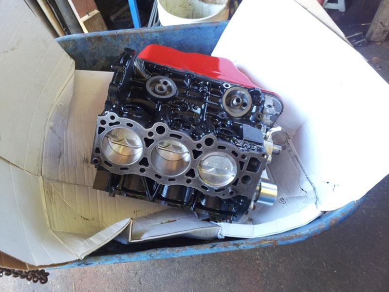

My 3 point slow rebuild
Out of the basement and into the garage!

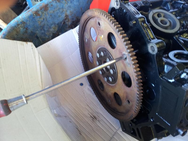

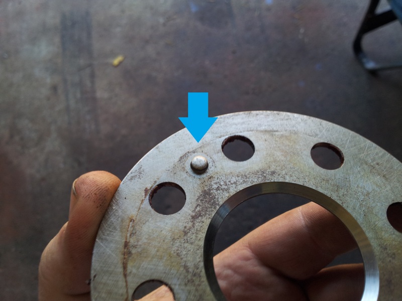

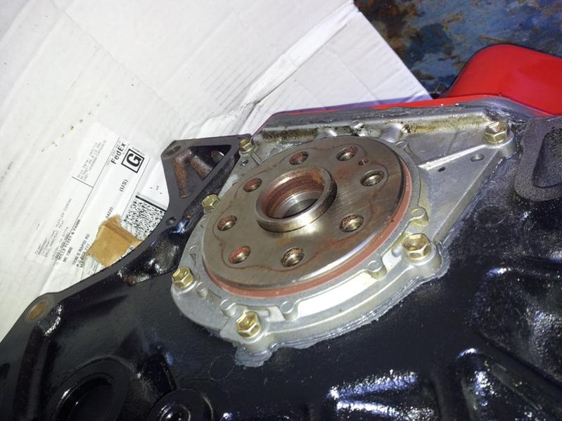

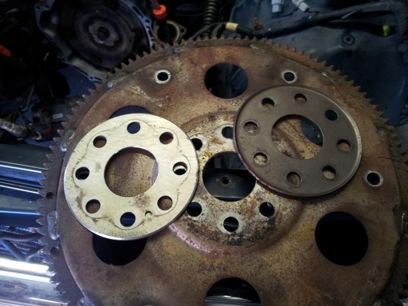

There are two spacers that install with the flywheel. The one on the left goes behind the flywheel (crankshaft side) and the right one goes on in front of the flywheel.
This alignment pin matches up with the crank.
Before the spacer...
After the spacer...

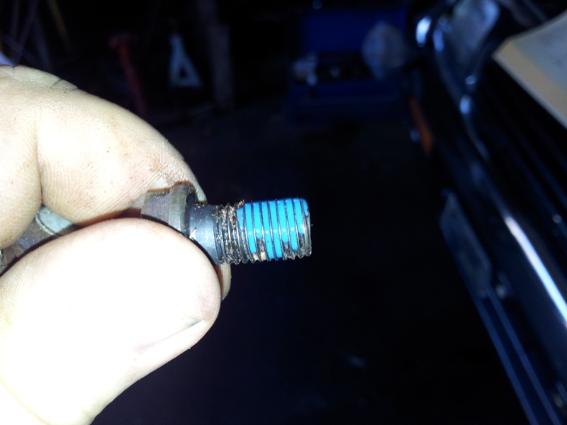

Be sure to use threadlocker on these bolts. You DO NOT want these babies coming loose!
Use a large screw driver to hold the flywheel in place while you torque the bolts down. The flywheel bolts torque to 61 ft. lbs.

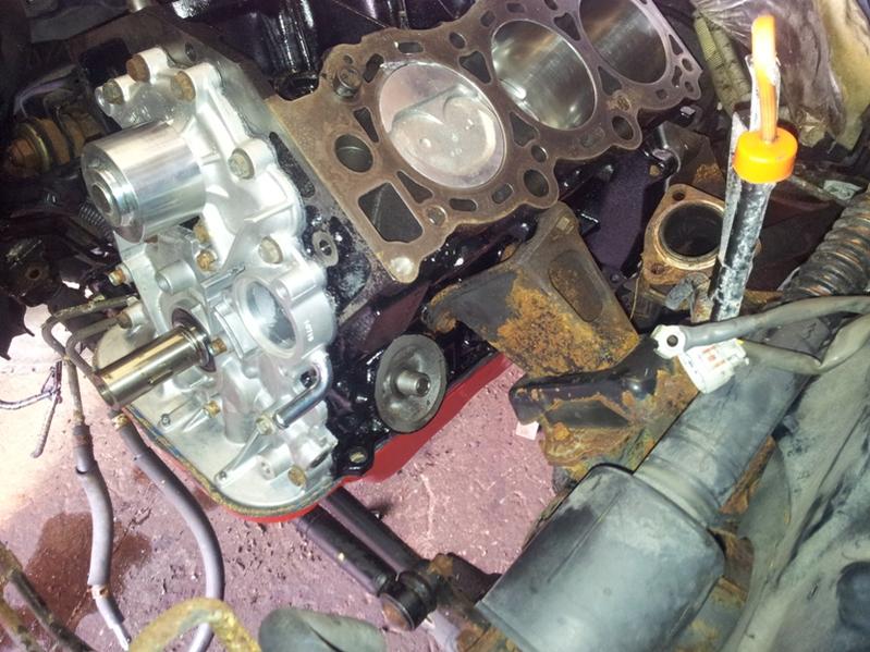

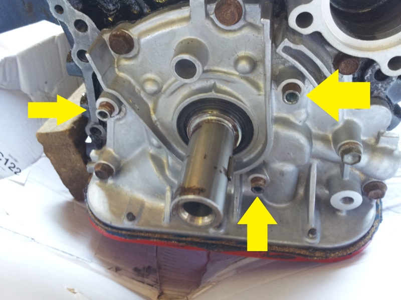

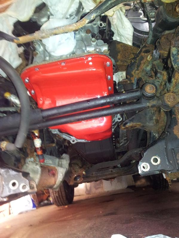

ATTENTION!!! If you replace your oil pump, verify it comes with these spacers. Otherwise, you'll have to rob them off your old oil pump. I found this out as I was getting ready to toss the old oil pump into the scrap pile.

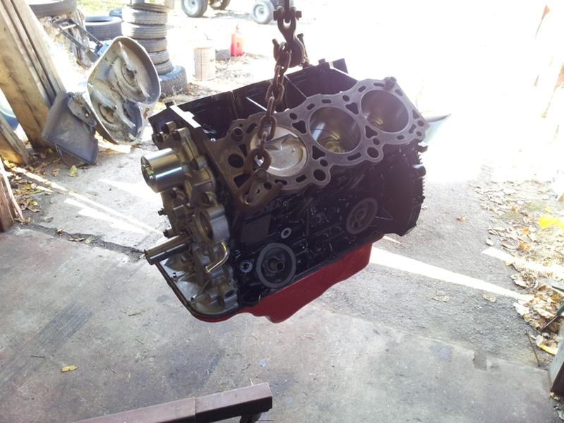

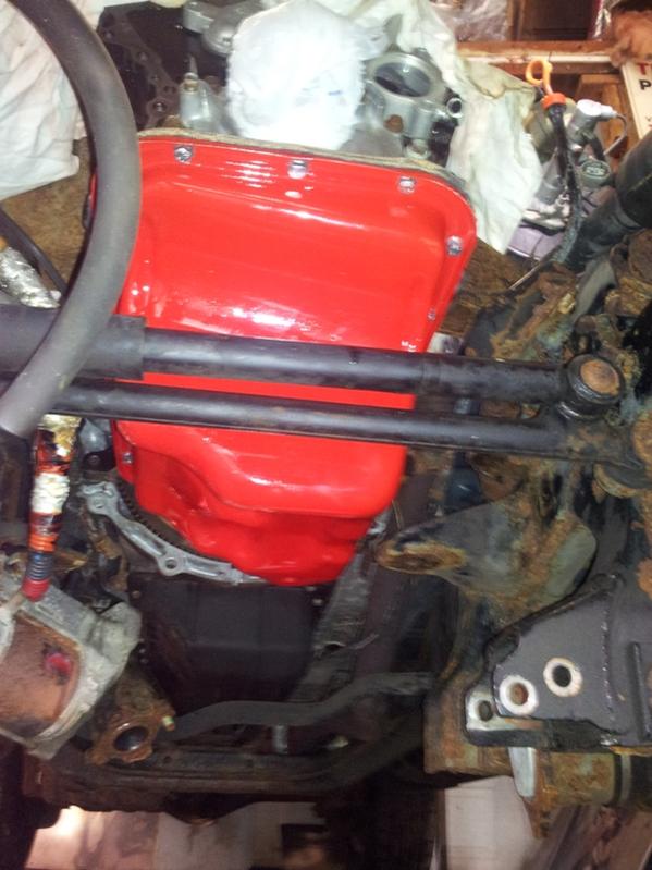

Up in the air! My intent at this point was to install the oil cooler.....not a single parts store carrys the seals for it. I know it leaks. Being Sunday, the dealership was closed. Looks like I'm doing it later!

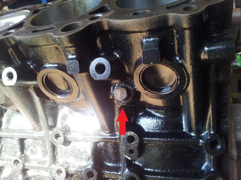

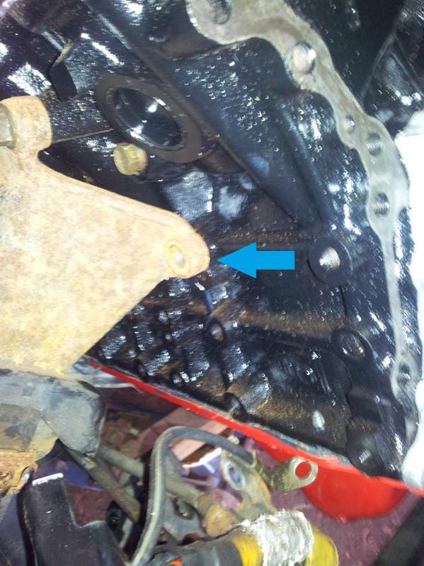

Don't forget to install the coolant drain plug on the passenger side...

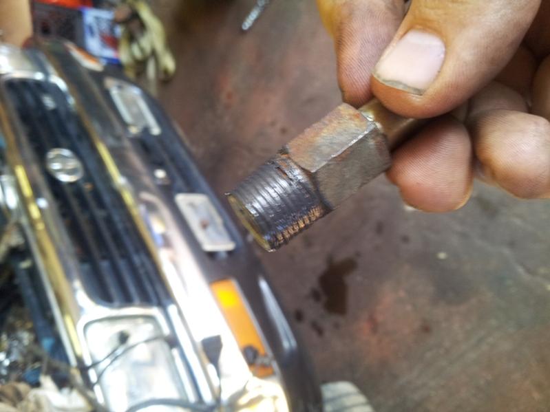

And the oil coolant outlet on the other side... You can use teflon tape or gasket sealer for this part. I couldn't find the teflon tape, so Ultra Black it is!

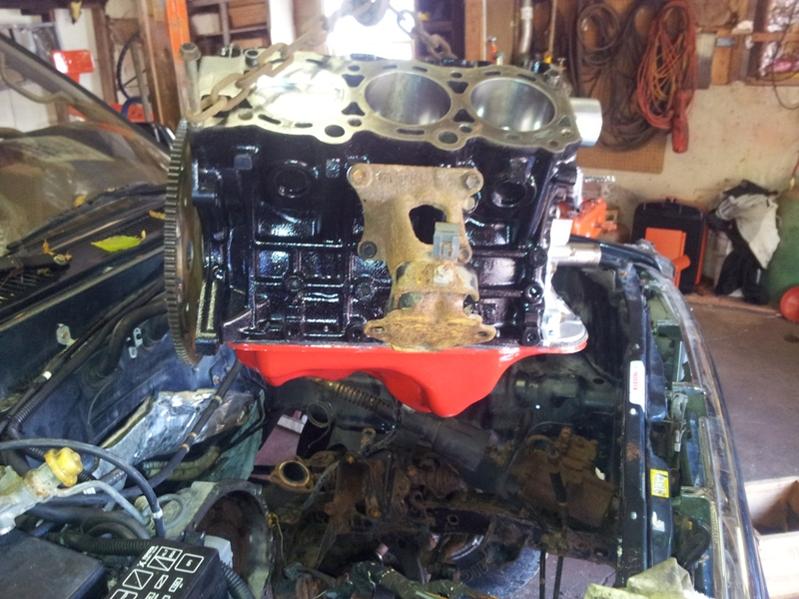

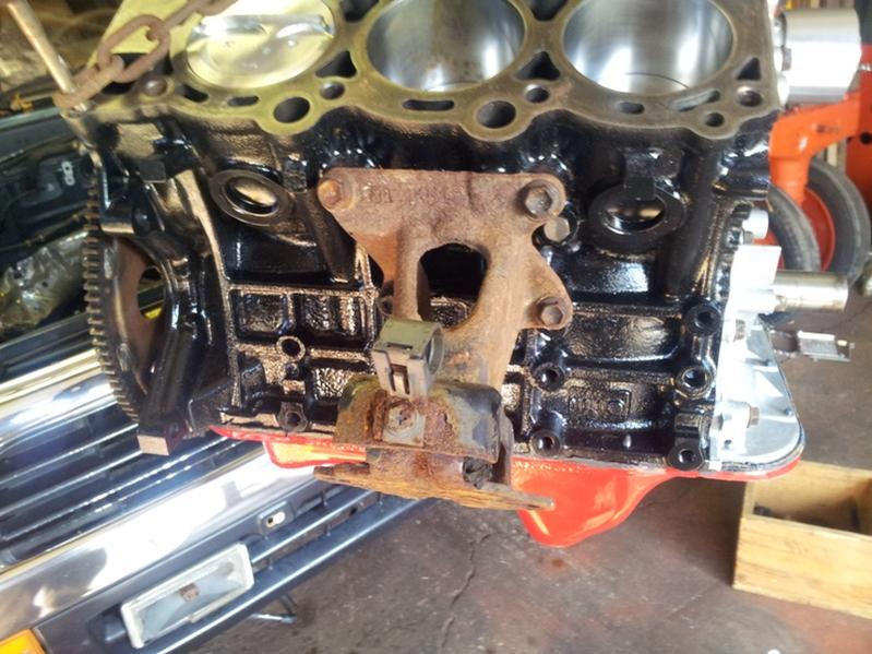

The passenger side motor mount installed. The other one is in the truck. My dad pulled the block and said it was easier this way...I'm not seeing it... :lmao:

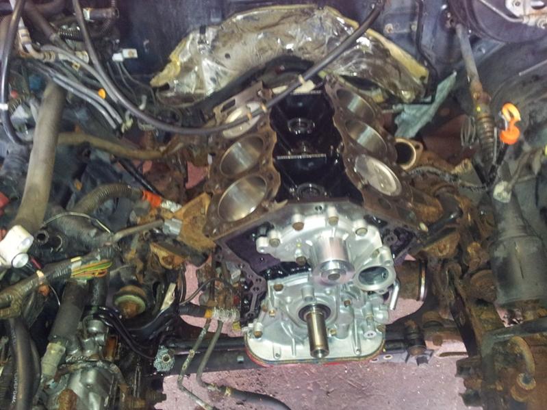

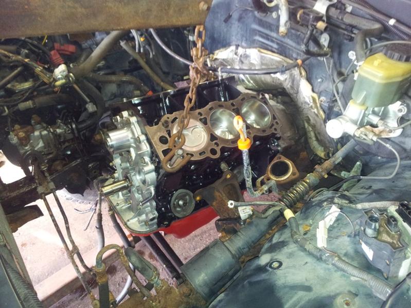

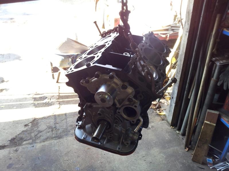

Now...I did decide to install the heads after the block is in. I wanted to be able to have room to work around the block. I have a good plan for getting the heads and exhaust installed, so it shouldn't be a problem.
Getting her lined up.
Bolted in!!!
You'll have to remove this bolt as it goes in the other side. The AC compressor bracket attaches here...
Too bad most of this "niceness" will be covered by a bunch of crap. :cool:

passenger mount sucks to bolt down without a body lift.

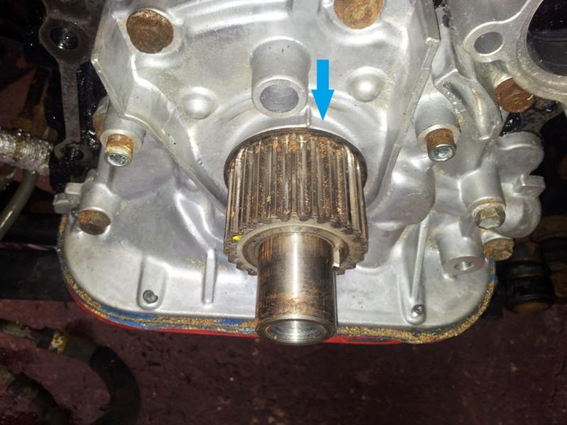

The crank timing gear installed. Note the position of the lip.

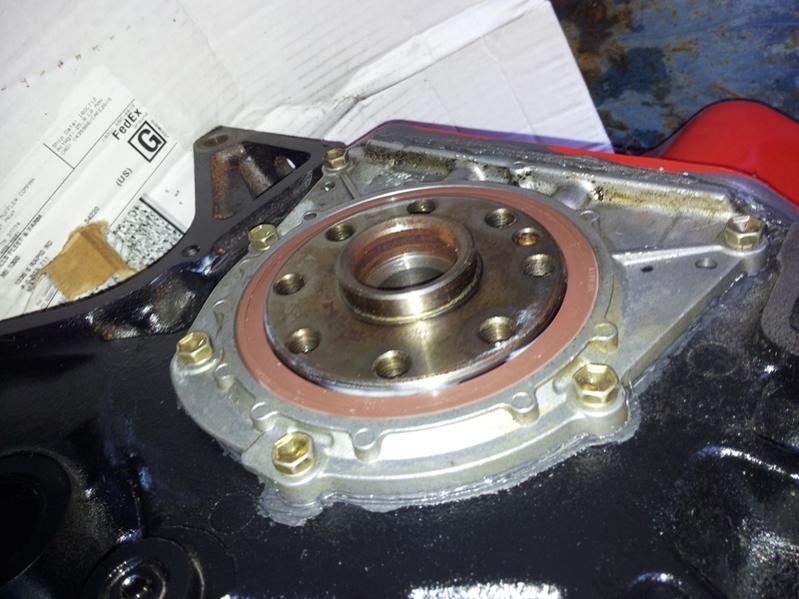

well there's two things I totally forgot to do... no gasket for the pickup tube and I didnt reseal the rear main plate. no wonder it weeps.
