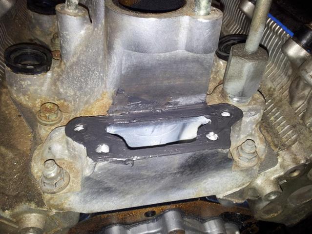

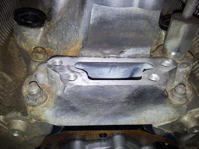

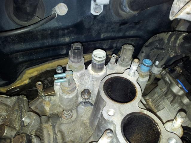

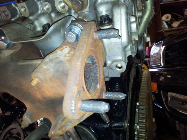

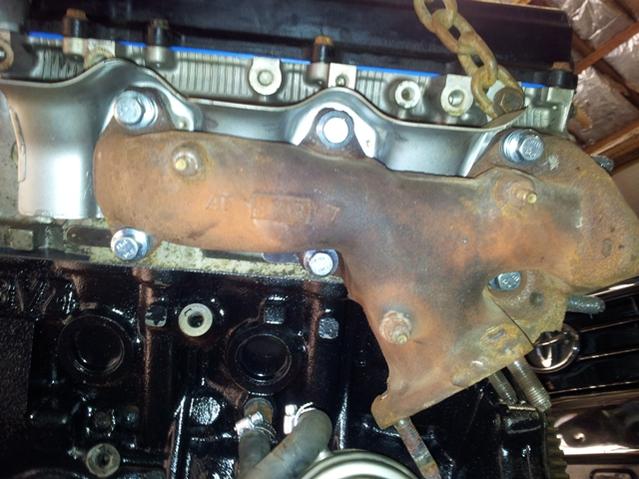

Here's a view of the backside of the engine with the infamous setback now installed. One 10mm bolt holds the plate in place. Its located near the starter opening.

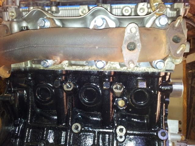

I fought pretty hard with the manifolds the first time and feared I cross-threaded a bolt. So, while the engine was out, I pulled the manifolds. I did one find one hole that was a little messed up, but I ran a tap through it and it was fine. I also ran a tap through all the other holes. I then used some industrial anti-seize (good to 2500 degrees F) and reinstalled the manifolds. I now have better piece of mind.
I also put anti-seize on the crossover studs. Exhaust bolts are usually the first to rust and the first to snap, so I'm taking precautions for the future.

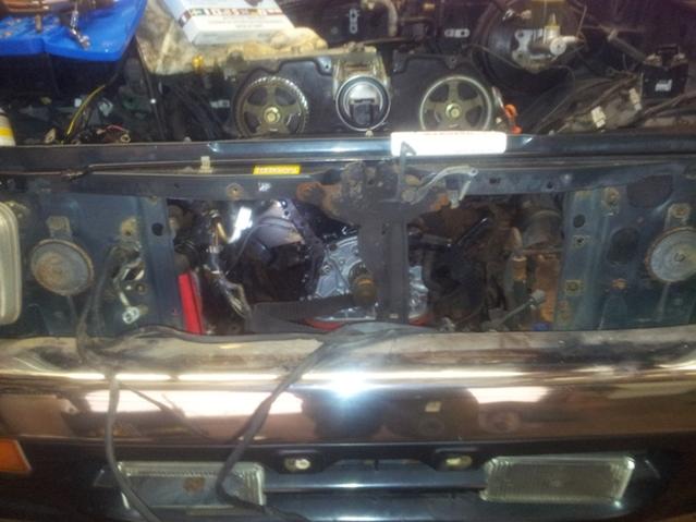

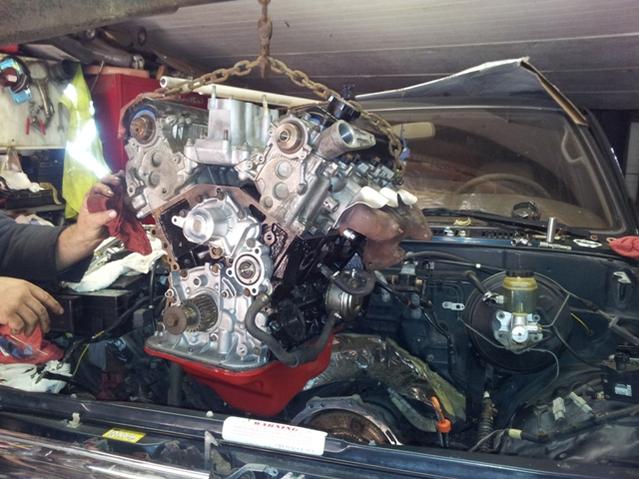

The engine going back into the bay. A sigh of relief...
I didn't get a lot done this weekend. But, the worst is behind me. (knocks on wood) I ended up helping my dad with his tractor restoration and then going with him on a few calls. (tow truck driving). But now I'm ready for next weekend!

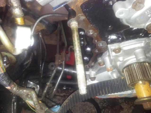

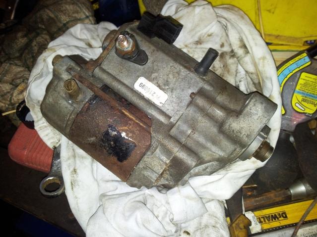

Starter Install
Well, it's been a while. Time for an update

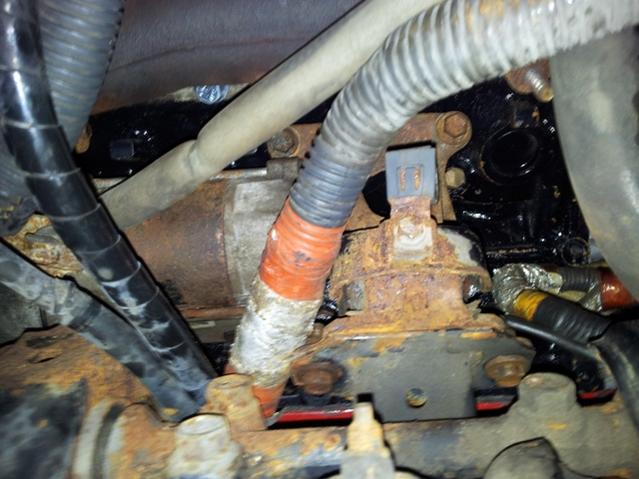

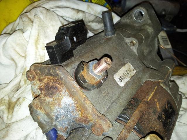

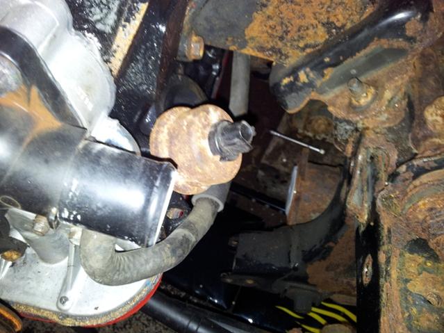

I cleaned up the starter lead terminal and the terminal end on the positive wire.

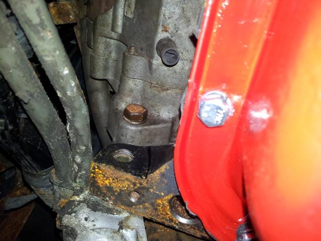

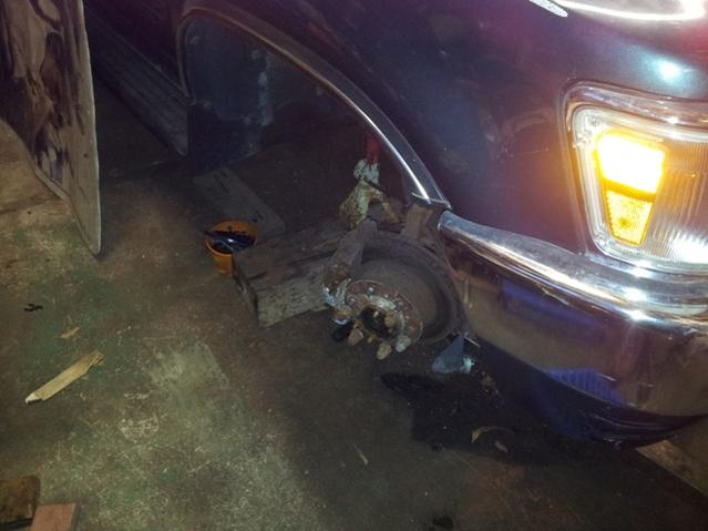

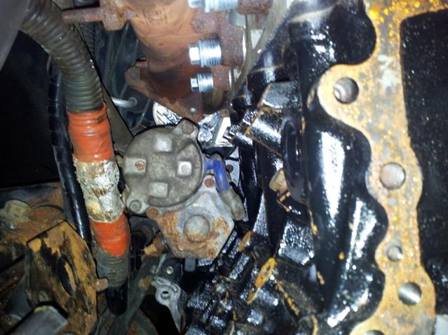

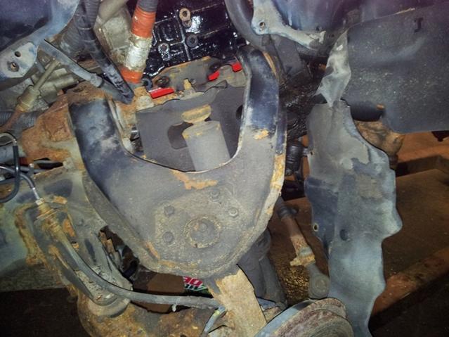

To install the starter, first remove the passenger wheel.
Then remove the access panel above the upper control arm. Some are held in with 10mm nuts, some are held in with snap fasteners.

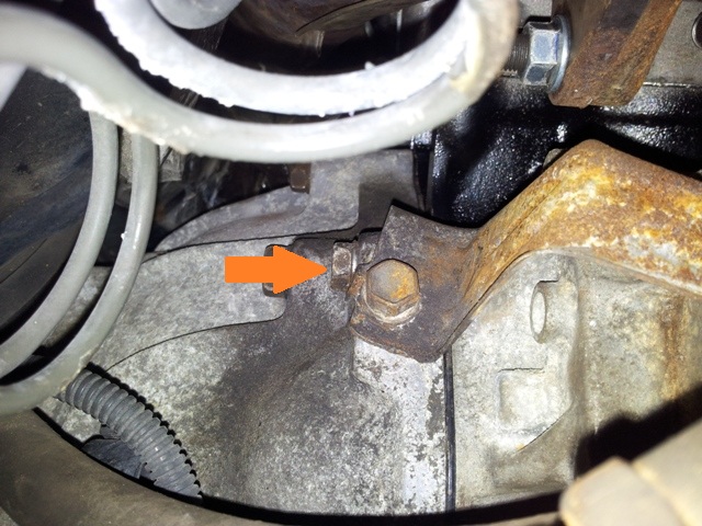

Remove the passenger motor mount. The mount CAN be unbolted and removed through the passenger wheel well, but I removed mine from the front since I had the open space.
To give you relative perspective of why the motor mount has to be removed.
The top bolt goes through the bell housing into the starter.
The bottom bolt goes through the starter into the bell housing. If you have the front axle in or lack space, several long extensions can be used to reach "down the tunnel" to the bolt.

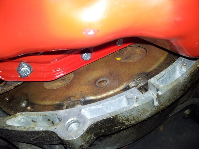

Torque Converter
Here is a view from the wheel well with the motor mount re-installed.

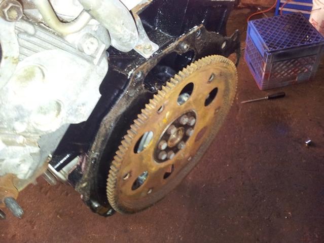

Next, I worked on bolting the flexplate to the torque converter. Thread in the crankshaft bolt and use a ratchet to turn the engine to line up the bolt holes.
A close up of the flex plate lined up. There are six bolts total. Install one bolt finger tight and then rotate the engine to install the remaining ones. Then go back around a second time to torque them down. Be sure to use thread locker on the bolt threads as well.

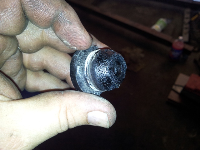

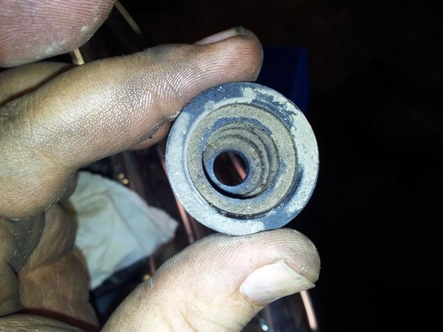

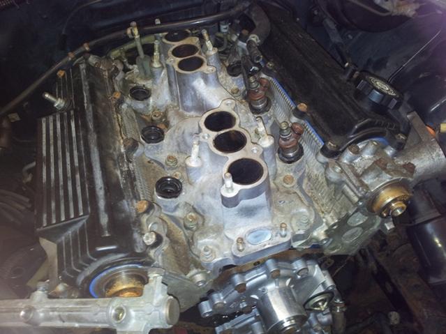

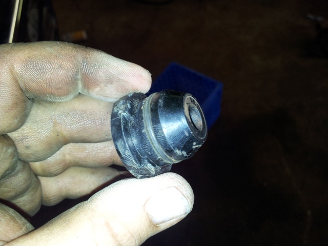

I decided to work on getting the fuel injectors and fuel rails installed. I didn't like how dirty the injector seats were, so I decided to pull and clean them. Good thing I did...
Couple of pictures of a cleaned injector seat. Much happier now that I know I'll have a good seal and no dirt getting into the injectors or the engine.
Unfortunately, my injector portion came to a halt when I realized that I was missing a lower injector seat. Luckily, I found an injector rebuild kit on Ebay that has all the seals.

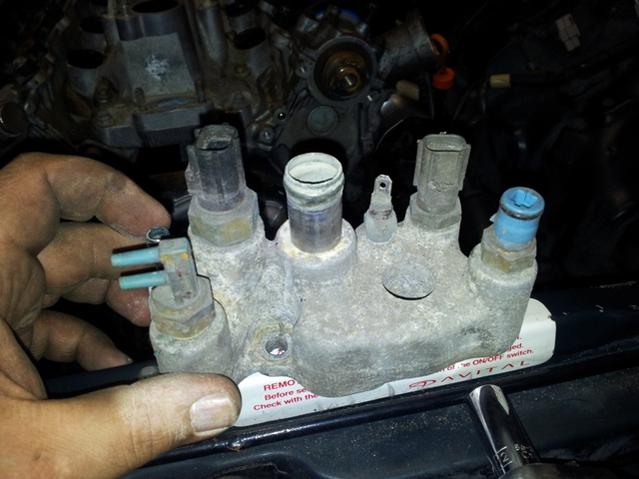

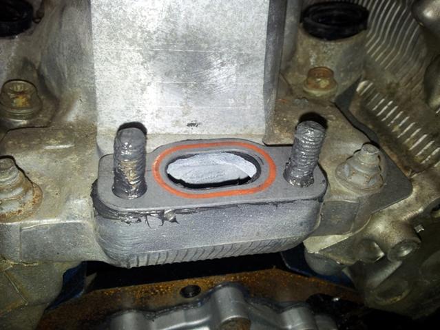

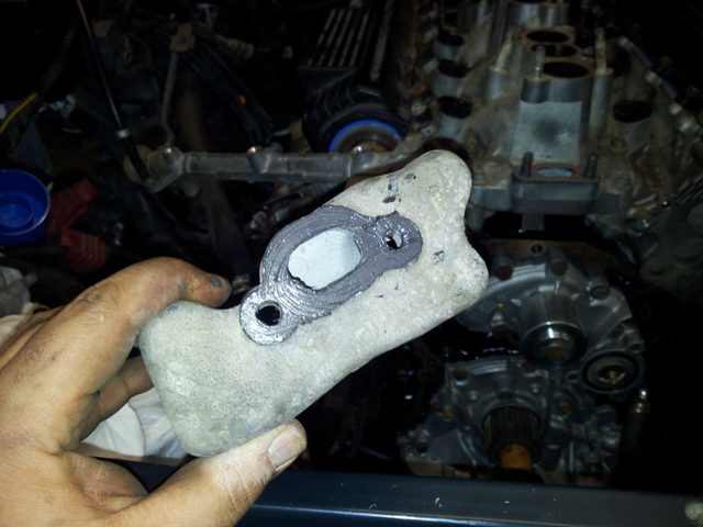

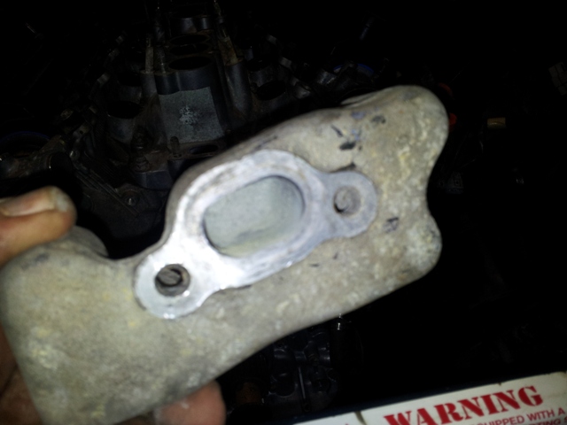

Intake

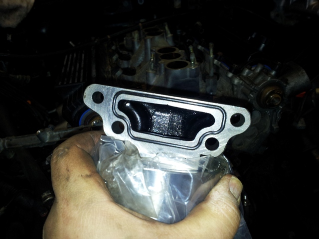

Well, I decided to install the coolant manifold and the front idler/coolant pipe on the intake.
Cleaned up the surface.
Now...take a look at the picture above and the picture below.... See the problem...I put the intake manifold on backwards!
Well, good a place as any to prep the mount. Cleaned it up, put gasket sealer on the base and anti-sieze on the bolts
Well, turned the intake around and got the manifold bolted down.

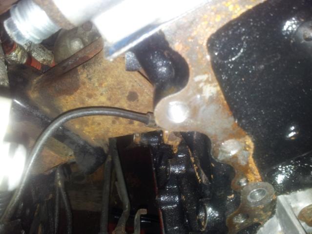

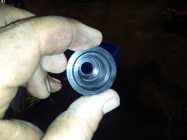

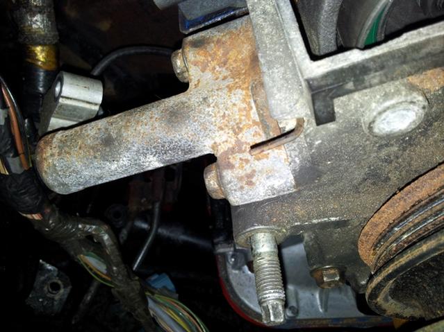

Prepped the front base for the idler pulley
Applied gasket sealer
I know there's a rubber o-ring installed on the pully, but I didn't want to take any chances.

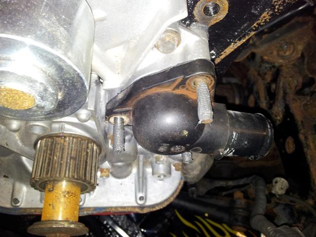

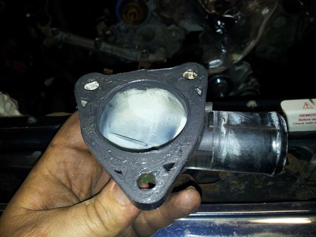

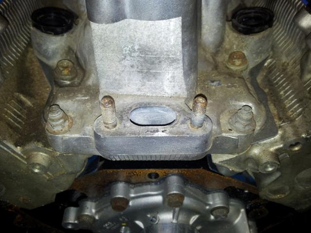

The water neck studs installed. I used anti-sieze on these as well.
Gasket maker applied to the water neck.
The water neck seated and more anti-sieze on the stud ends.

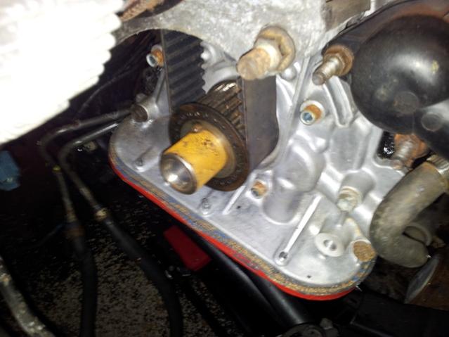

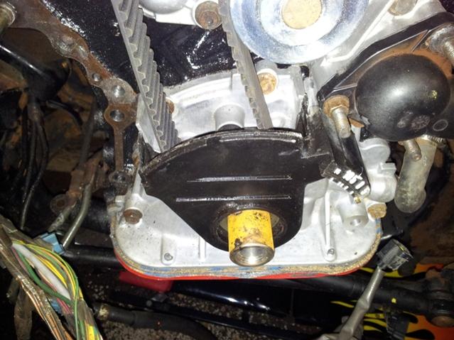

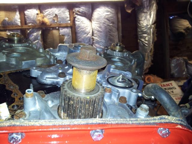

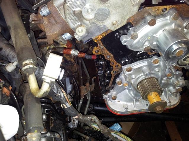

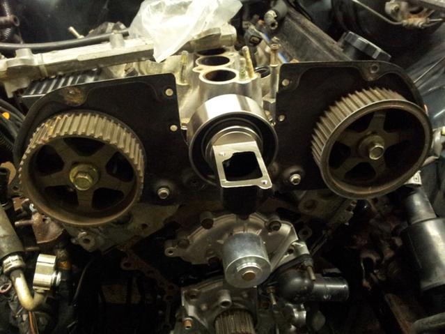

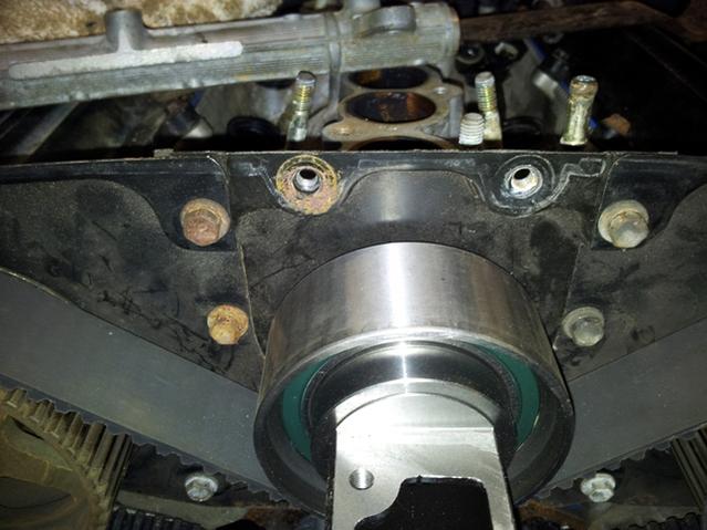

The idler pulley is installed and the rear timing cover is bolted on.

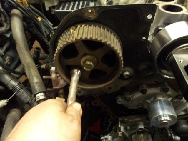

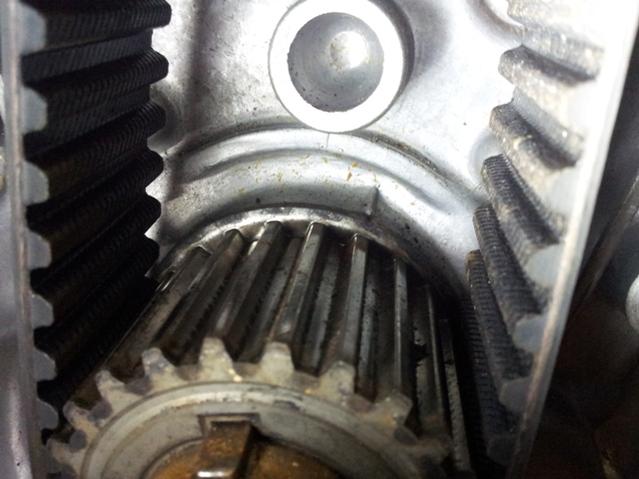

Here's a neat trick. To hold the timing gears in place while torqueing them down, use the female end of a 1/2" extension over the timing cover bolt.
The cam gears installed. Pay attention to the orientation. The flange on the driver side gear faces outward.

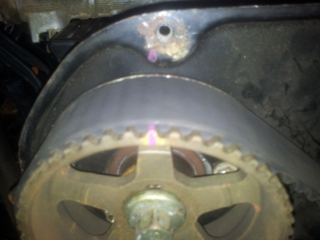

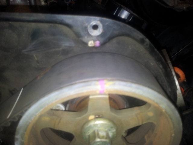

Be sure to line up the timing marks before installing the timing belt.

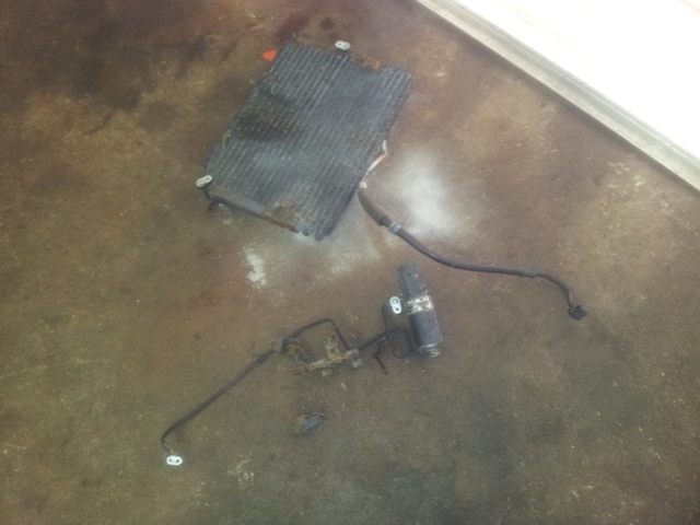

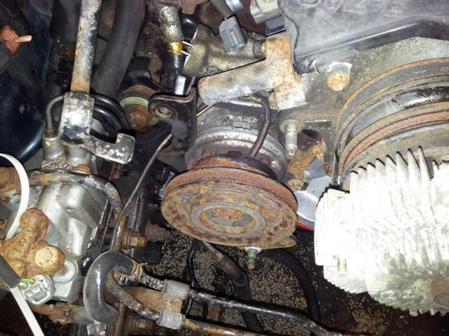

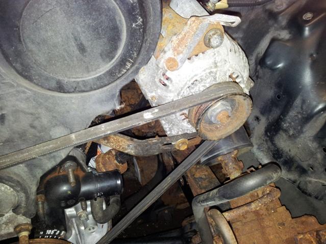

I got fustrated and didn't plan on using the A/C anyways, so I did some cleaning. In reality, I didn't have enough space to get a drill at the hole decently.
Much better. I am going to keep the A/C condensor fan and reinstall it later with an relay kit and sensor. The cooler I can keep the motor, the longer it will last.

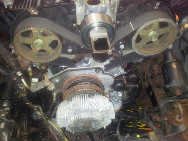

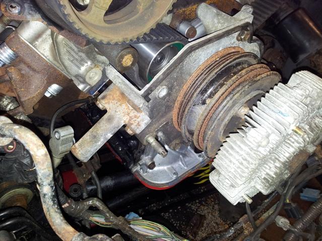

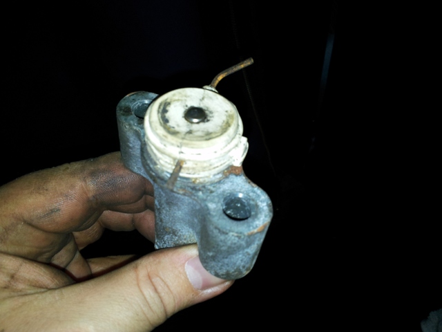

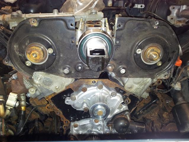

If you re-use the original tensioner, use a very small allen wrench or stiff wire to hold the plunger in while you install the tensioner. I used a bench vise to compress the plunger.
The tensioner installed with the allen wrench still in place. Once installed, remove the allen wrench with a pliers.
After the belt is installed, install the lower timing cover.

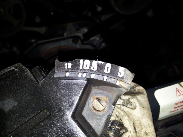

I used a paint marker on the timing marks to make them easier to see later.
Don't forget to install the timing belt guide before the cover.

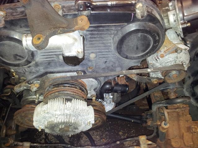

The timing belt installed along with the fan bracket.
And this is where I realized my lens was dirty and cleaned it. Another view showing the tensioner installed.

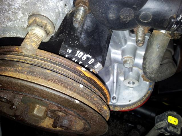

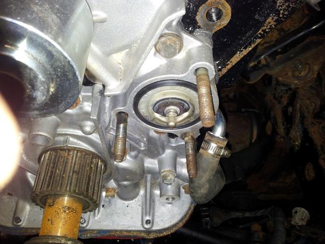

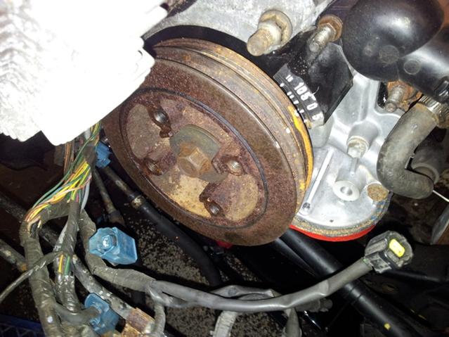

The harmonic balancer pulley installed.
A close up of the timing marks.
The oil pressure sending unit installed.

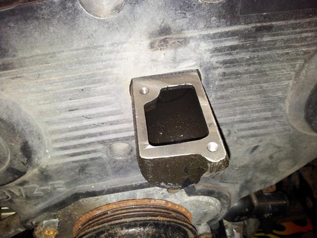

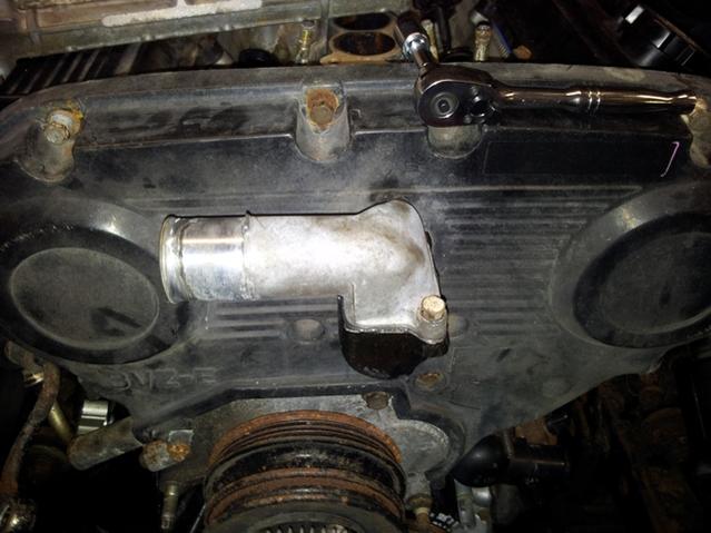

The remainder of the timing cover was installed including the front cover and this piece.

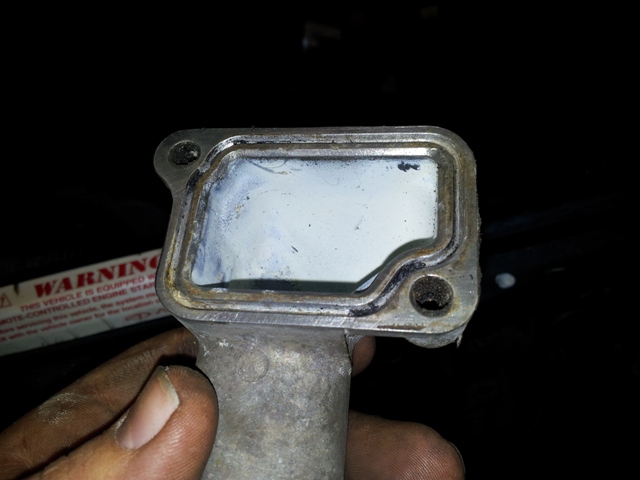

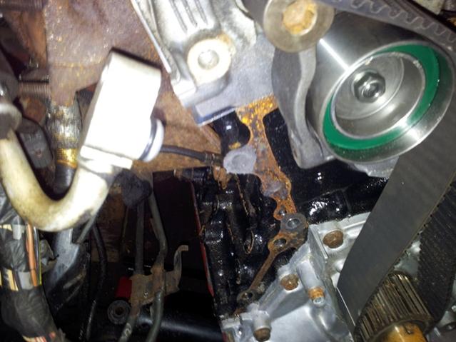

Cleaned up the upper coolant inlet. There isn't a gasket for this piece. Use gasket sealer and be sure to fill in the channel.
The mating surface

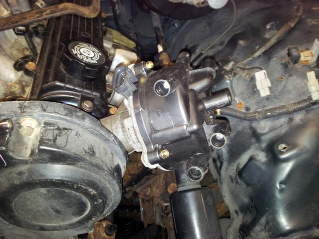

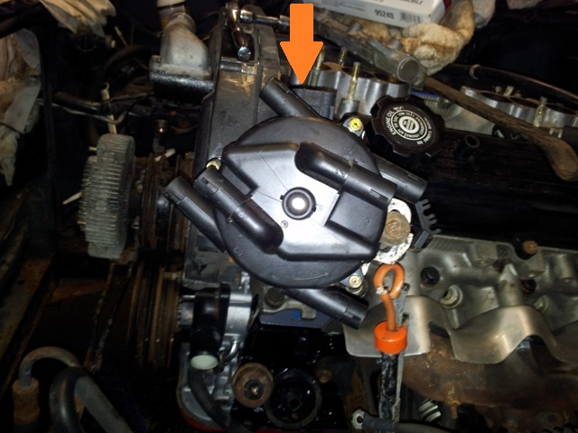

The distributor installed.
When installing the distributor, set the engine at #1 TDC. The rotor on the distributor should be in this area when the distributor is installed.

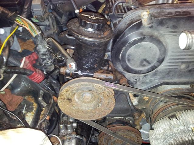

The power steering pump installed.

I had already picked up new upper seals. But I lost one of the lower ones and I wasn't going to pay $8 a piece to rebuild the injectors when I got the whole kit on Ebay for $35.

Smart.. I should have done that with the timing marks. Looks like the distributor is advanced more than it should be but you kind of need it running first lol. At least I think its too advanced... I wouldn't know, my tps doesnt work right so i cant set the timing.
