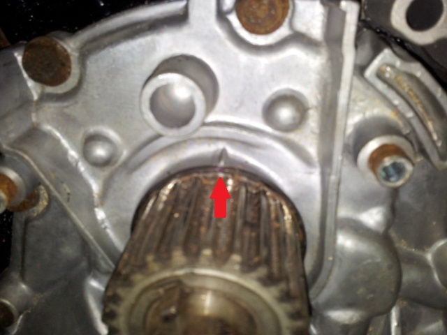

oh and make sure you know which timing mark on the crank is actually the timing mark. I ended up 180 out.
According to both my chilton and haynes manuals, it's the little notch on the rear lip of the timing belt gear. I set it at TDC before I put the heads on.

yup that's the mark. on my crank gear there was a nice machined dot on the front exactly 180* off.

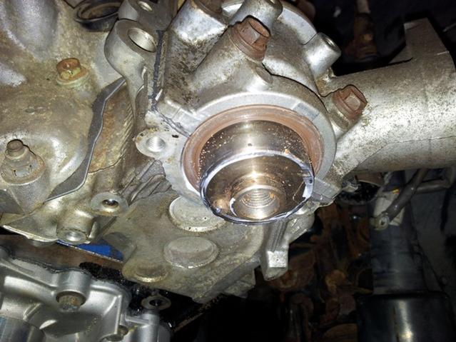

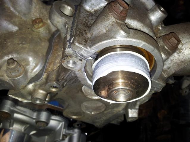

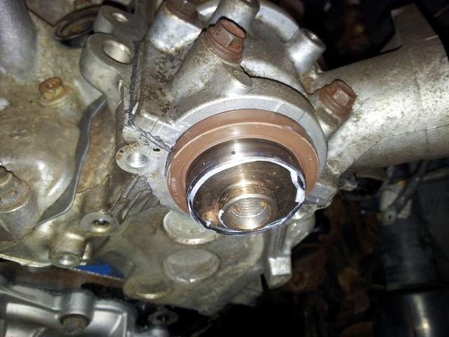

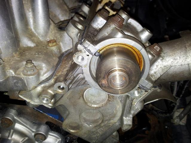

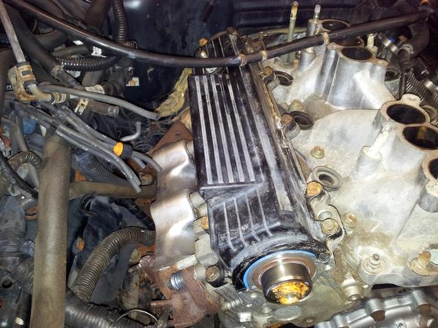

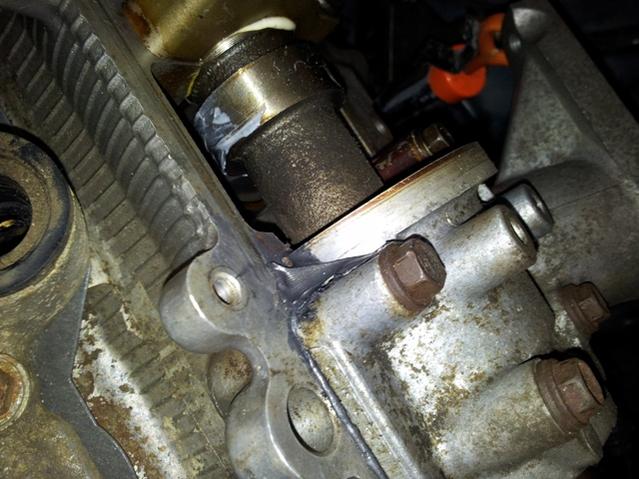

Time to install the front camshaft seals.
Be sure to lube up the lobe generously. Also slather some assembly lube on the seal itself. The goal is to make sure the seal seats properly and the seal lip doesn't roll over while you are installing it.
Slide the seal on by hand first. If it does not go on by hand, something is wrong or you have the wrong seal.

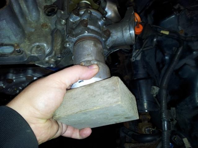

Using a seal seat tool, a large socket, or (in my case) a piece of exhaust pipe, seat the seal. Place a block of wood on the end and hit around the surface of the wood with a hammer being sure to seat the seal evenly.
The seal won't seal perfectly flush, but it should be even all the way around. If one side is sitting higher than the other, the seal is not fully seated.

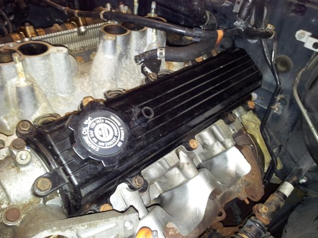

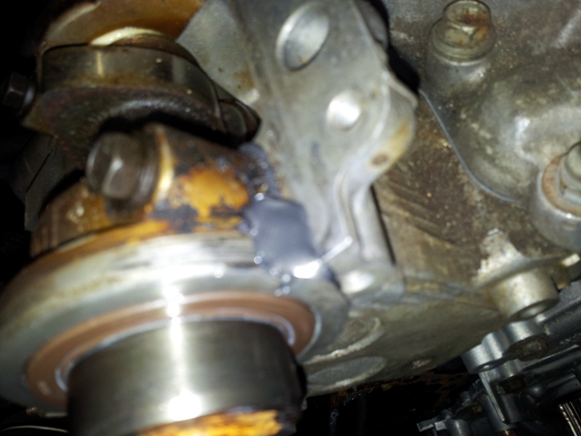

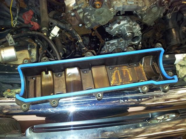

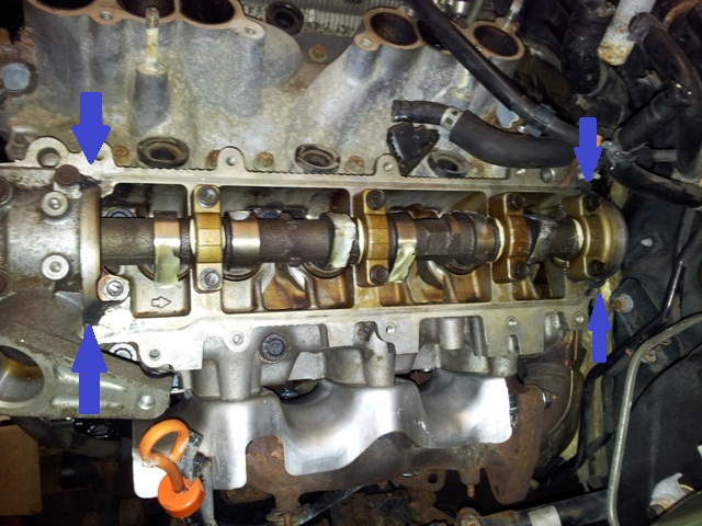

Apply gasket sealer to all four corners of the head where the cam bearing cap meets the head. This will ensure no oil leaks.
Install the new valve cover gasket on the valve cover. Pay attention to the orientation of the gasket. The gasket will not seat perfectly until you bolt the cover on, but all four corners and the long sides should be pressed into place before installation.
The valve covers installed. The cover with the oil cap goes on the driver side.

This was the timing mark that was discussed earlier. There is a small notch in the rear flange. Use THIS MARK, NOT THE ONE ON THE FRONT OF THE GEAR.

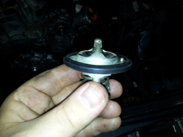

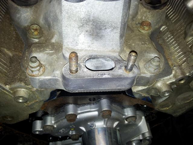

Cleaned up the cooling outlet flange on the intake.

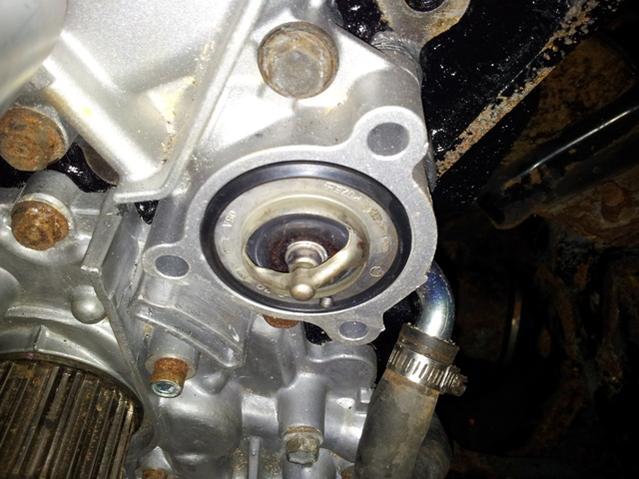

NOTE: The gasket that attaches to the thermostat goes AROUND the lip on the thermostat. If you look closely at your gasket, you'll see the groove that it sits in.
The thermostat installed in the water pump.

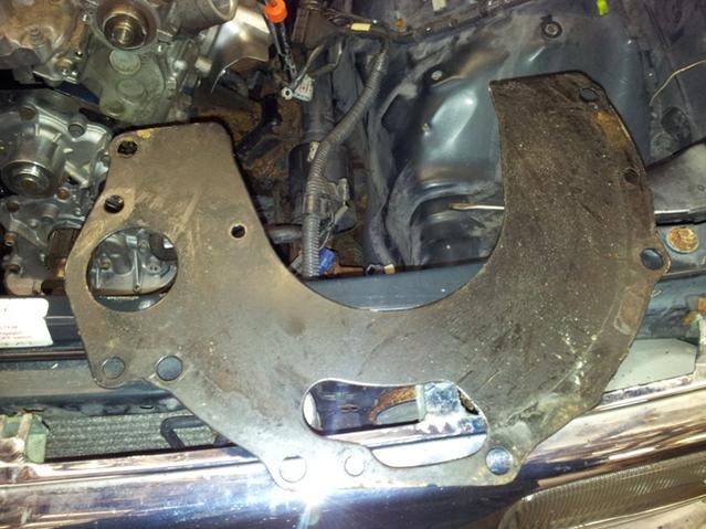

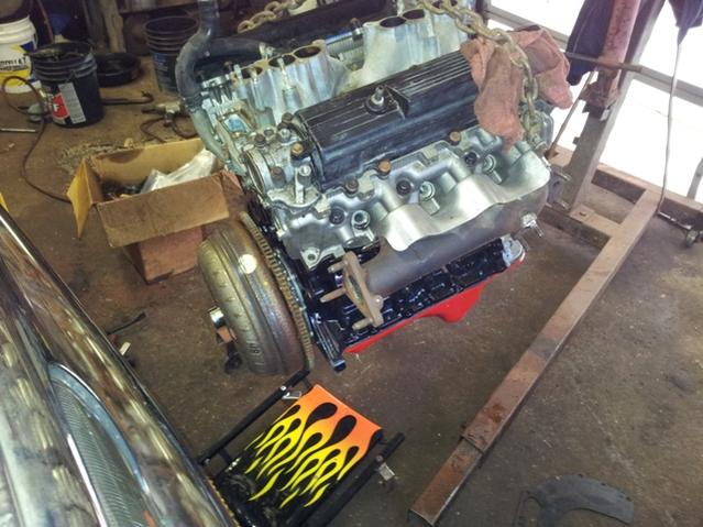

Oh sh*&!
So...I'm in the back of the truck going through my parts and I come across this...
Do you see the problem here? This is the plate that goes between the engine and the transmission. After several choice vulgarities, I opened up the books to see how to handle this. Needless to say, unless I feel like ripping the heads off again, I have the unhook and unbolt the tranny, unbolt the motor mounts, slide the whole **** forward, unbolt the engine, and put the plate in... I am not a happy camper right now. I crawled underneath by the tranny and its not pretty under there. Not only is there not much space to work with, everything is rusted to hell. At this point, I gave up for the day and decided to go drink. I'll start fresh this coming weekend...
NOTE: IF ANYONE has not installed this plate and had no problems what so ever, LET ME KNOW!!! It would save me a hell of a lot of time right now. I would put it back in eventually, but I'm trying to get the truck running for winter.
Well don't THAT just suck! Been there many times myself, friend--just about done, and then notice the part that got left out. My best friend and I had this little joke--if a project went too well, we would always say "tear it apart", figuring that something important HAD to have been missed. I can't imagine that plate being expendable--I would put it in.
EDIT: Alright Bill, stop stealing my lines! Same time, same comments (LOL).

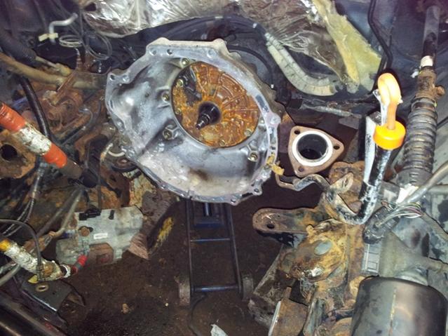

Well, I had an epiphany this weekend while working on the truck. I was able to get the 3VZE out without the transmission. Here's how I did it...
- Remove the IFS "axle" from under the truck.
- Disconnect the steering bar from the pitman arm on the driver's side.
- Unbolt the sway bar from the frame (crosses under the transmission pan.)
- Make sure the radiator is out, the fan bracket is removed, and the engine has been disconnected from the truck. By this, I mean make sure all the wires, connecters, lines, hoses, etc. are disconnected and the engine is ready to lift out.
- Hook an engine hoist to the engine.
- Unbolt the motor mounts from the frame (2 bolts).
- Lift the engine slightly so that the motor mounts are loose, and then unbolt them from the engine and remove them from the engine bay.
- Now, slowly lower the engine until it stops. If you did it correctly, the transmission bell housing should be resting on the rear IFS frame mount.
- At this point, there is enough room behind the engine to unbolt and remove the exhaust crossover pipe.
- Unbolt and remove the crossover pipe. It does take a bit of weaseling to get it out. You may have to remove the coolant sensor block on the back of the intake.
- Once the crossover pipe is out, raise the engine and transmission slightly and place a jack under the transmission to support it. Be sure to use a wood block if you lift on the transmission pan.
- Unbolt the transmission to engine bolts and lift the engine out.
and VOILA!
As you can see, the transmission is still in the truck. Never disconnected anything on it.
