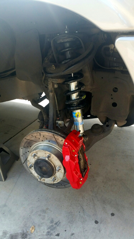

- Did the tundra upgrade on the white gunner with stainless lines

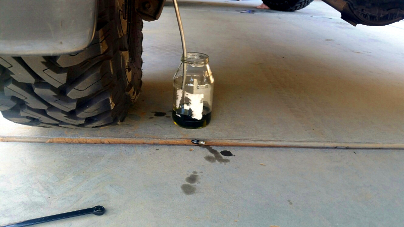

- Bled 4 containers of fluid through the white gunner - Was BAD. Looked like used green motor oil... slightly more transparent
- Did sway bushing front and rear on the white gunner

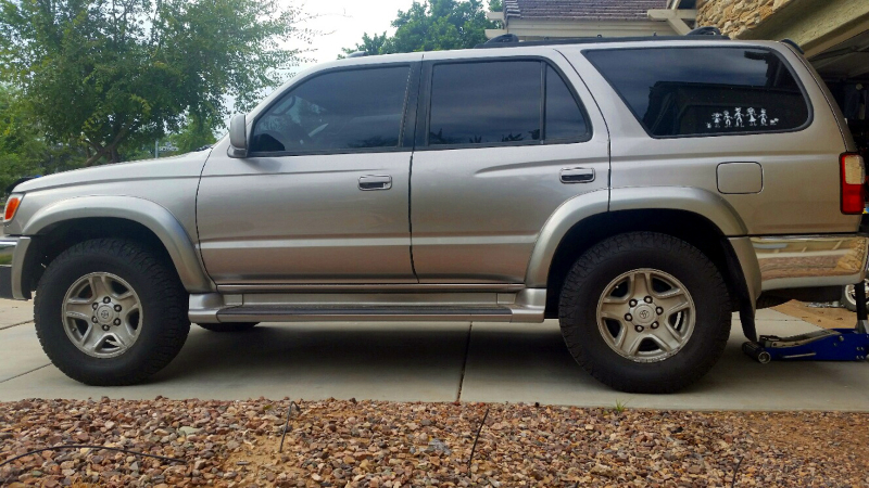

Silver 4runner front before FJ lift. Ground to fender
Silver before lift

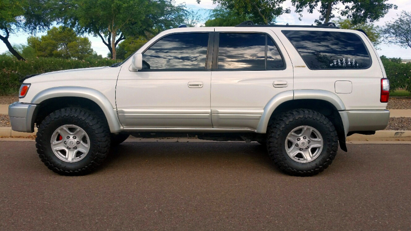

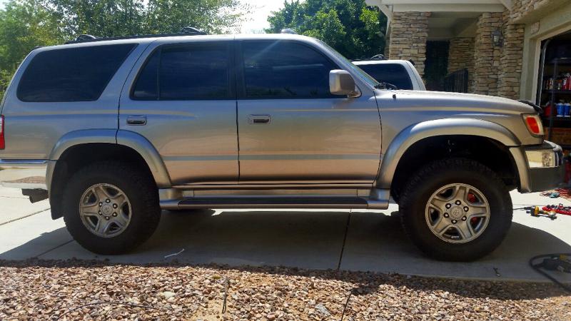

Silver lift after

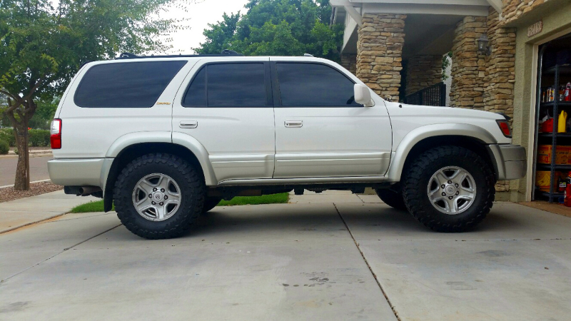

White lift after
Nasty brake fluid
