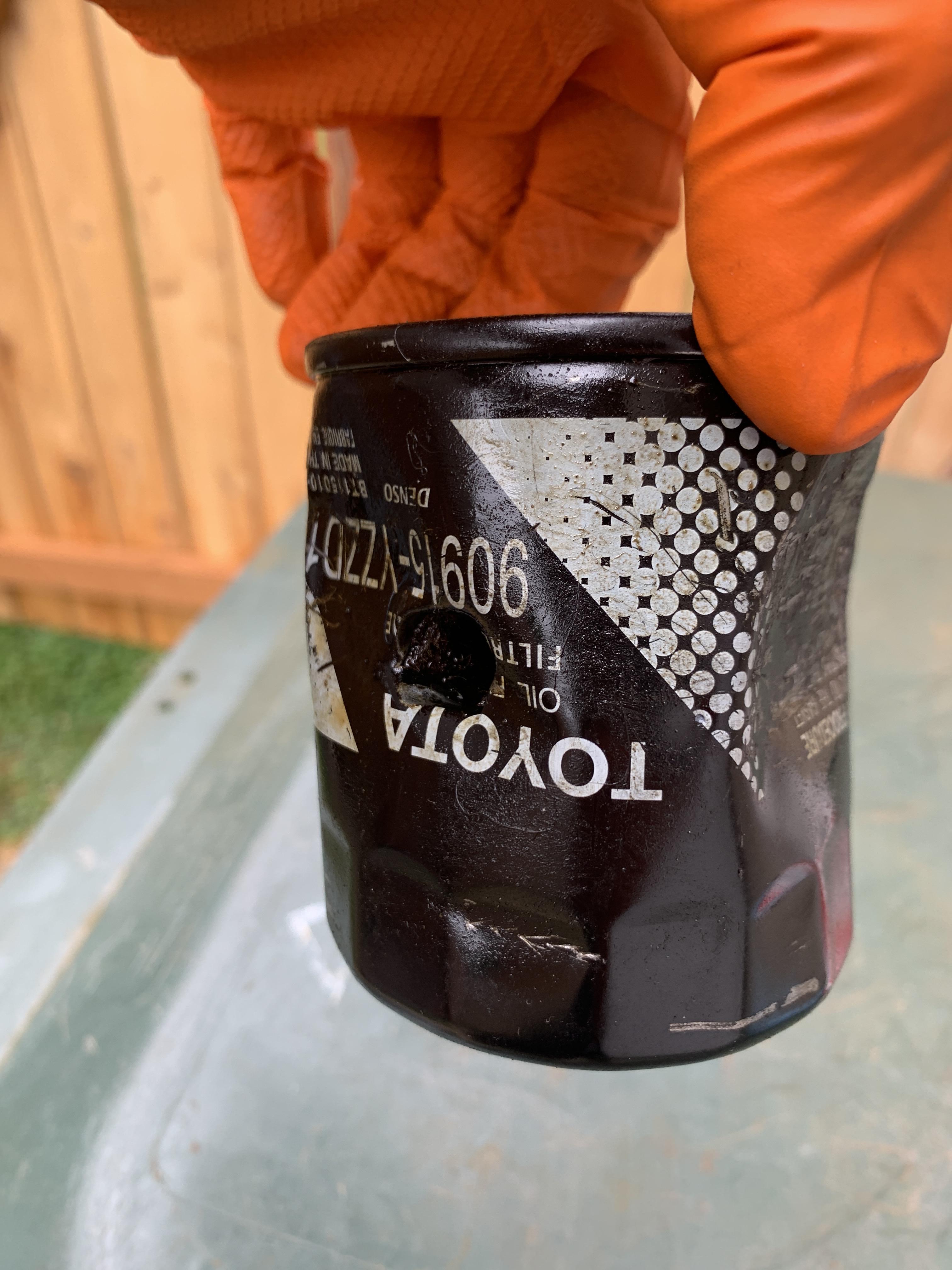

I did some maintenance today on my truck and my wife’s truck. Changed the oil on mines and it was a nightmare. Titus-Will Toyota changed it last and it was tight. I mean i had to use a ajustable pliers and it didn’t work. Finally i just used my punch and it came loose with 2 slight turns. I’m never letting Toyota do my oil change ever again.

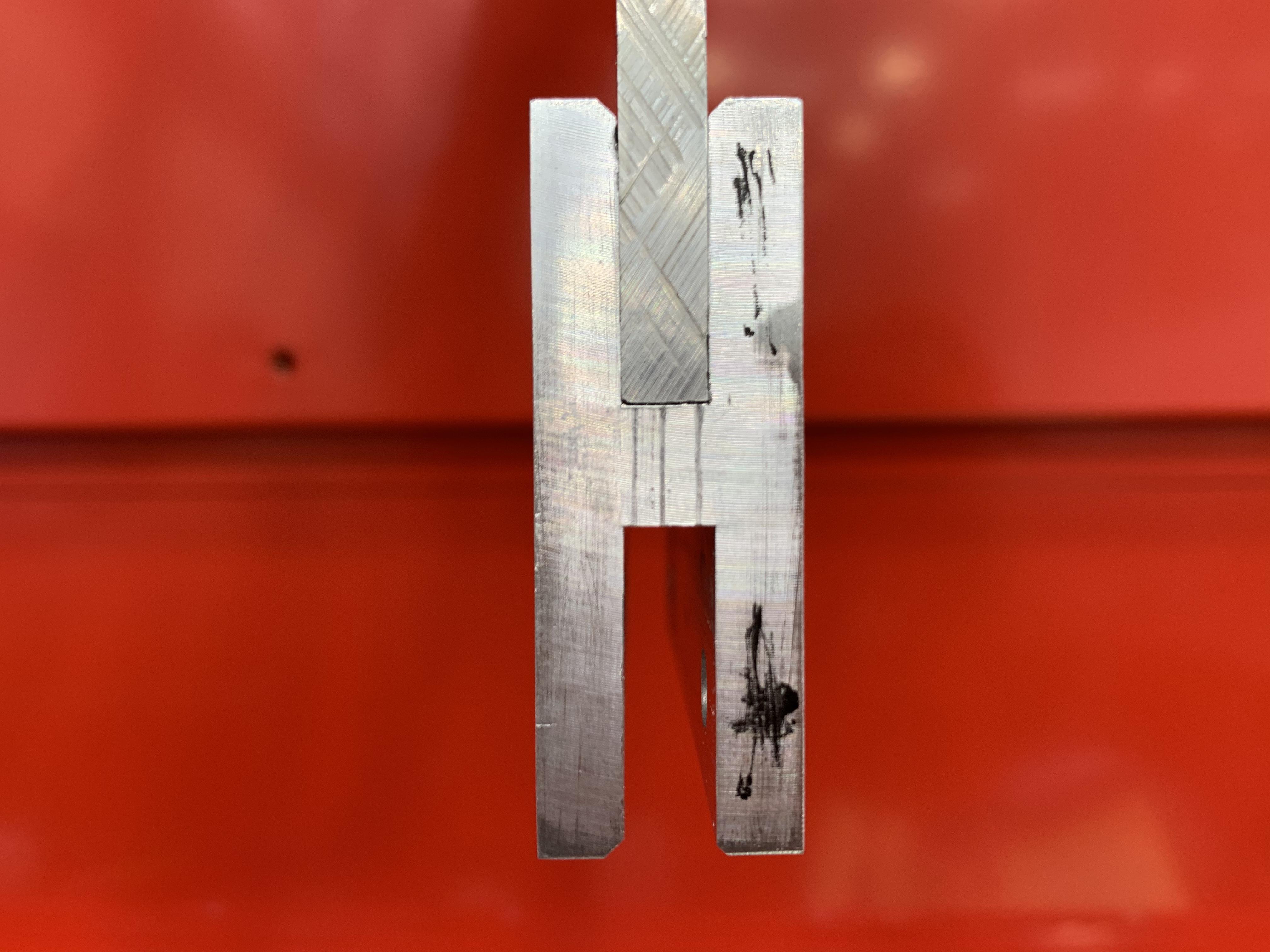

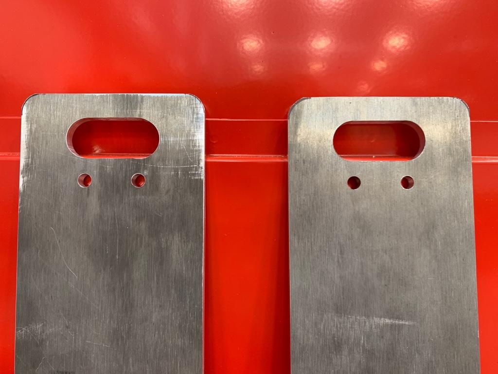

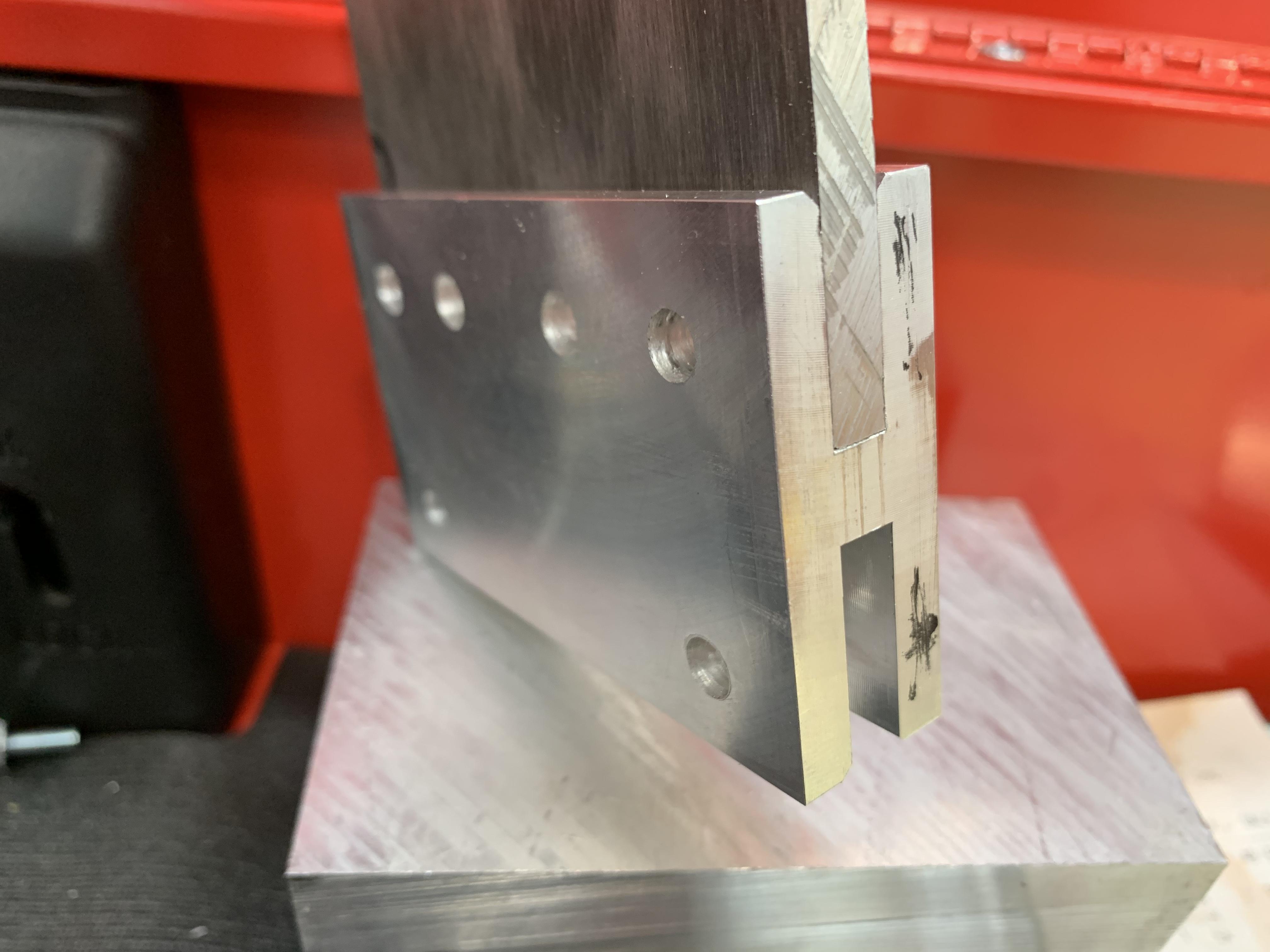

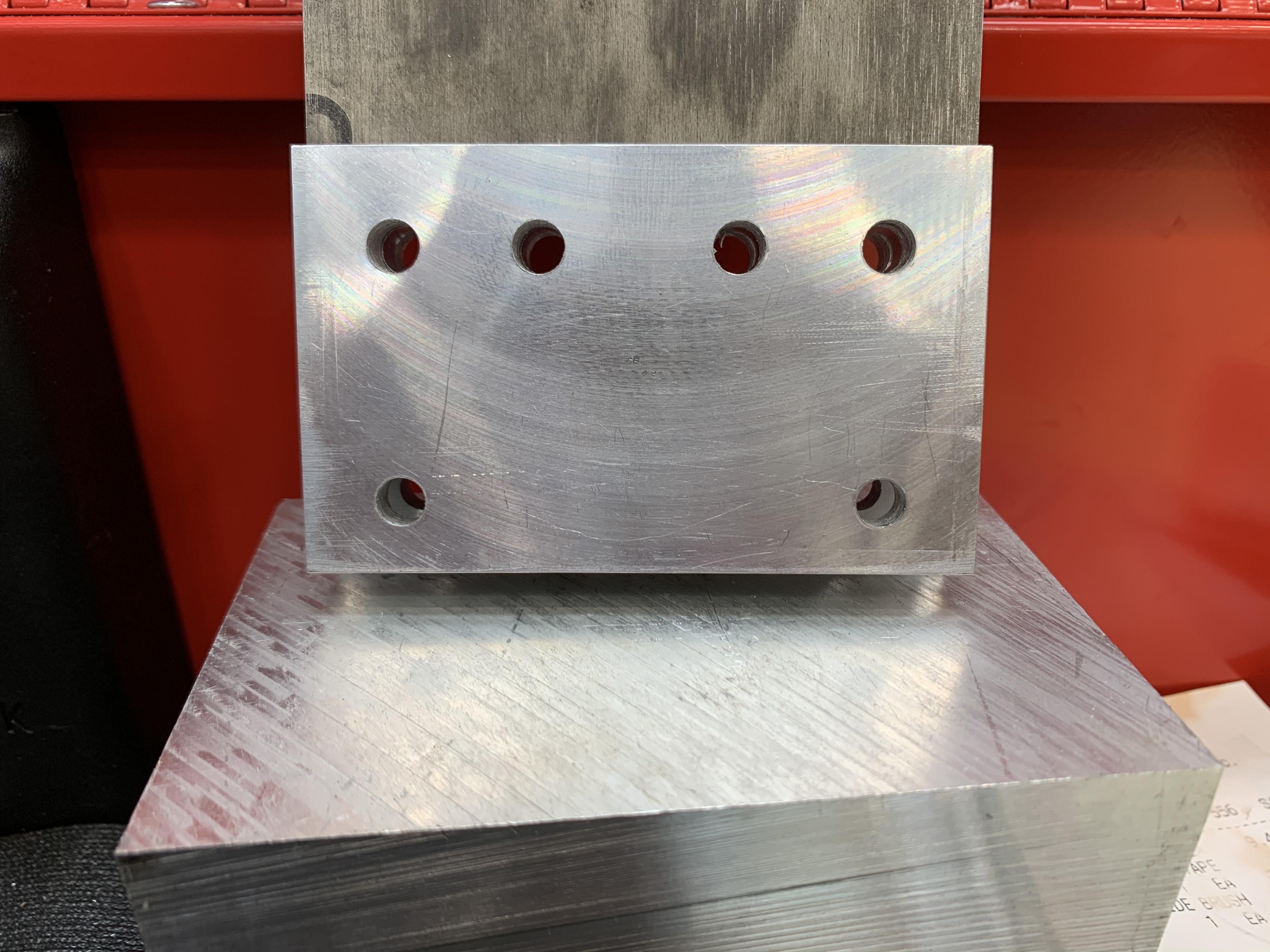

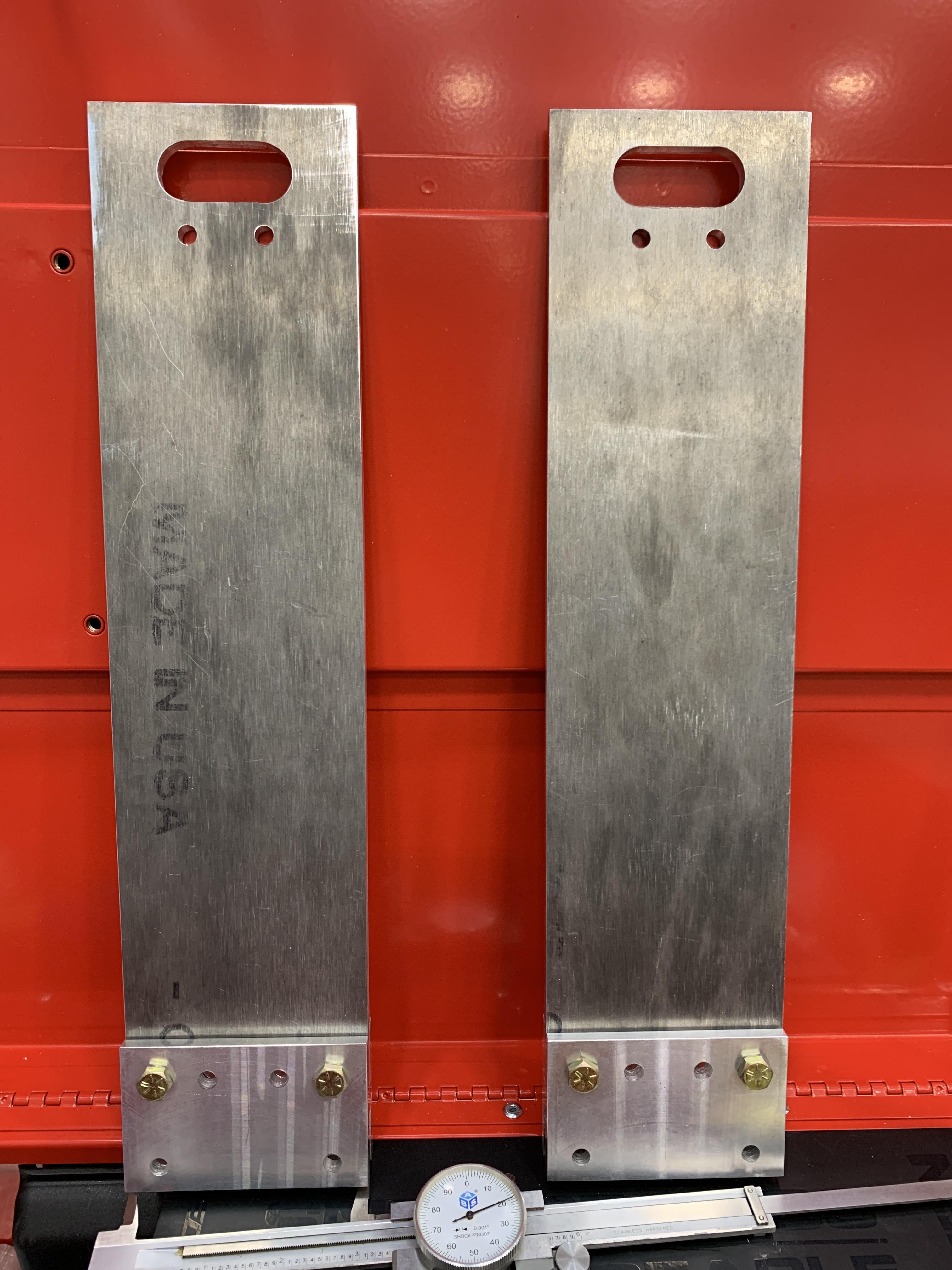

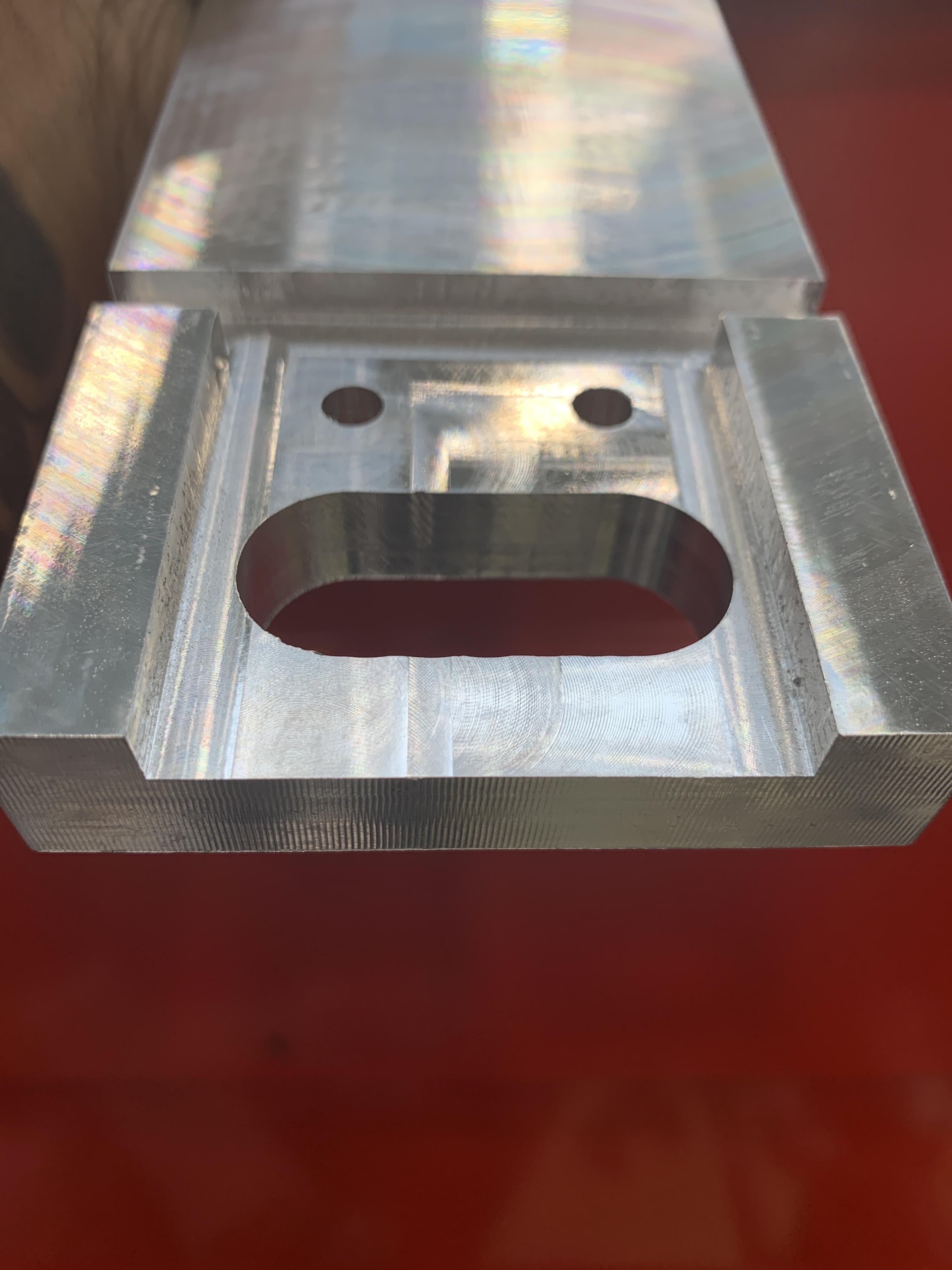

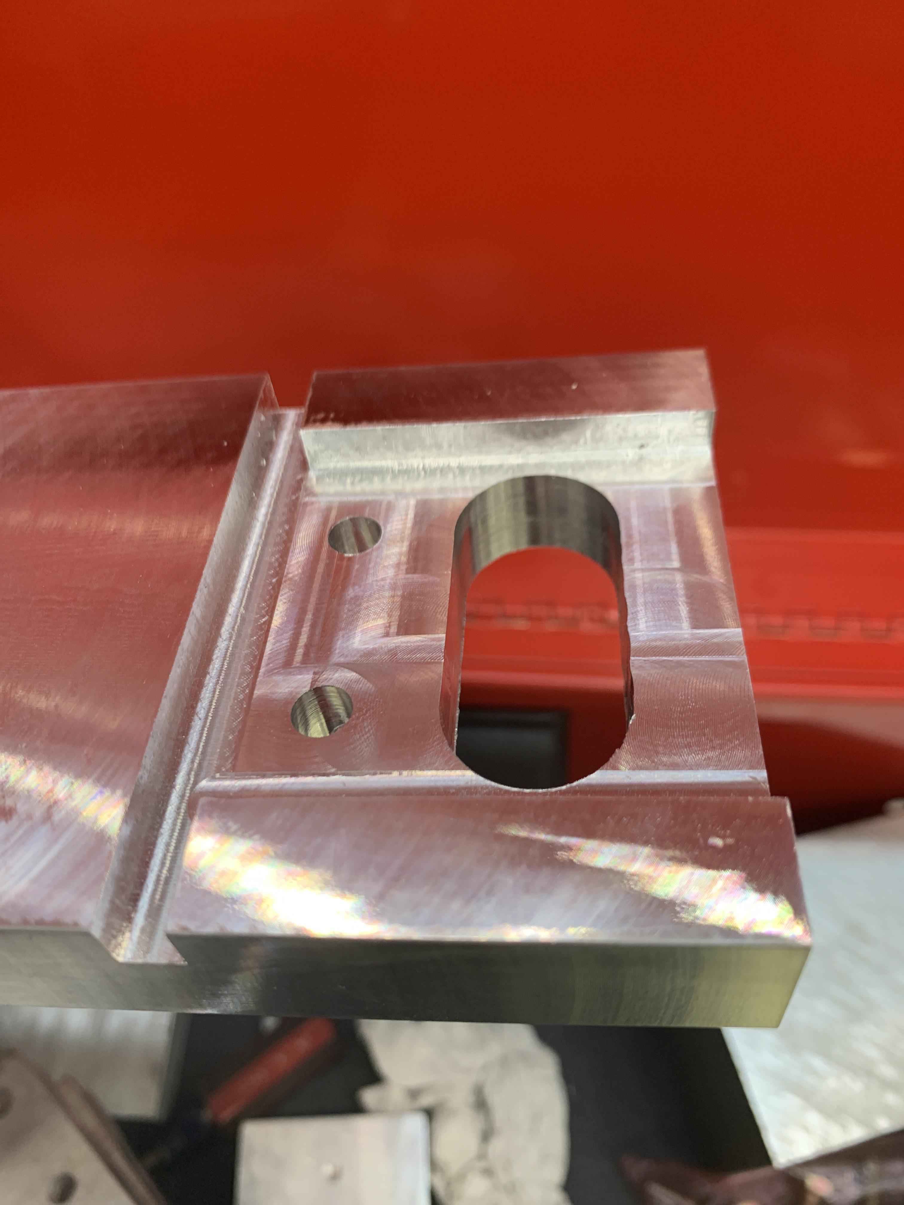

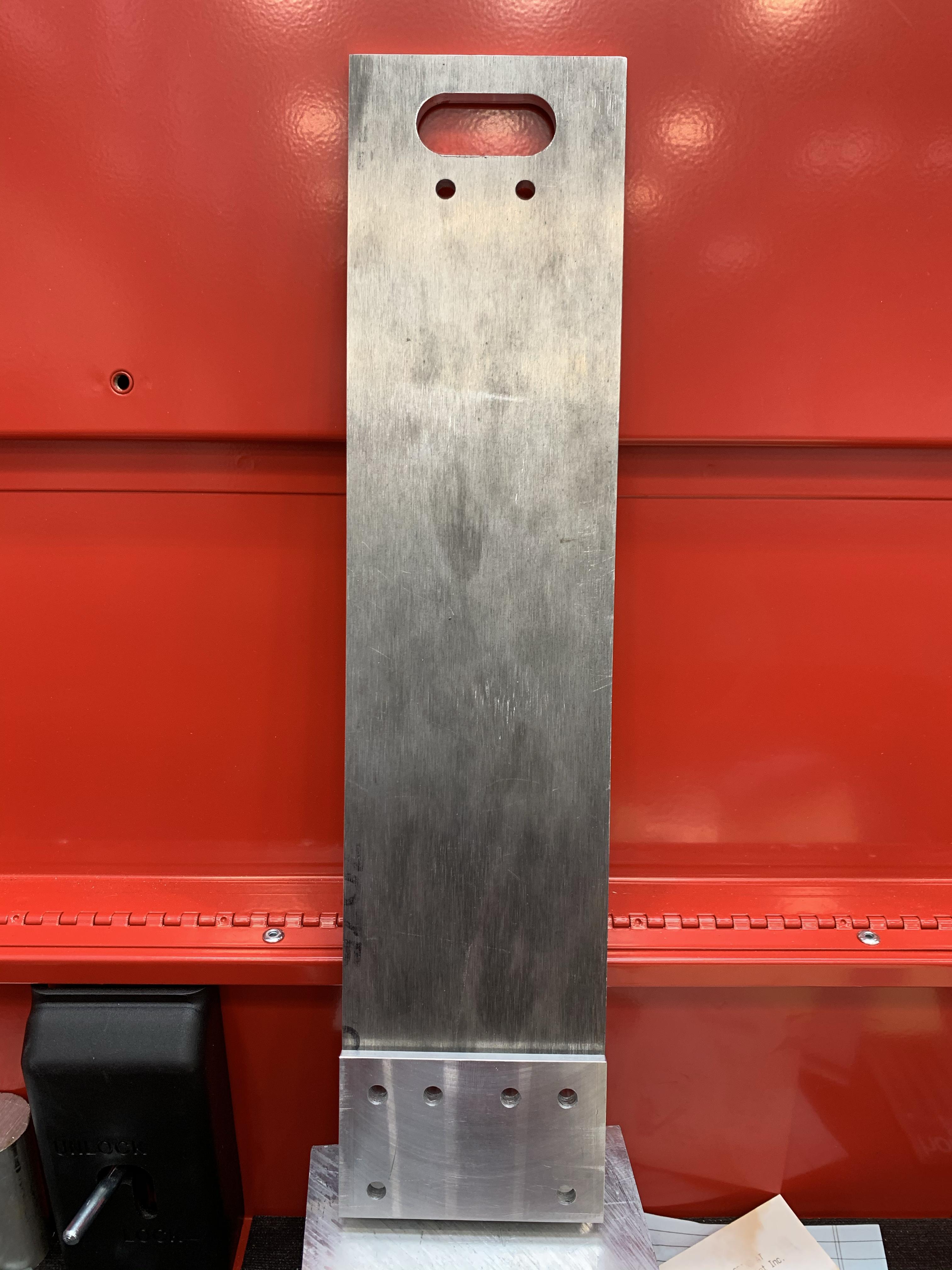

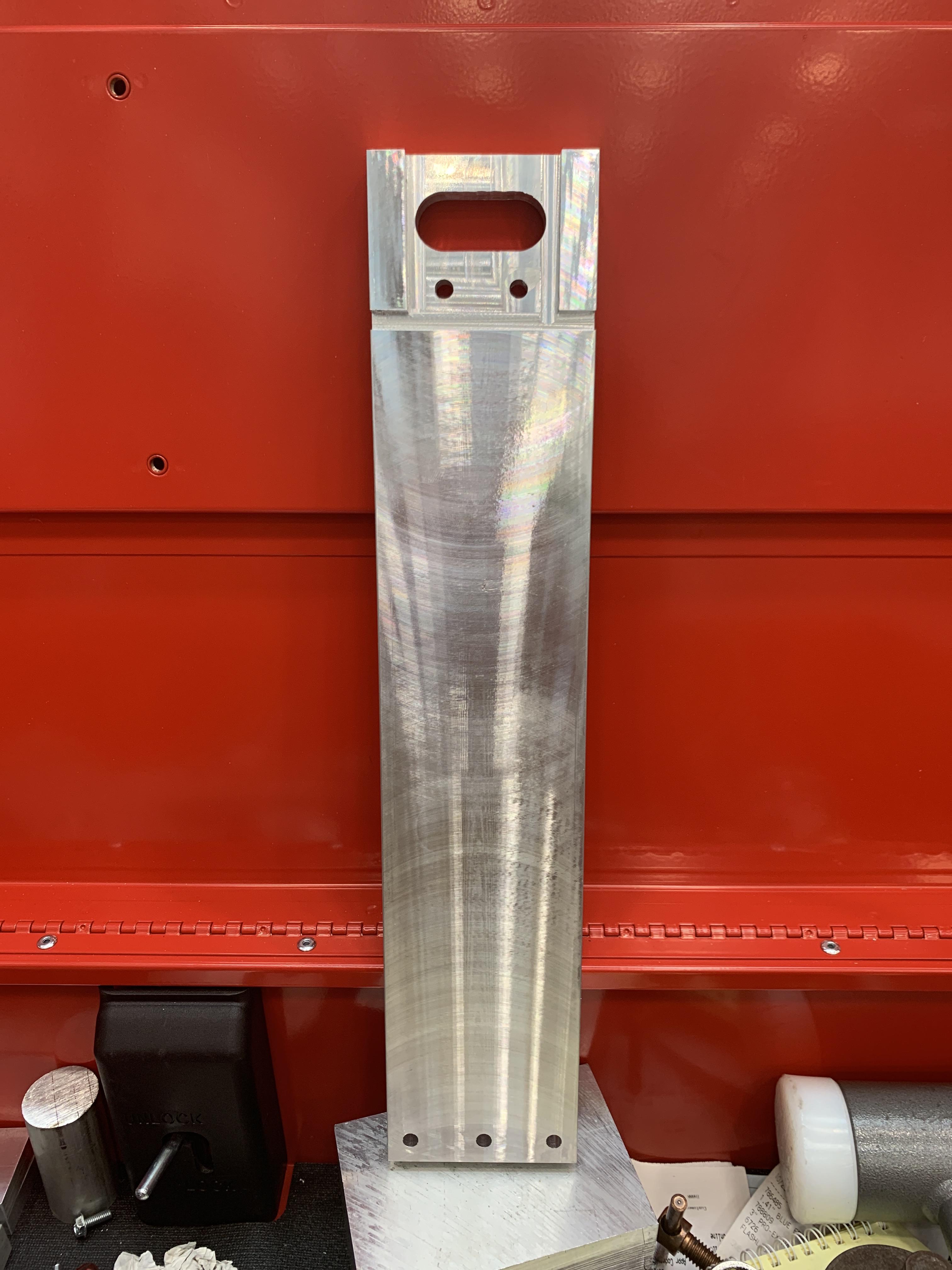

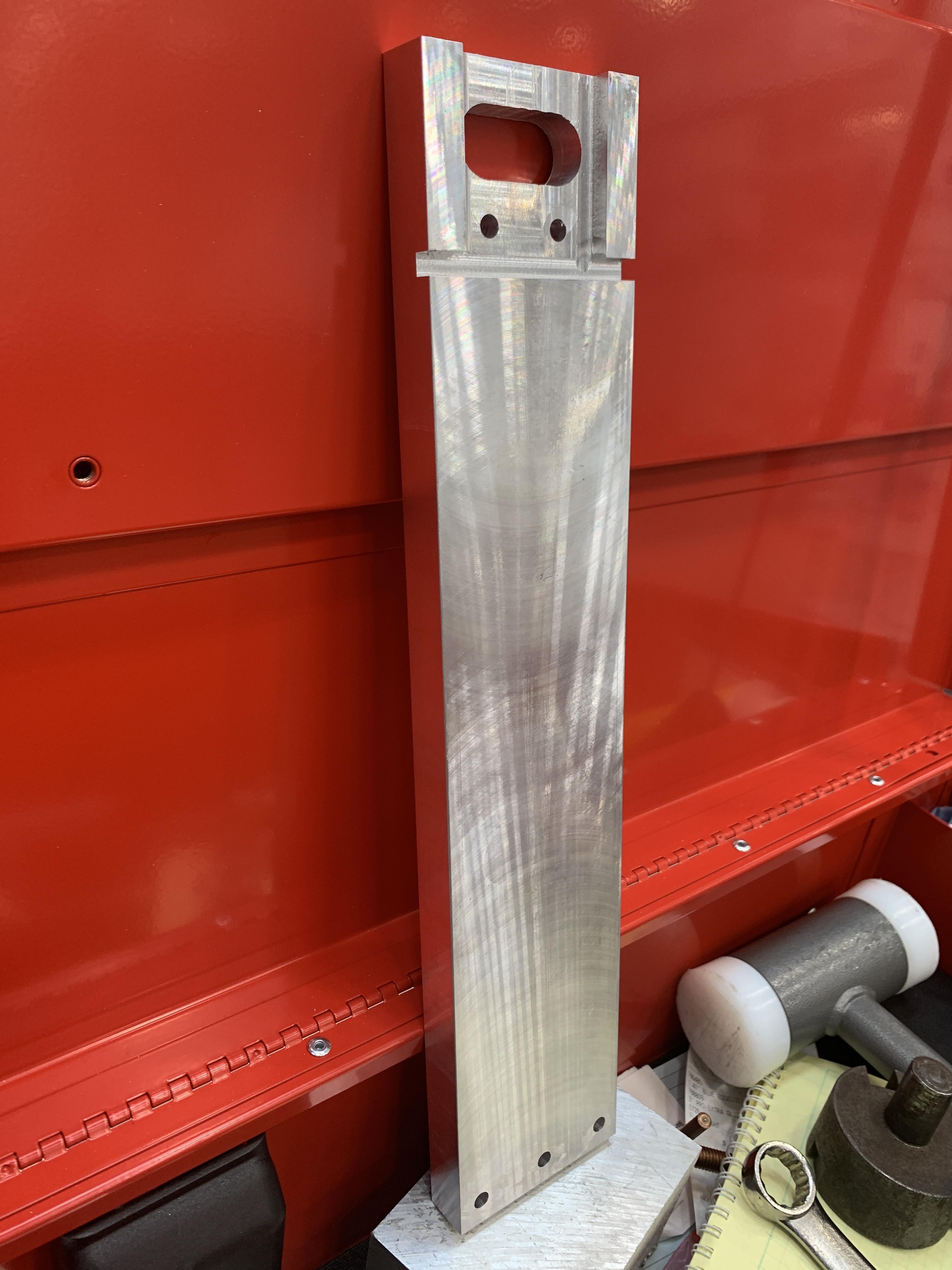

Made a bracket and extension for my rack today. The brackets will be used when I have my tent on and can put an extension bar on the front of the rack to carry kayaks or anything. The H blocks are made of 6061 aluminum and the bar is made of 7075 aluminum.

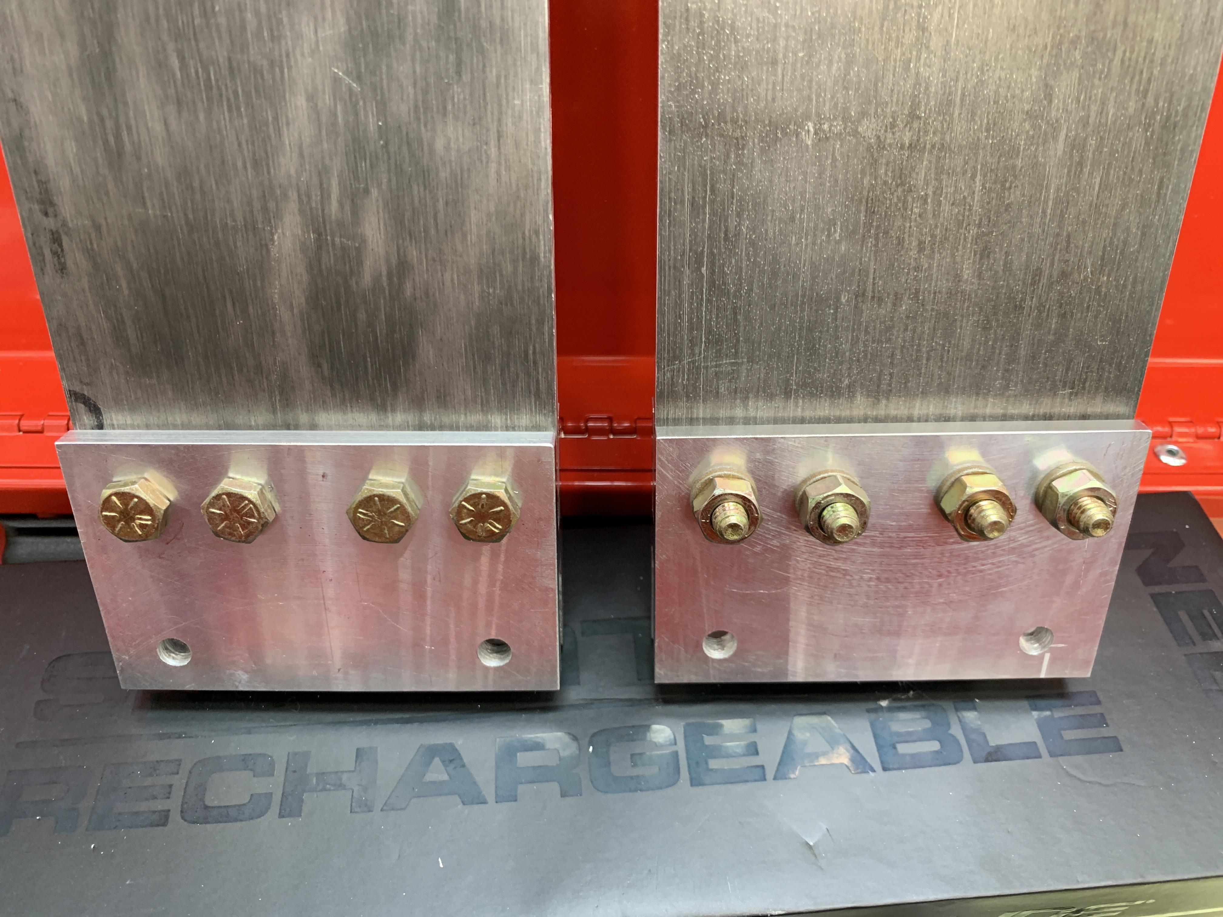

So because I will only be using this brackets when camping, I choose to use grade 8 bolts to hold it together
I also made a 1 piece bracket to see which one is better. I’m liking the 1 piece.

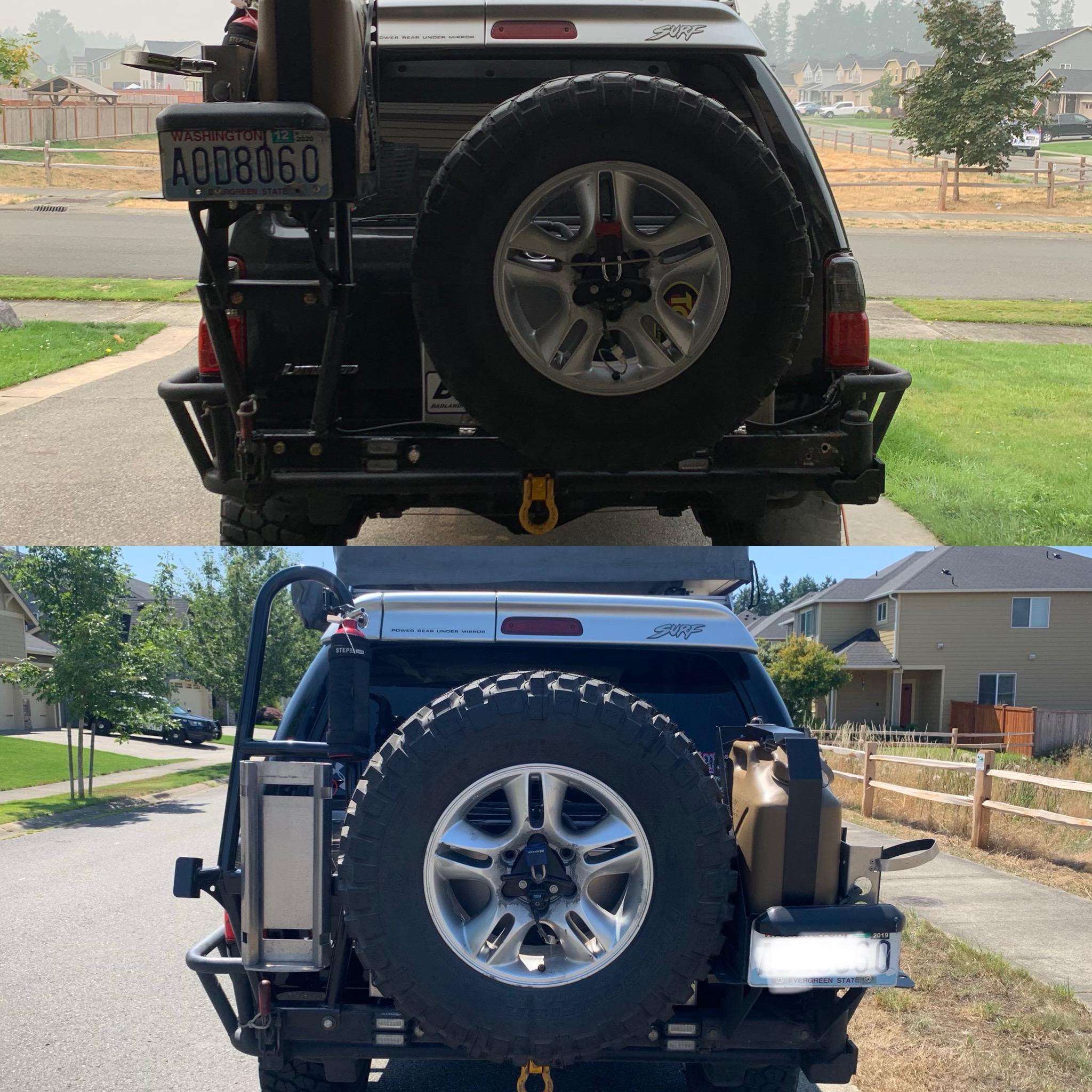

So I moved my tire carrier to the R side instead of the middle because I’m jumping from
A 33” tire to 37”. Looks much better to me and it should of been like that from the beginning.

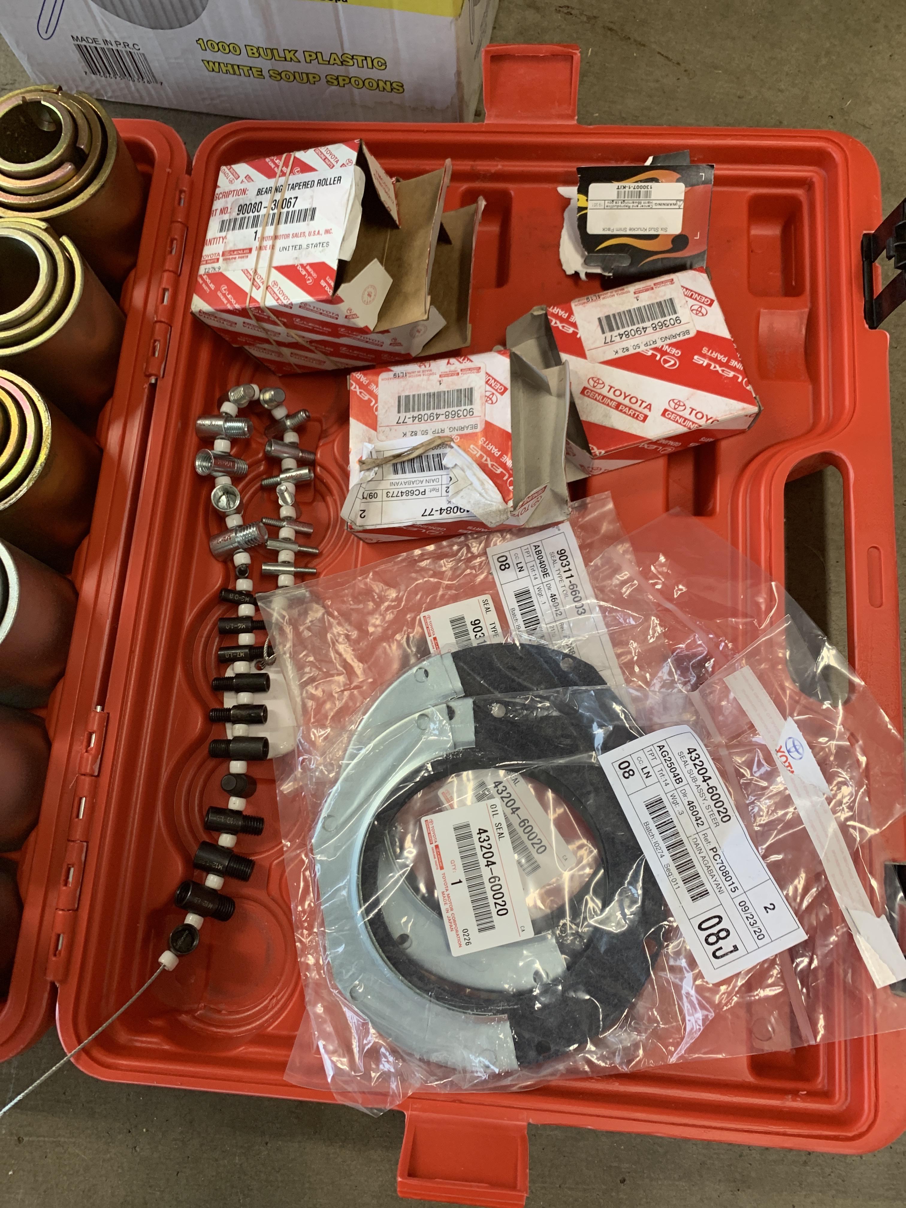

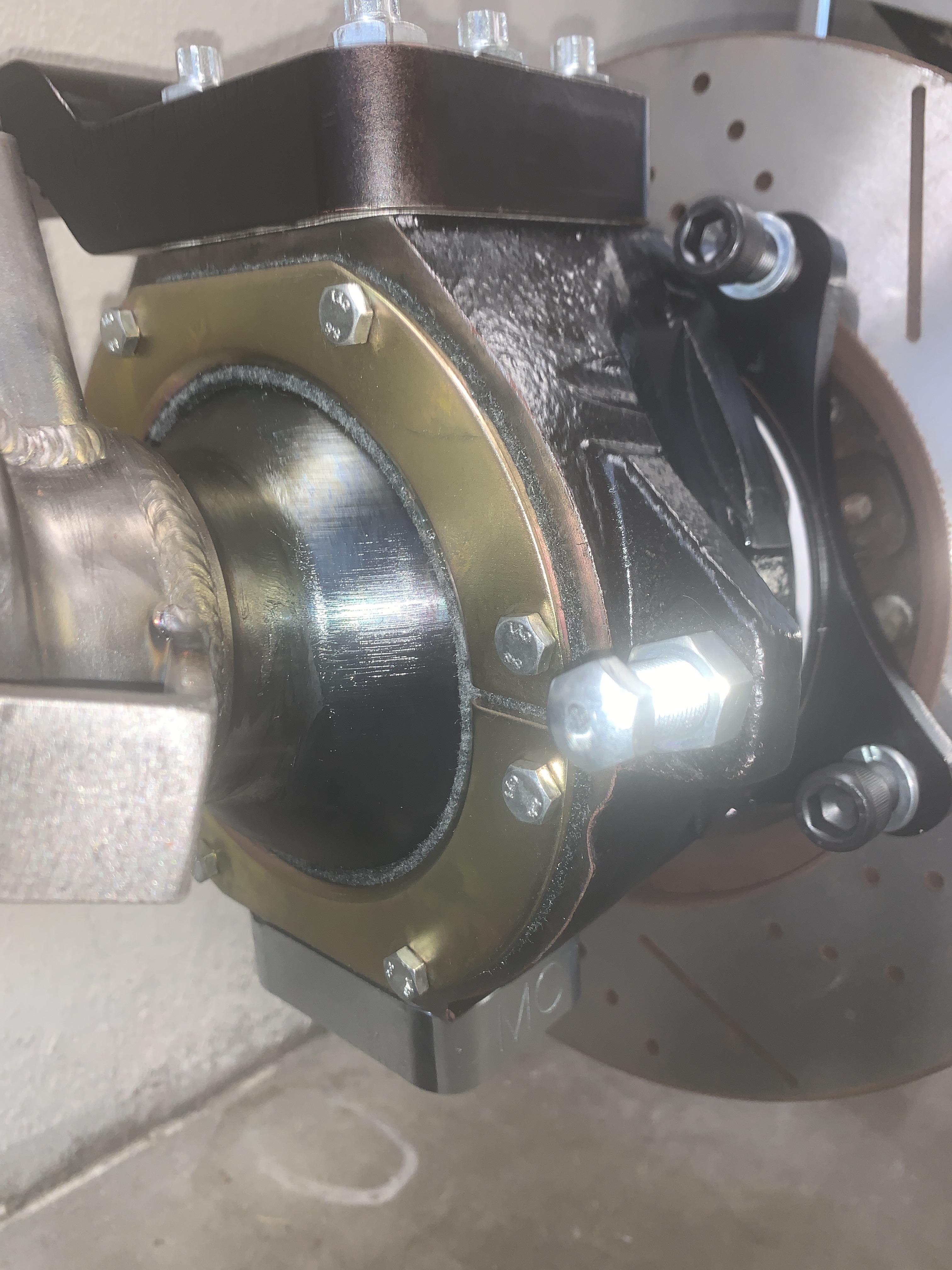

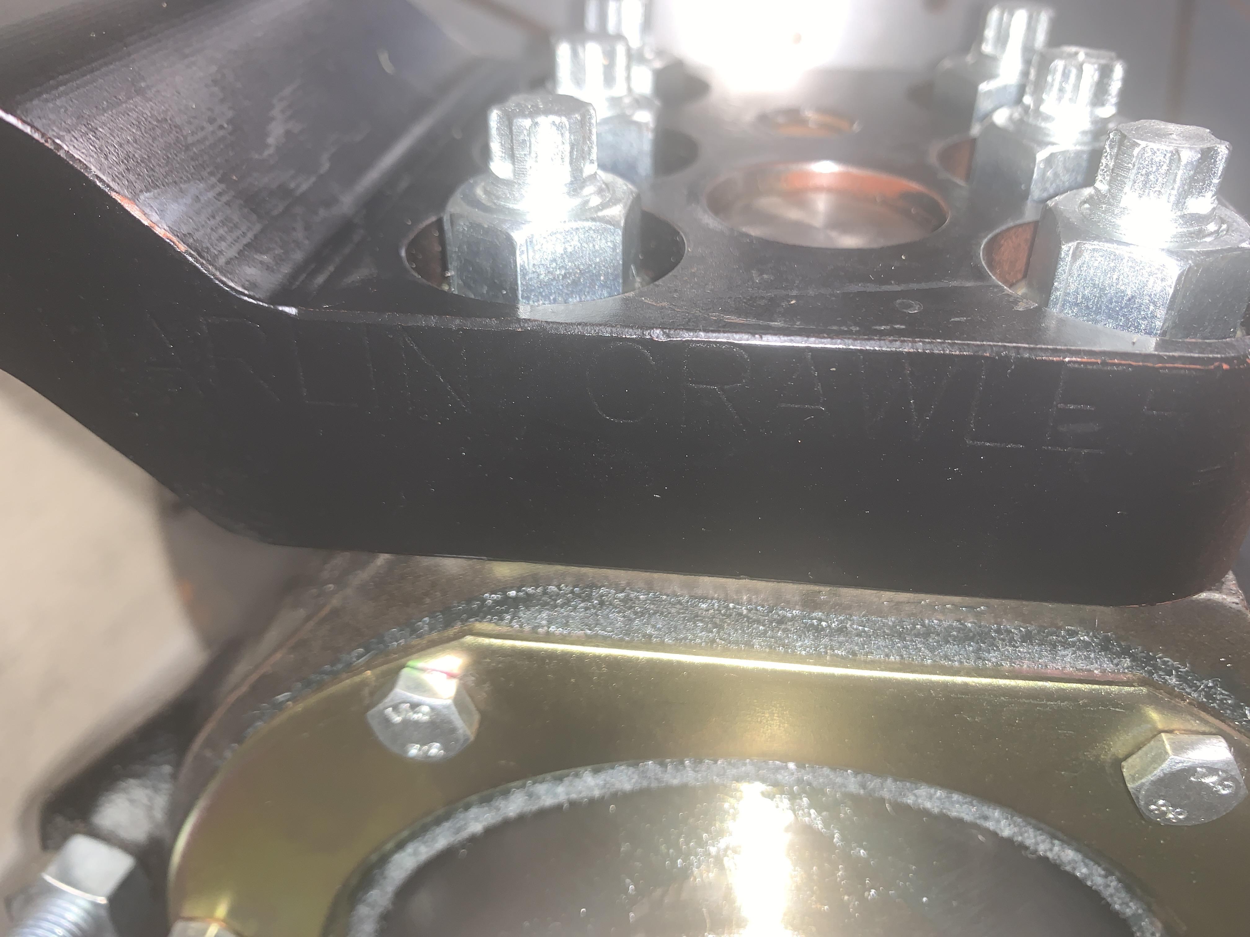

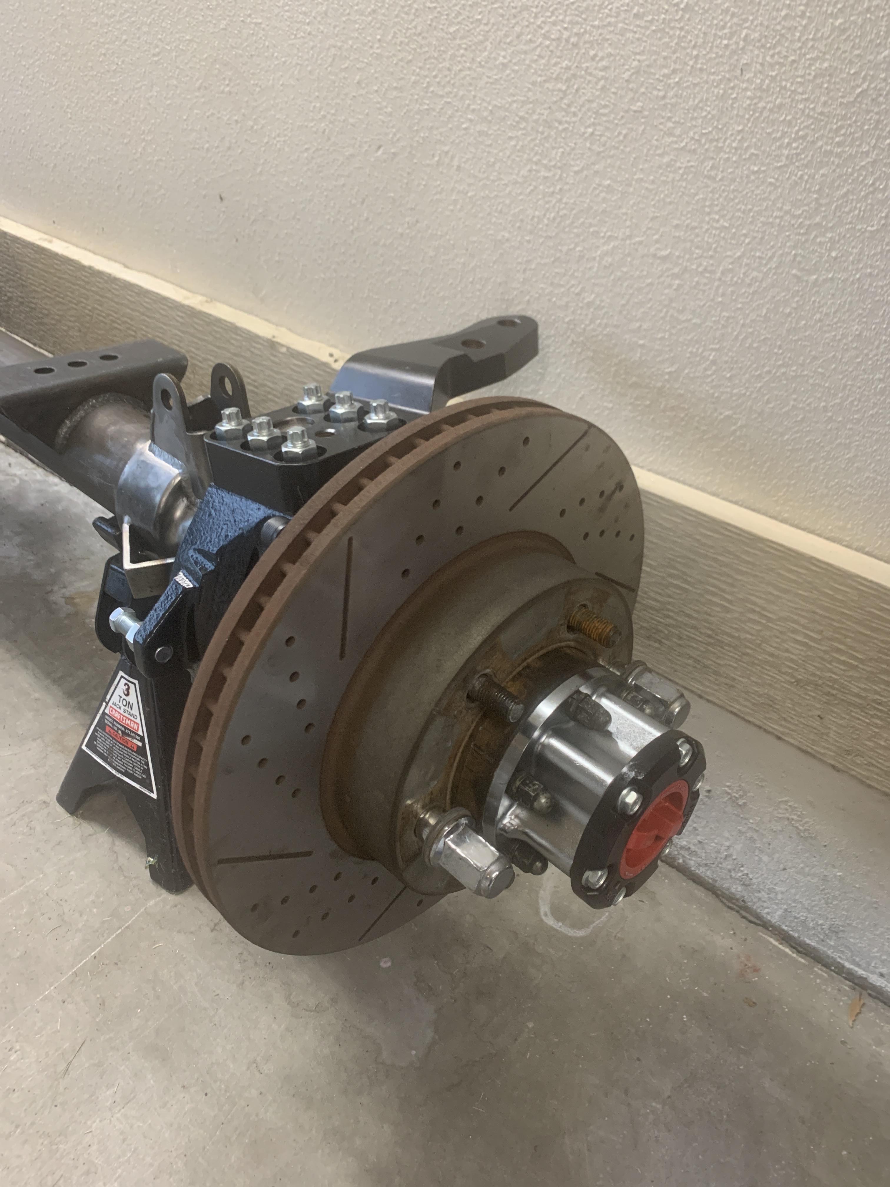

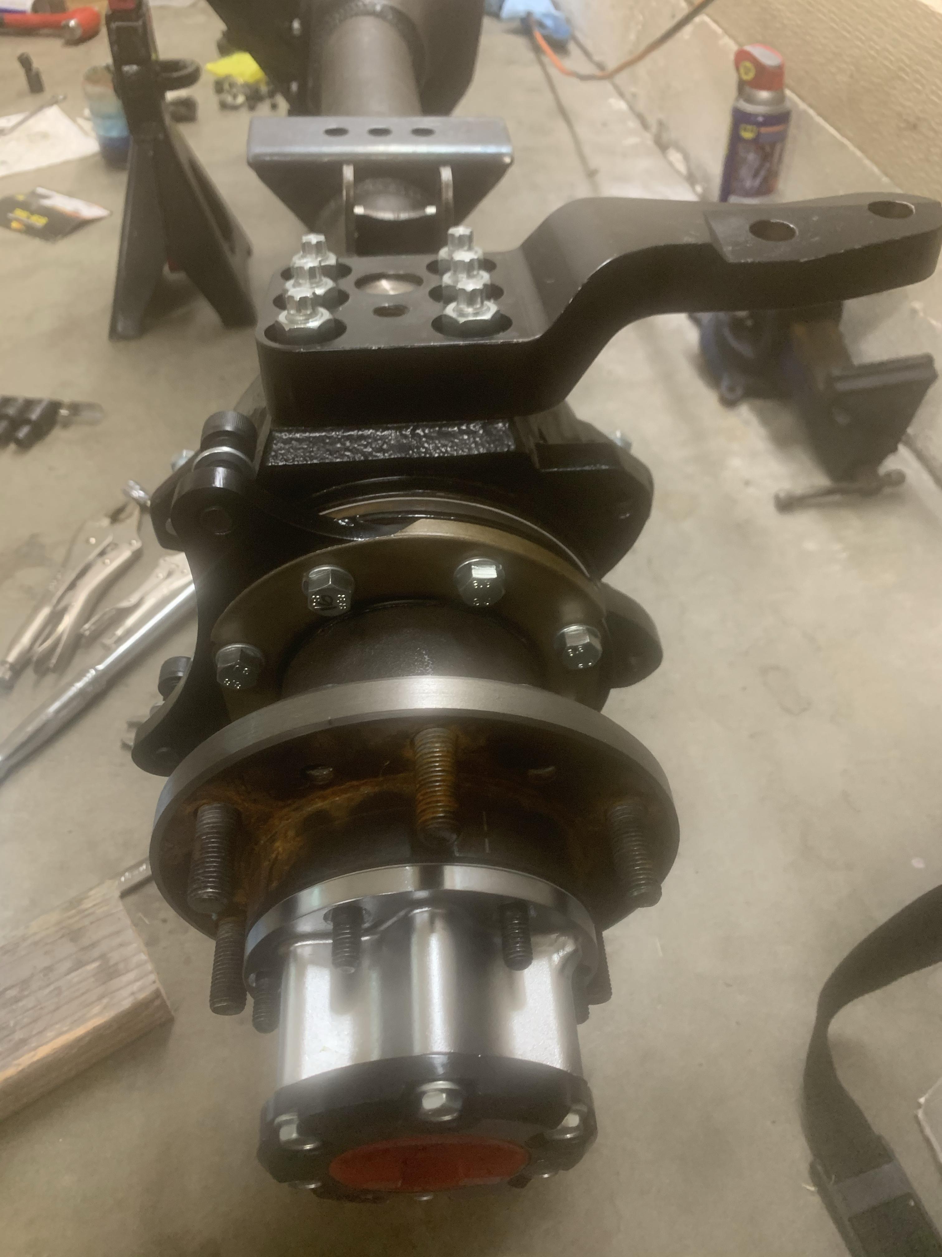

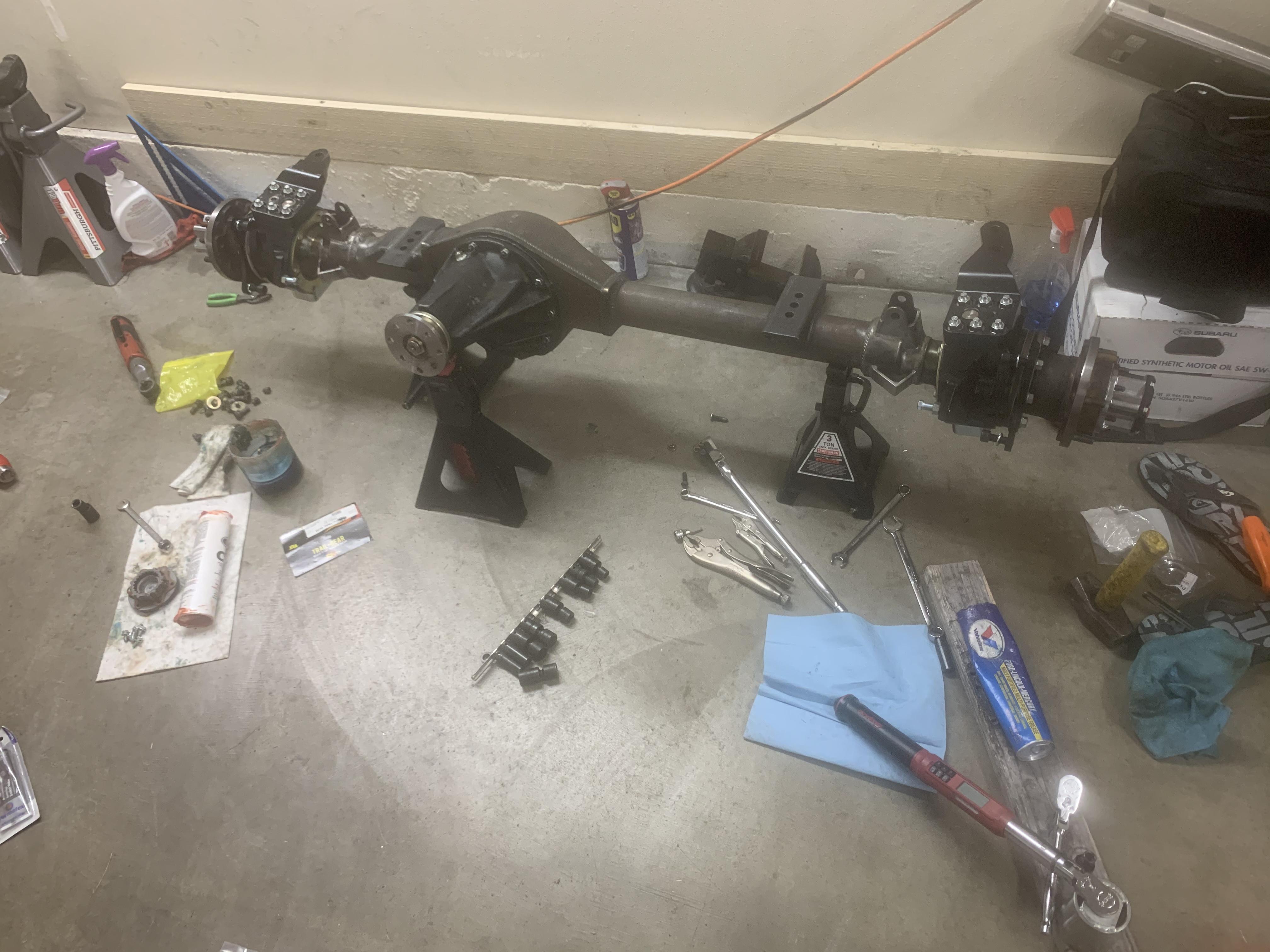

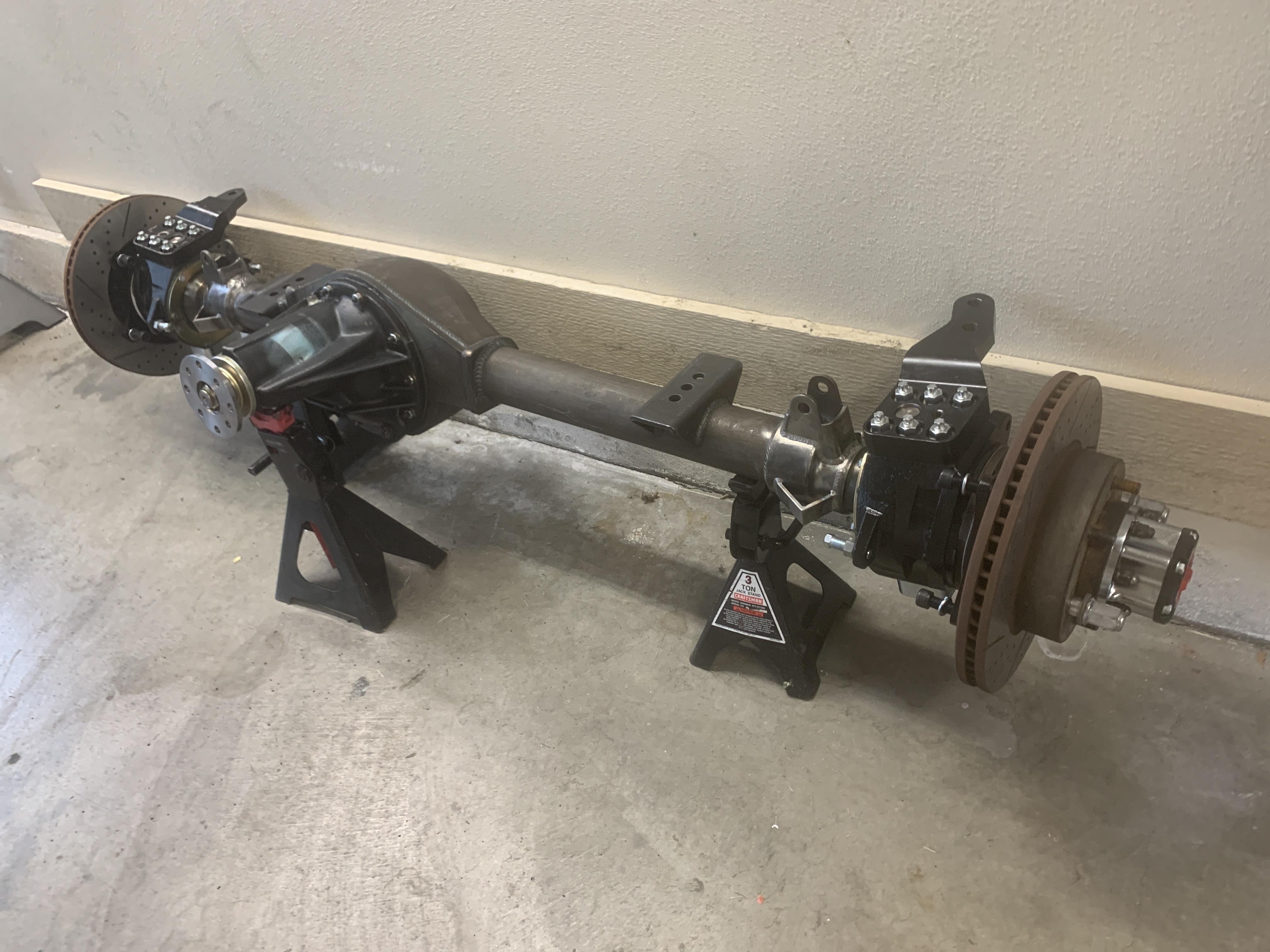

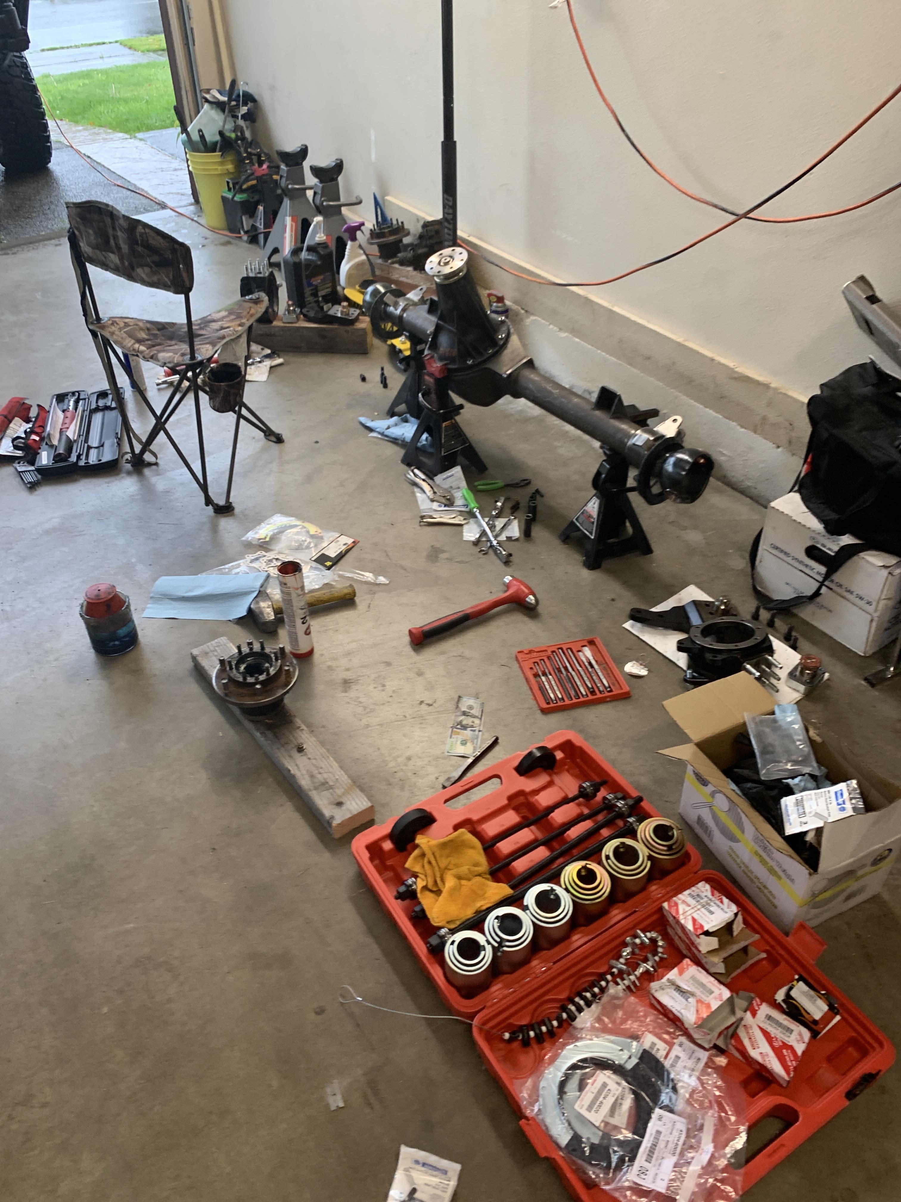

Well the front axle is almost done. Everything is to spec and lubed. I forgot to get the 2 c clips that go on the outer axles by the hub. Damn it’s 2:50 am. [emoji1686]
Does that torque wrench have settings for angle too? My other car has a lot of torque to yield fasteners. Gotta torque then turn so much degrees after so was considering buying a fancy wrench instead of just guesstimating
Yes it does. I bought it cuz I built a sti race block for my son a few years ago. I didn’t even know that it did that’s when I bought it from my Snap On truck. Best investment I made from my snap on tools
