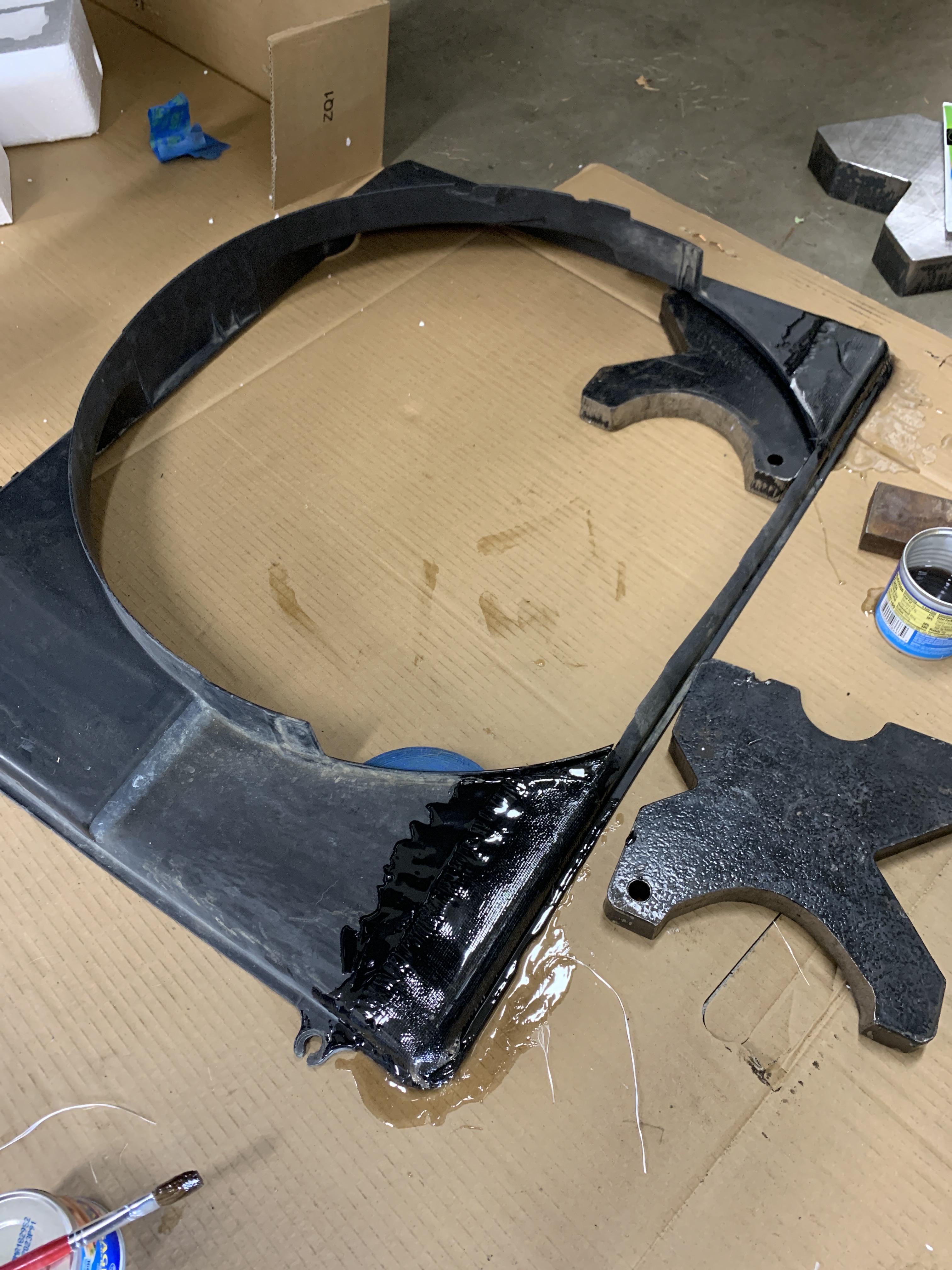

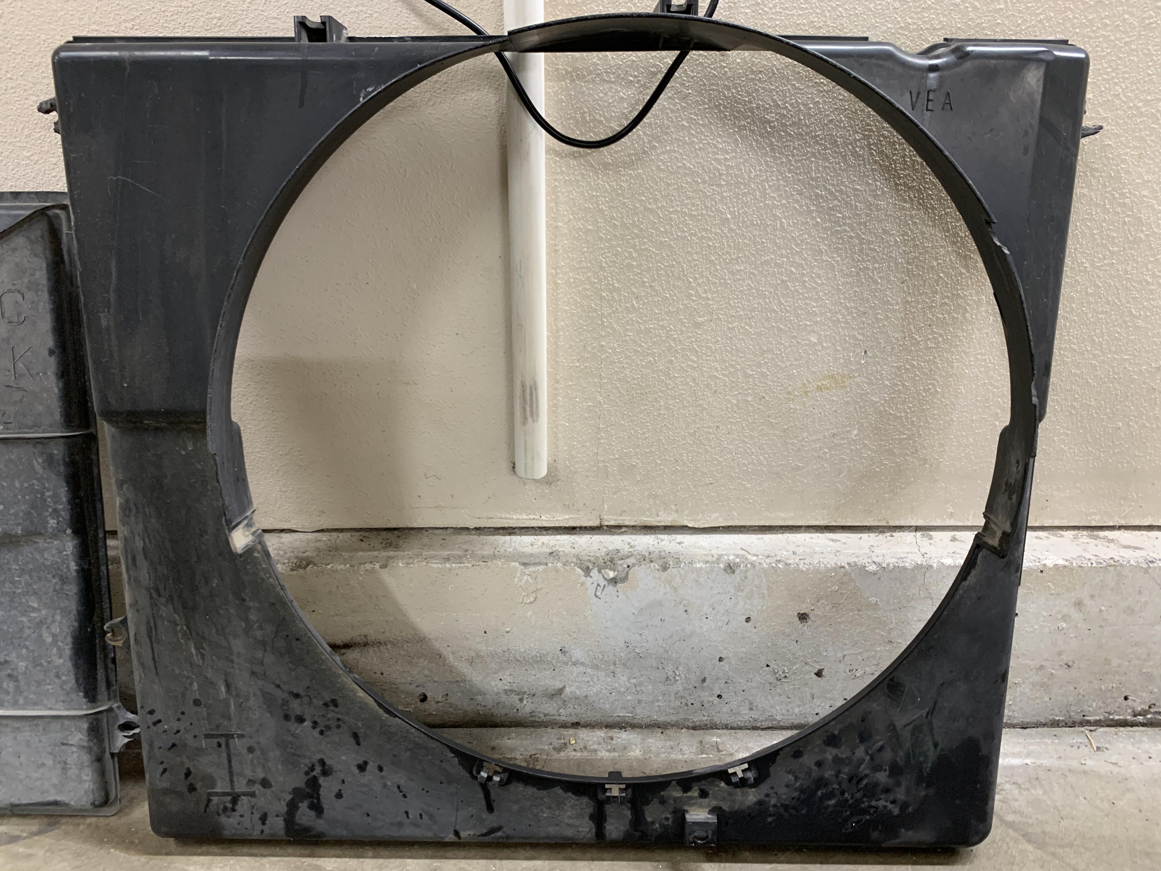

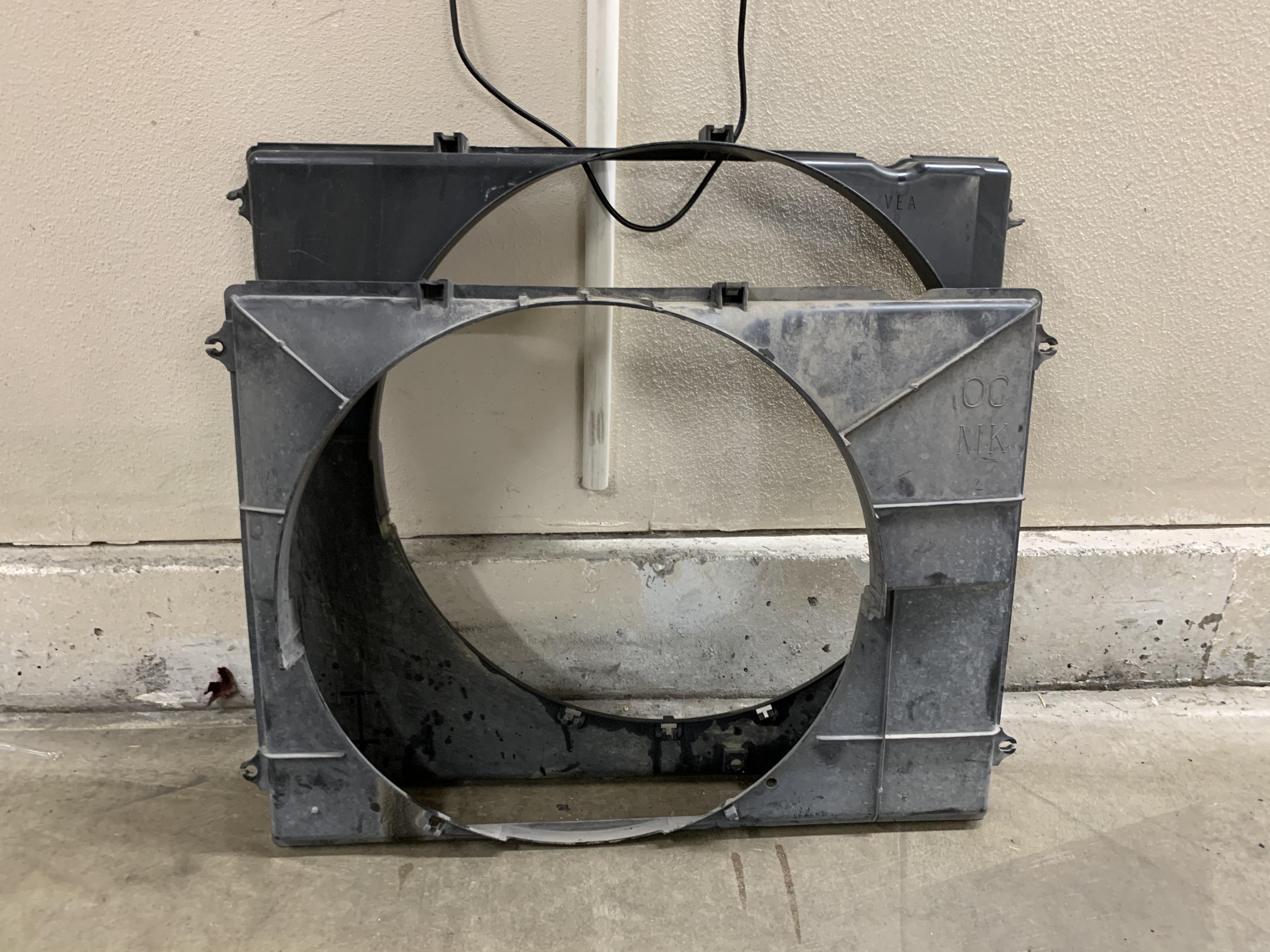

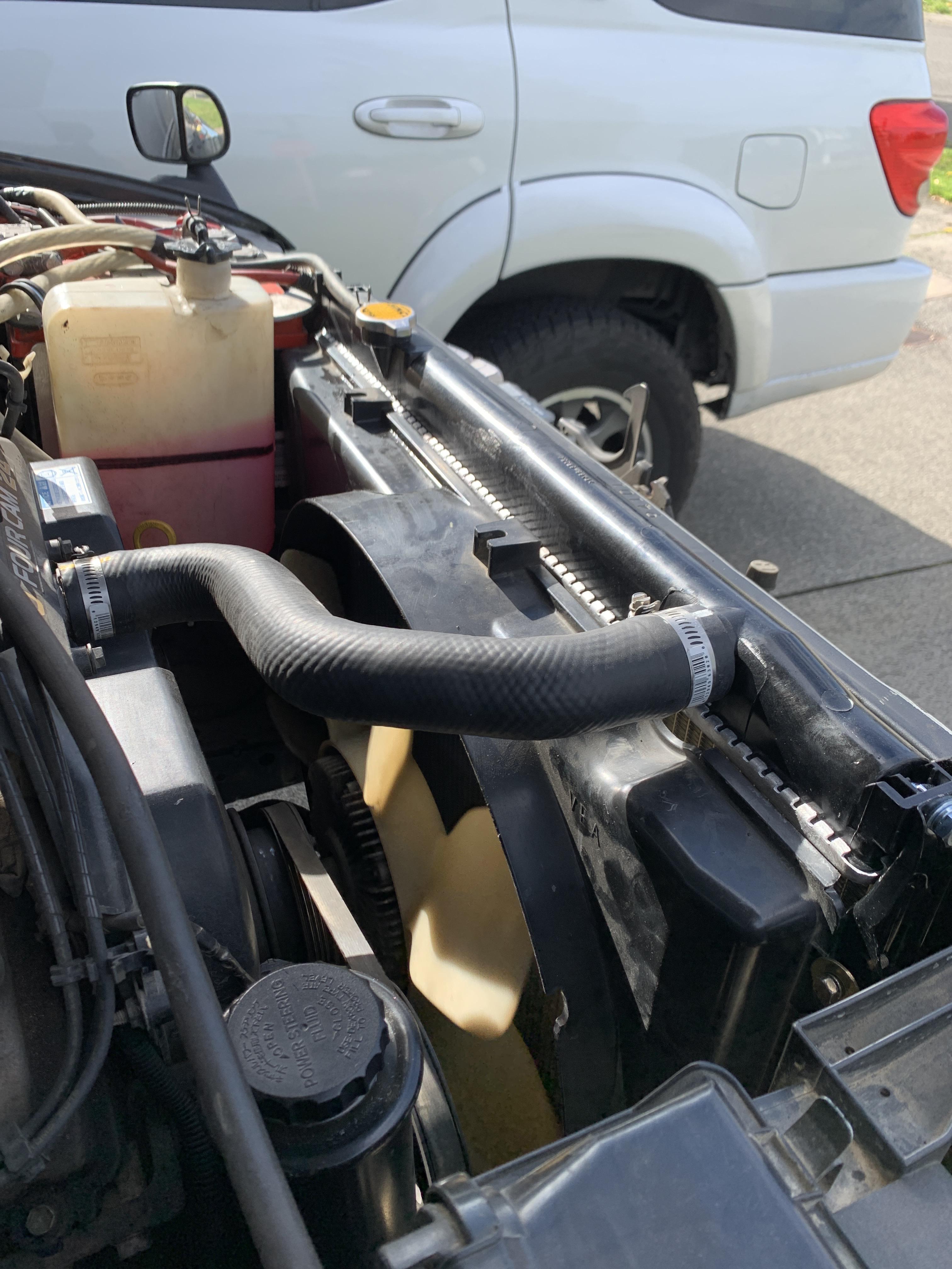

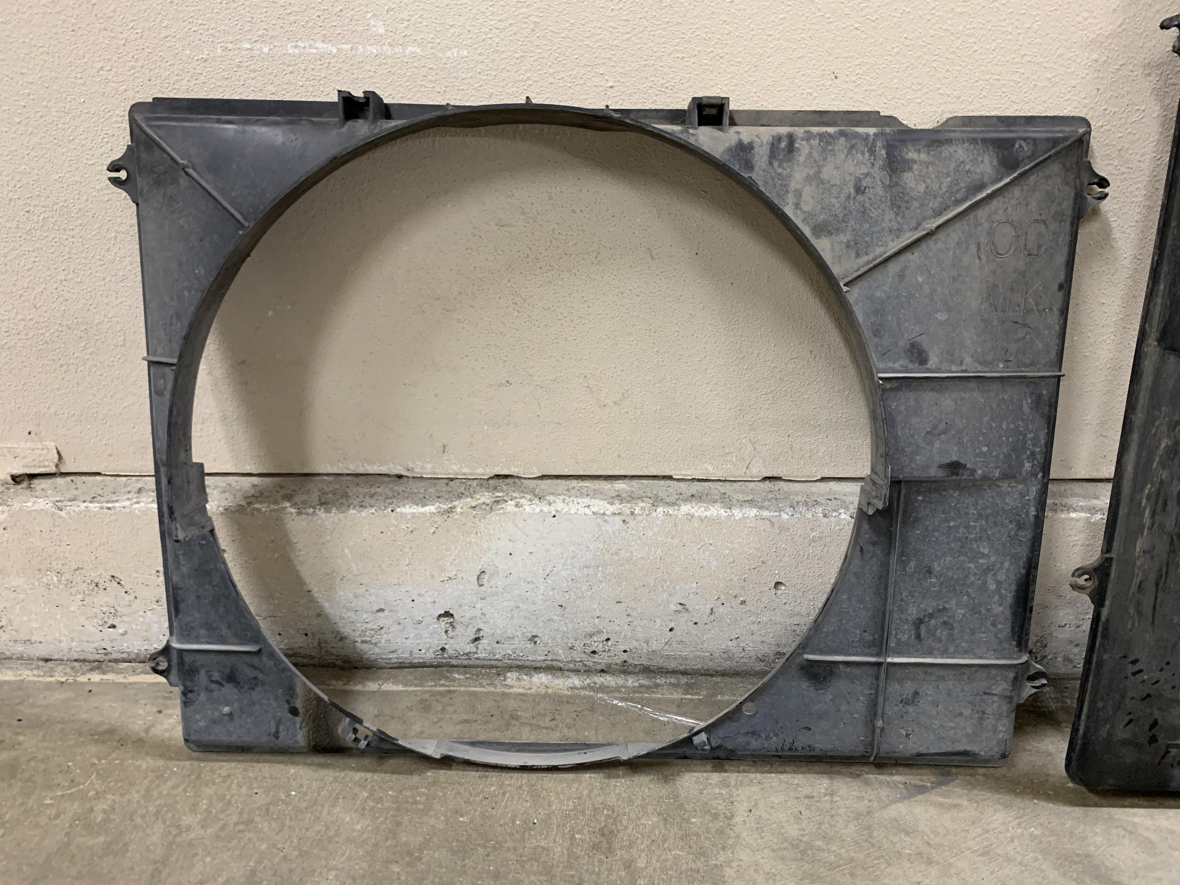

Step 4: Modify fan shroud cuz the 1 that I thought was correct wuz for a 2.7. I had leftover resin from before, so I’m waiting for it to dry.
Here’s the picture of the 2 fan shrouds. The shorter of the 2 is for a 2.7 and the taller 1 is my 3.4. I cut 3” off the taller 3.4 shroud and used resin and fiberglass.

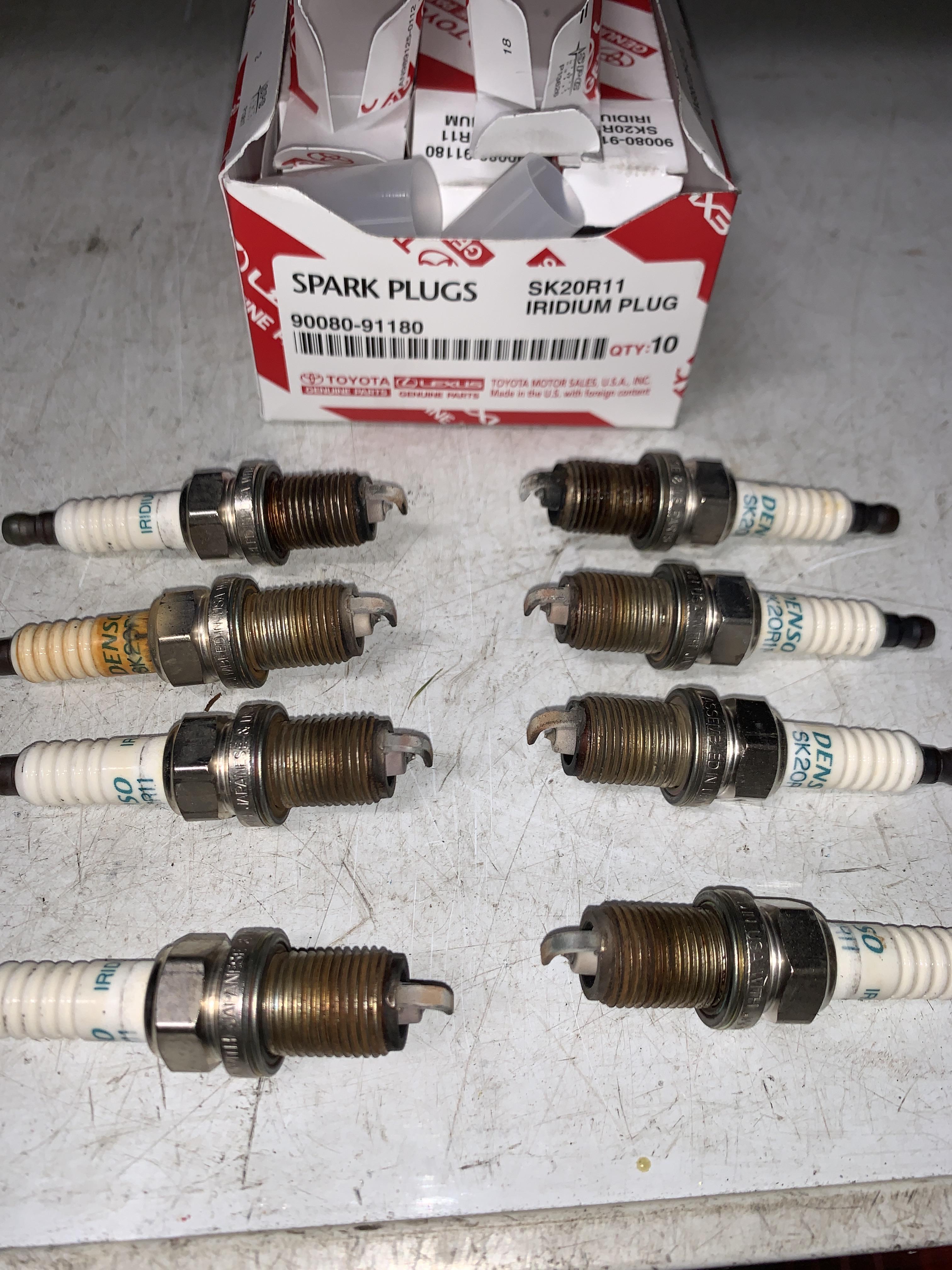

Nothing special on my truck, but my wife’s 07 Limited Sequoia had sum spudering when accelerating. Here wuz da problem

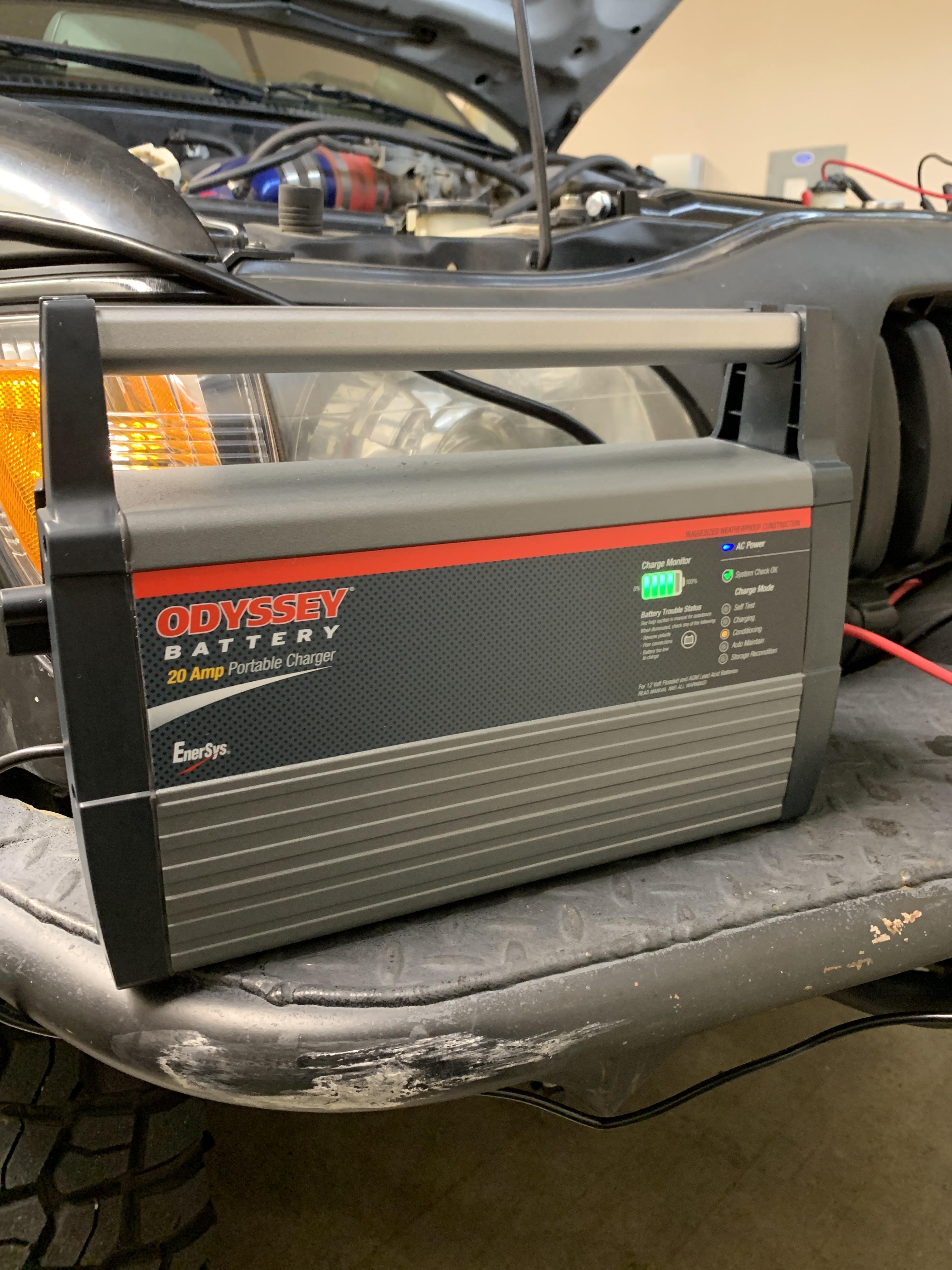

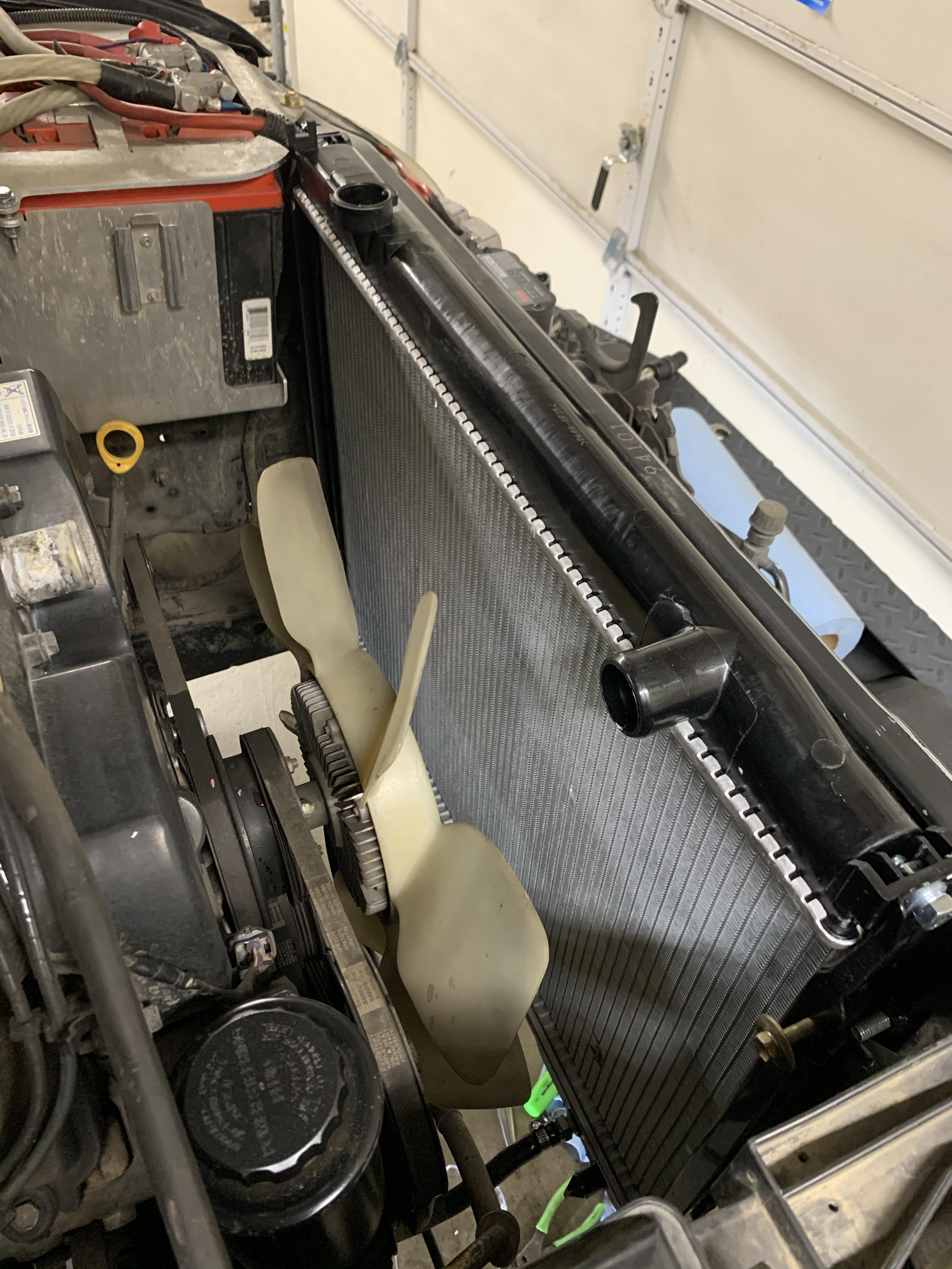

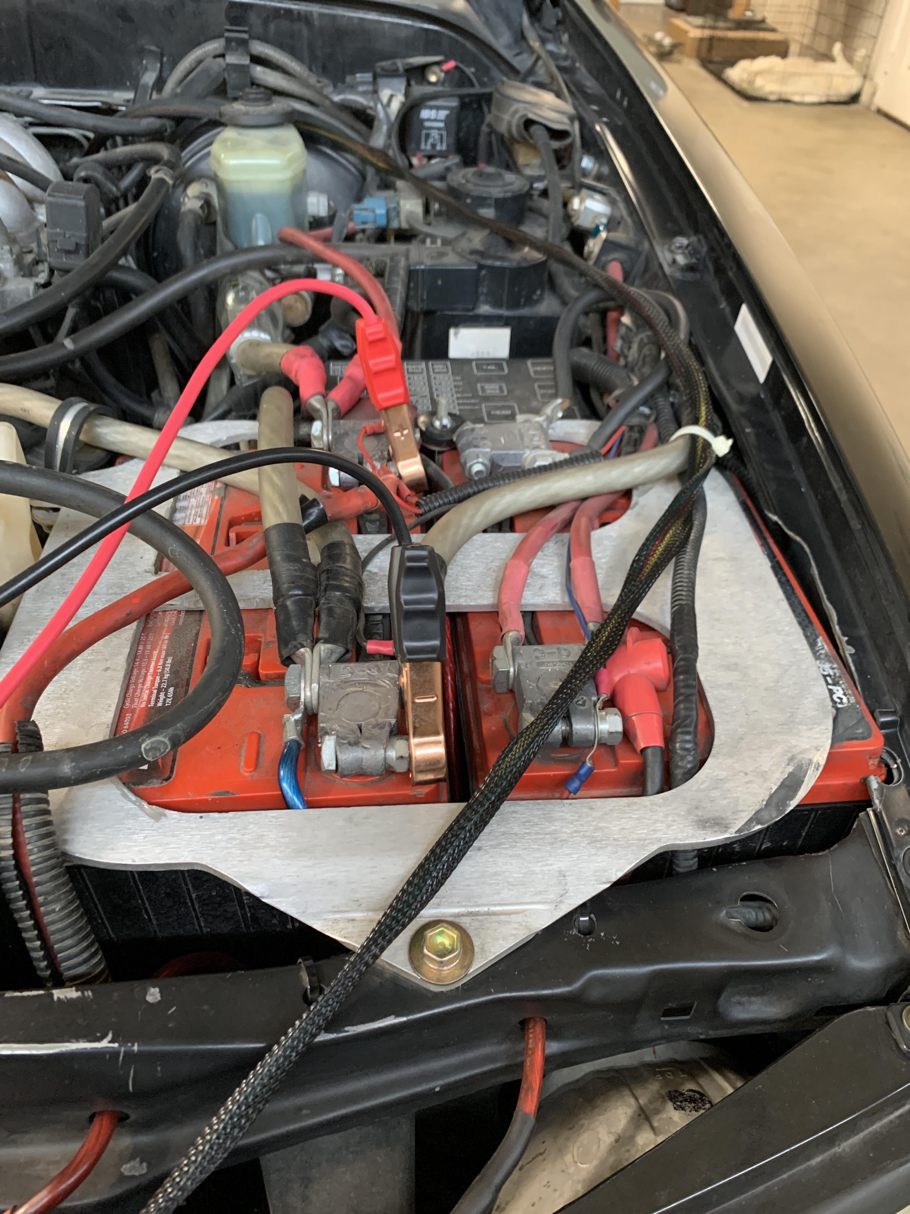

Did those batteries just barely fit between the headlamp and the fuse box? Can’t tell if you moved the fuse box back from the pics. Wondering if I can squeeze my battery that direction but it’s a little longer then yours
