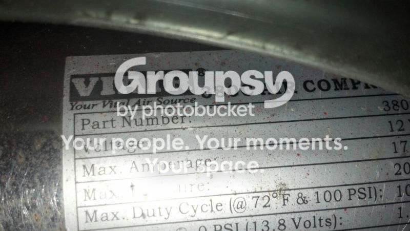

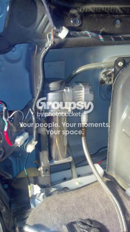

Also started on another project. It's and VIAIR 380C compressor. I just got it mounted and will be wiring it up when my 3gal tank comes in. Got it used for cheap.
