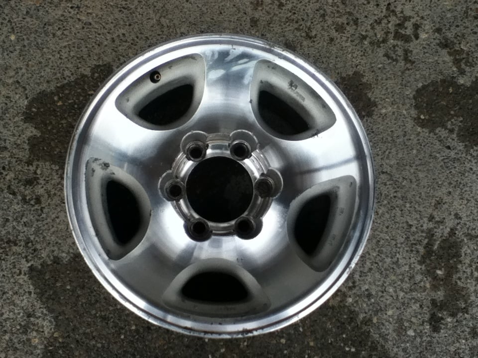

I had these in the shed for 3 months now. I just got around to cleaning them. The front rims had oil like no tomorrow. I cleaned as much as I could and will paint them. Thing is I don't know what color. I don't want to color them the same color as the LX450.
Here is the front rim that I spent most of my time scrubbing
