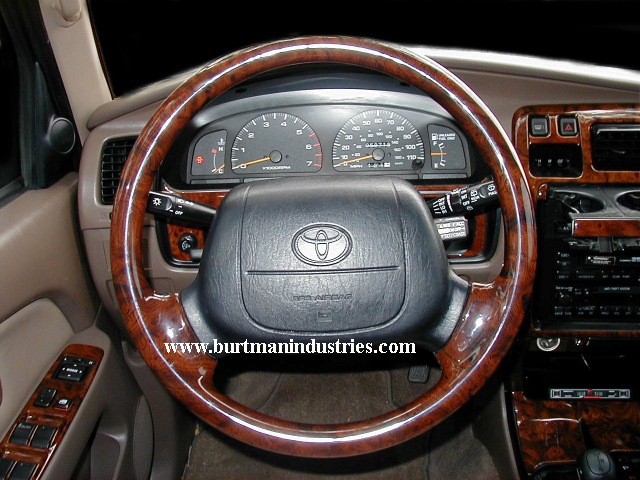

what LEXUS was this steering wheel swapped from> ?
was it a direct fit?.. do you think you could have kept the toyota center part and the wood grain steering wheel?...
def like this one
Yes it was a direct fit WITH the Lexus ES300 air bag. The 4runner bag would not fit perfectly. The mounting points were lower on the Lexus steering wheel. I tried to make the 4runner bag fit the Lexus wheel for 3 hrs. Took me 10 min to install the Lexus air bag.

Do you know the year ranges on the ES300 that would be compatible or at least the year you got yours from?

That looks great! This is what I did on mine, but this isn't real wood and the factory discontinued it. I'm fighting with them to make it again. As our trucks get old, the leather rips apart.
That wheel looks to been in good condition based on that pic. I can't find any around here that aren't cracked on the wg. What did they charge you for bag and wheel if you don't mind me asking?
Mines was from a 2001 ES300.
$40. $20 each item. I have a good junkyard and sales guy!
