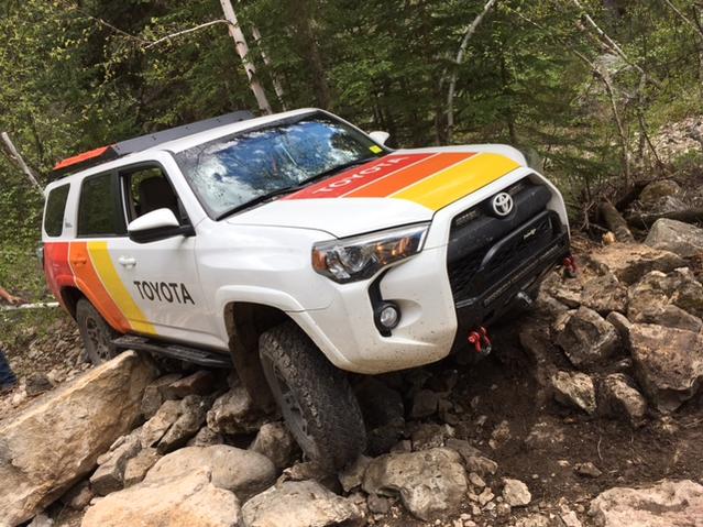

As pictured, we filled out the lights in the bumper. We went Rigid fog lights for the DOT compliance and an Oz-USA light bar. The Oz got good reviews and came with a nice harness. I swapped out the switch for a MICTUNING Toyota style switch to keep things consistent inside.
I also picked up a Factor 55 Flatlink for the winch; something I never even bought myself for the Jeep. Something about the 4R just makes me want to really keep things looking tidy.
We're looking at roof racks right now. Gobi is the gold standard, but a bit out of our range.
Our current pick is the PrinSu Design rack. We're trying to decide between a full rack and a 3/4. But we have to pick something within the next couple of months since we'll be making a circuit around the four corners and will include a bit of camping (and some Moab).
The final item on our list is lift, but I'm trying to decide if I really want to mess with X-REAS or not. I know it's not crazy to "deactivate" the system, but I'm wondering what kind of handling difference there is without it.

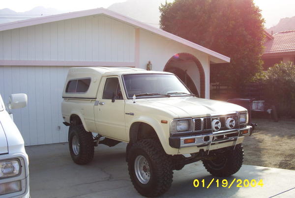

A 5th Gen in OG Ivan "The Ironman" Stewart race colors would be glorious. You have an opportunity here. I'm just saying.
DSC01433.jpg~original
edit: apparently that was a 2wd Ford Ranger with a 4Runner body that Stewart would drive for pre-running.

Sooo, after this weekend, I might be rethinking this. We were out on a pretty aggressive trail and the antenna got bent. So I straightened it the best I could without breaking it and later on, it got bent again.
That location does seem a bit prone to damage from branches, but I can't think of another place that might be less vulnerable for a 1/2 wave.
