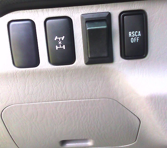

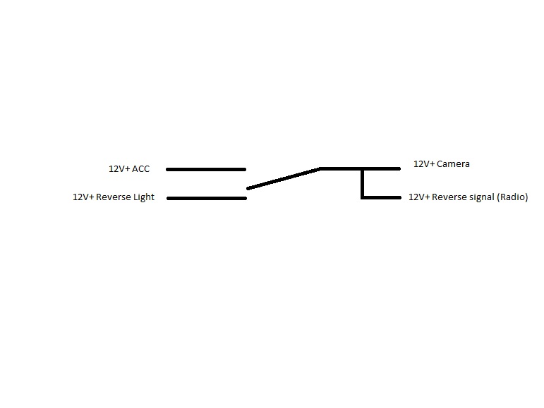

The following SPDT switch was used for my installation. Other people that have used this switch stated that the hole had to be enlarged for the switch to fit in their 4Runner dash/interior panel. The hole was not enlarged for the switch to fit in my 4Runner (a snug fit though). The image of the switch in the dash is re-posted below from one of my earlier posts in this thread. The circuit is below also.

Correct. The 12V+ Reverse Light wire was tapped near the driver's side reverse light. The 12V+ Reverse Light wire was installed with the video cable of the backup camera and the 12V+ Camera wire from the rear to the front of the 4Runner along the driver's side under the interior panels. I have noticed that other folks on this forum have tapped the 12V+ Reverse Light wire at the front of the 4Runner, but I decided to tap it at the rear of the vehicle. Based on my memory, the 12V- (ground) Camera wire was installed to the front of the 4Runner also (connected at the head unit wiring harness to the Metra 70-1761 splice; Black - Chassis Ground), but my memory is fading on some details since the installation was several months ago. The 12V- Camera wire could be connected to the vehicle chassis or tapped to any other ground wire, but I was trying to minimize the number of taps into the stock vehicle wiring. The cables were taped together every 2-3 feet to keep the cables together behind the interior panels. I also recall that a couple of places behind the interior panels had small openings which made it difficult (or impossible) to pull the cables taped together; so you may want to wait to tape the cables after pulling them all from the back to the front of the 4Runner. Or you may decide to skip taping them. My goal here was to securely keep the wires under the interior panels for the life of the vehicle.

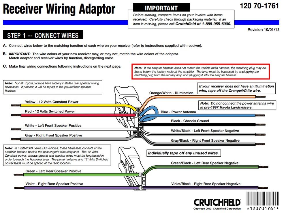

The 12V+ ACC wire to the backup camera switch was tapped at the connection of the head unit wiring harness to the Metra 70-1761 wiring harness since a splice was needed there anyways. I could not find a manual for the Metra 70-1761 wiring harness on Metra's website, but the web link for the Crutchfield manual on this wiring harness is below (and a screenshot of the wiring harness from the manual). The manual states that the "12 Volts Switched Power" (aka 12V+ ACC) is the red wire on the Metra 70-1761 wiring harness.
Crutchfield manual for the Metra 70-1761 wiring harness
