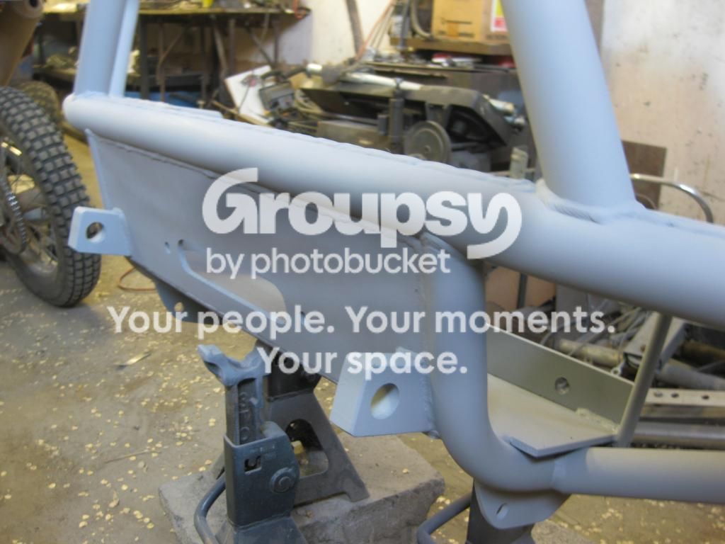

if you don't already know, our frames aren't very strong right at the front. they don't really take well to heavy winch bumpers, without a bit of help.
I built a couple mounts. I just cut some square tubing at an angle, and welded a nut to the back side. there really isn't any access to hold the nut in place, so it needs to be welded.
now that we have the extra mount, we need to beef up the front of the frame using this frame plate.
I built this one out of some 3/16" steel I already had. Badlands does sell this plate prefabbed in 1/4" if you want to save the time.
I drilled some holes in the middle, to give me a place to weld, make sure they land in between the holes in the factory cross member.
all welded and ground flush.
the bumper is beefy, and well made, but there was one spot I felt it could use a bit more. under the inner edge of the top plate, there isn't any support, if for some reason I needed to stand on it, it wouldn't support my weight.
I had some 1/2" round stock, just right.
and welded in place.
nice and solid now, that top plate isn't going anywhere.
a quick coat of primer,
the final product.
with the winch mounted.
IMG_0335_zps793139c6.jpg~original
I got a pic of the lower mounts this morning.
so with my 2 extra mounts, this has 8 mount points. it should be plenty strong.
