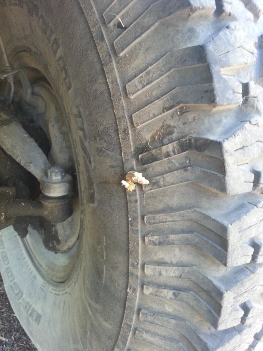

took the 85 runner up to scout a bit for hunting next month. no trails really, just some old logging roads.
still managed to do this.
I don't have a spare...
luckily the other guy that was with us had a compressor, and was able to air it up. we had to air it up every 10 minutes until the stick came out. oddly enough, it leaked much more slowly after it came out.
we had to air it up 4 times, to make it about 30 miles.

Need to carry a plug kit! Saved my butt many times.
Hyde - plug kit and butt should NEVER be used in the same post. EVER!
:eek:
However Hyde is correct - a "Tire Repair Kit" is cheap insurance. Along with an airpump (Slime is a nice cheap emergency air pump)
ive thought about getting one many times, just never did it. this is the first flat ive ever had. well, I guess the 2nd, but the other one happened as I pulled into the driveway. this is the first time ever getting a flat out on the road somewhere, away from home.
I will probably pick up a basic plug kit. it would have been nice to have, we could have finished our day, instead of hauling ass home.
