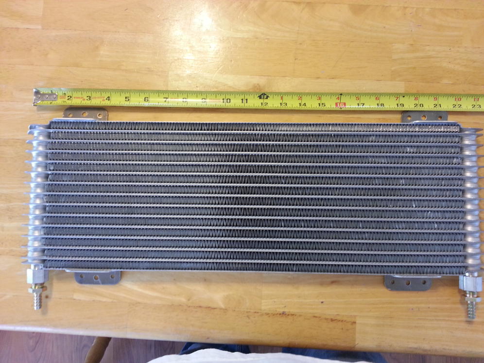

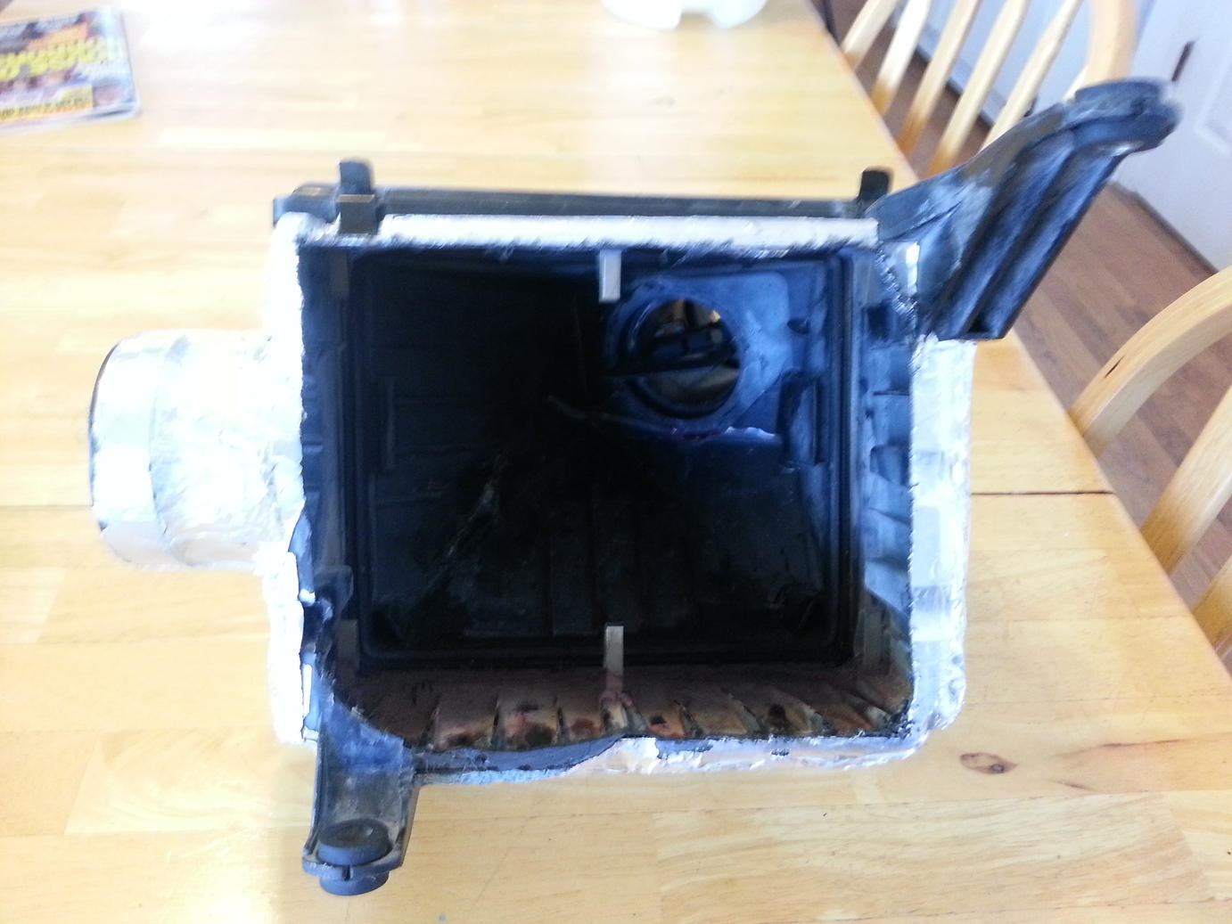

I cut my air box some more I think the deck plate mod was still restricting it. And my new transmission cooler came in its huge!

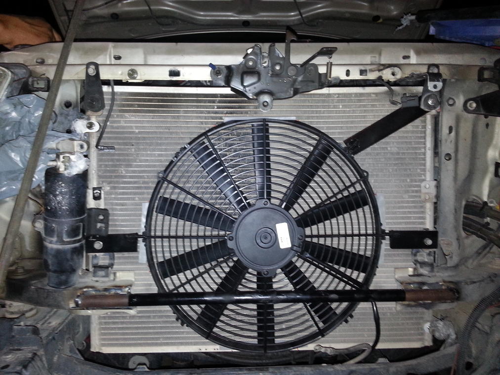

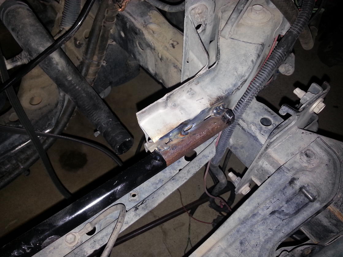

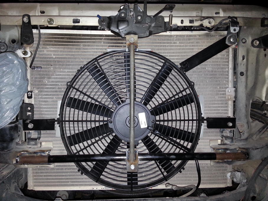

Pusher fan is done its pretty solid came out really good. Cross brace is done too its a 3/4 .035 chromoly bar. Tomorrow il be finishing up the support bar that supports the hood latch from hitting the ac condenser also il be mounting the transmission cooler.

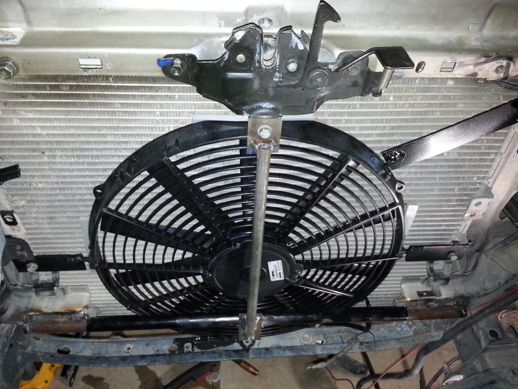

Finished up the center support bar to support the hood latch. Its a 1/4 chromoly bar .200 wall thickness so its pretty strong it came out really good its super rigid shouldn't be worried at all dropping the hood shut.

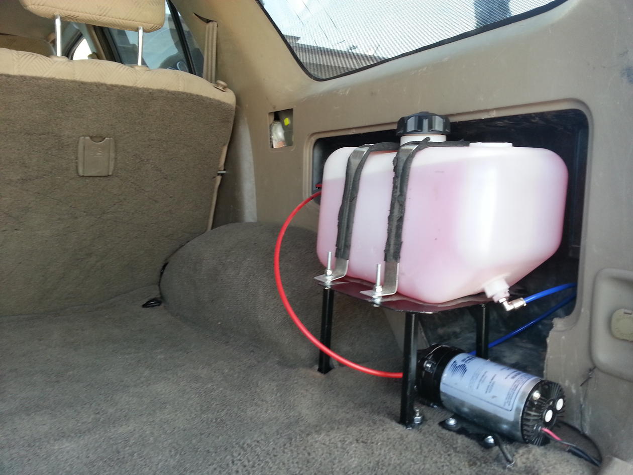

5.) Why did you decide to mount your water/meth reservoir in the back of the truck instead closer to front? No room?

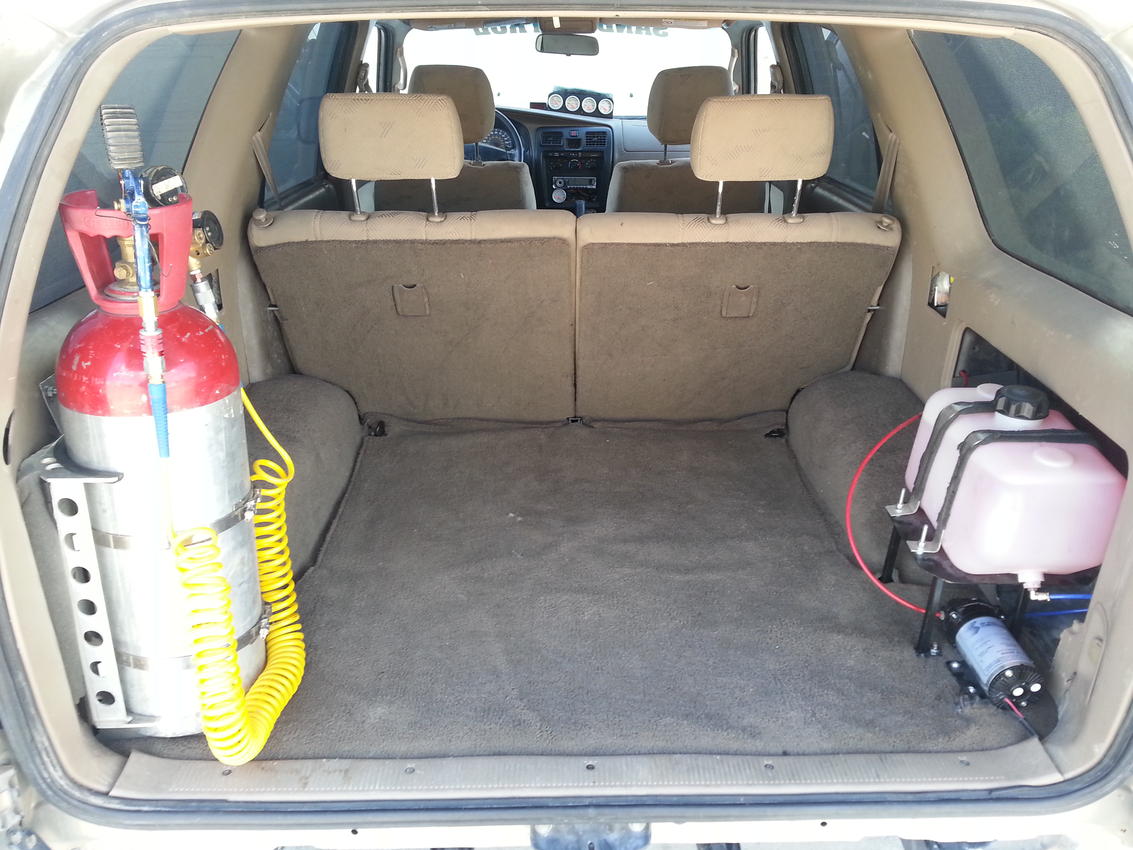

1. Yes it tops out at 10 psi I am not running any fuel mods at all. All I did was rebuild my stock injectors and there flowing at 50 pounds.
2. Im not sure on the flow rate I think it says on the snow performance website. On the pump it says max psi is 300 psi.

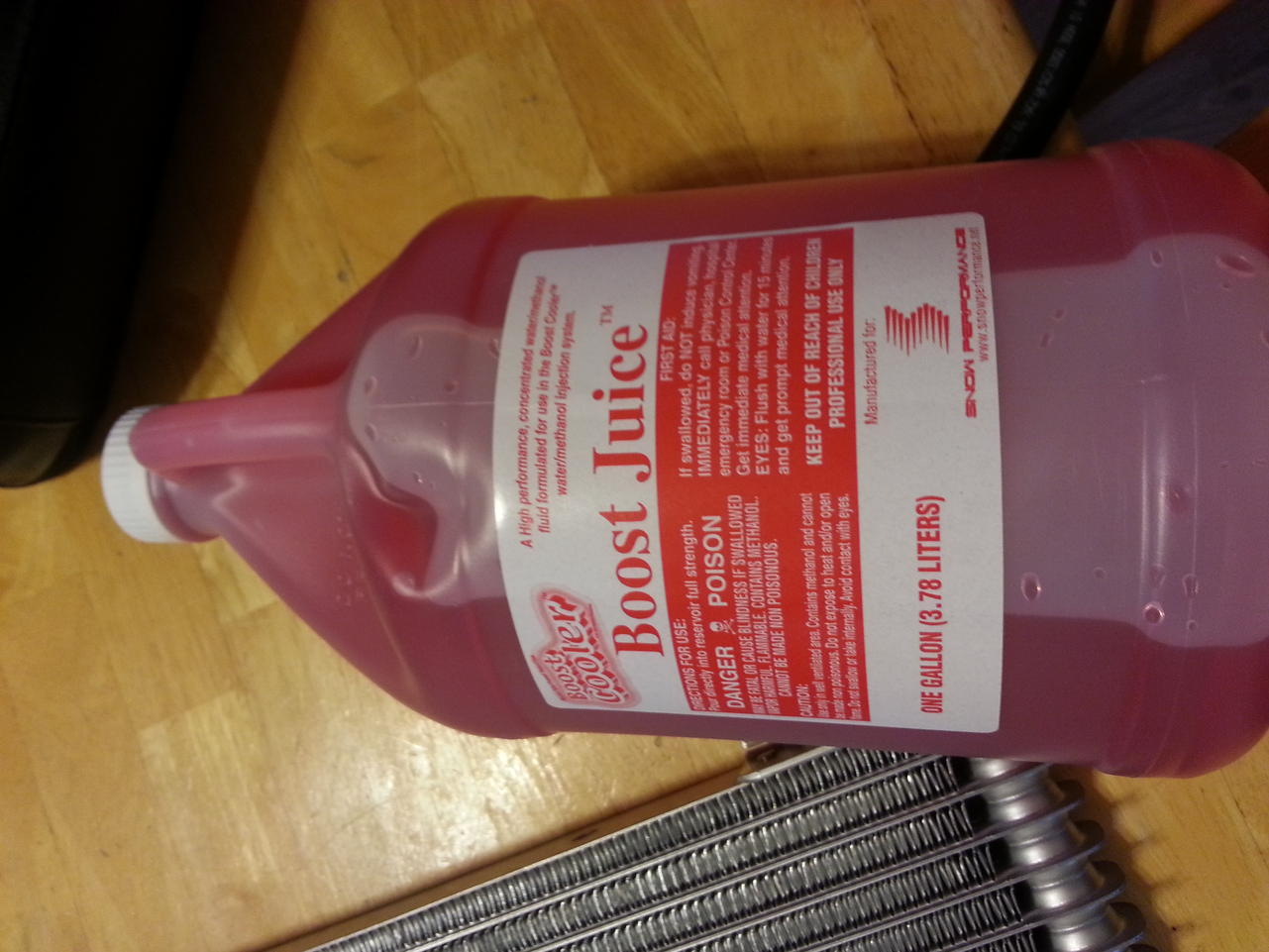

3. Im running just straight boost juice no water heres a pic.
4. I dont know what kit it is my uncle ordered it cuz he has a friend there. It cost 400 $ and 50 $ for the 2.5 gallon tank.
5. I decided to mount it in the rear because its pretty big didn't fit up front but also because of weight. Im moving everything to the rear battery, fuel cell, 20lbs co2 tank and hang the spare off the back like a jeep.

1.) I've heard some people experience occasional knocking with the stock TRD supercharger running 7psi. Since you're running 10psi with no fuel mods, is it safe to say that the meth injection is your sole method of fighting knock? If you were to disable the meth injection and still run 10psi, do you believe you would experience bad knocking?
2.) Is "boost juice" straight methanol? Or is it a water/meth mixture? How much does it cost?
3.) How often do you have to fill up your 2.5 gallon container? I guess it depends on driving style, and how much you're into boost. What has been your typical time between refills?
4.) Do you have an indicator light that comes on when your kit starts injecting? A light when fluid runs low? Can you hear the pump when it's working?
Thanks in advance!
meth questions
Don't quote me but I believe "boost juice" is 50/50 meth-distilled water. Running straight meth you may have to worry about a fire if you get a leak.

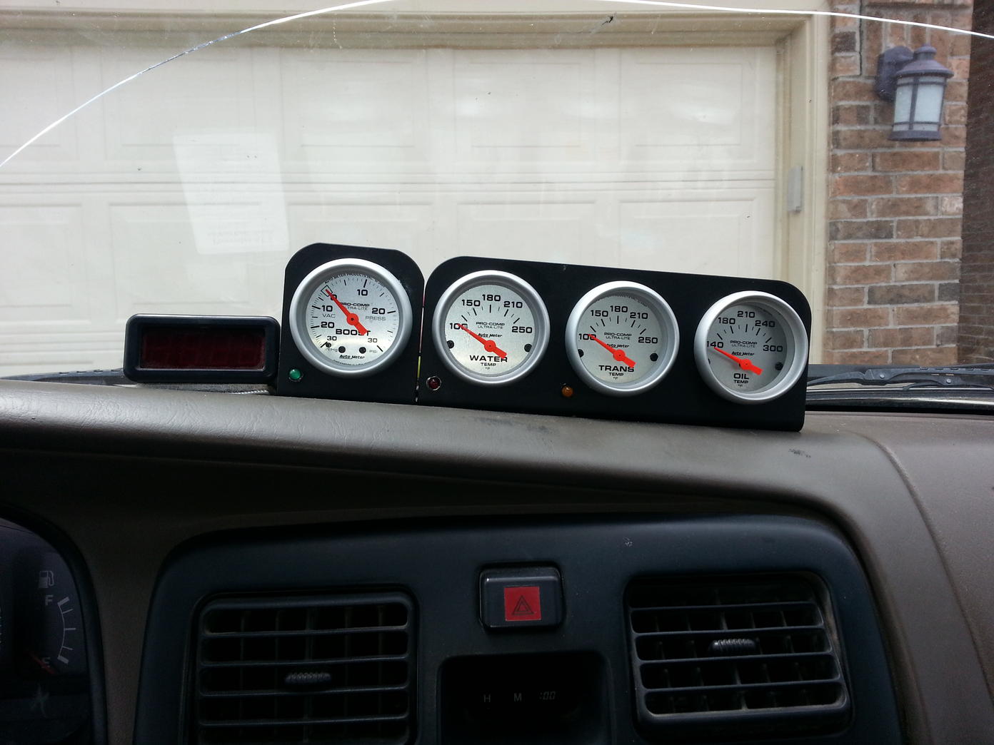

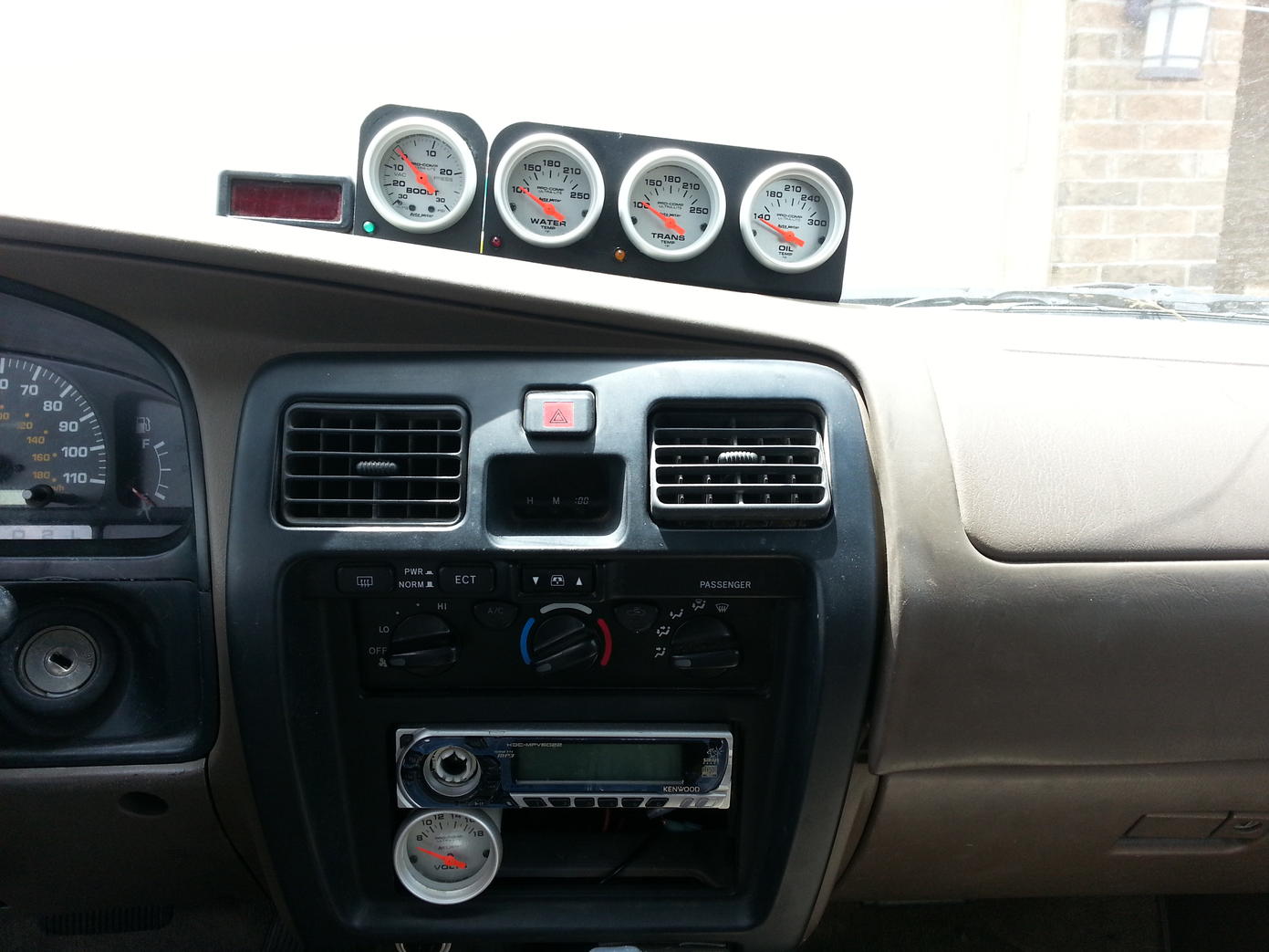

Moved the gauges to on top of the dash. All gauges are fully functional digital air fuel ratio gauge, boost gauge, water temp, trans temp, engine oil temp and lower gauge volts. Green led indicator for meth Injection, red led for engine fan, orange led for pusher fan.

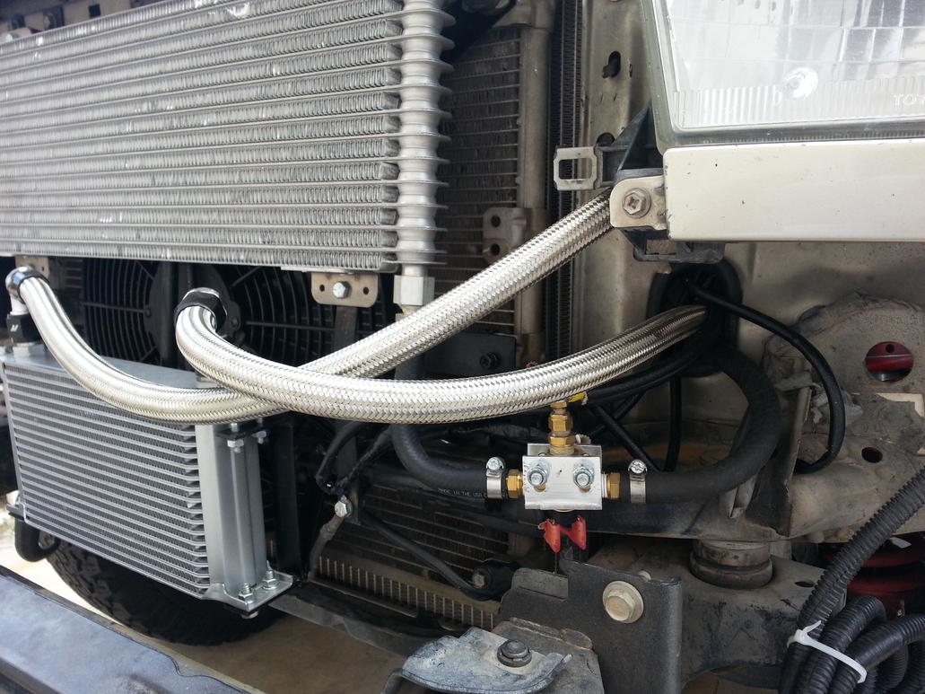

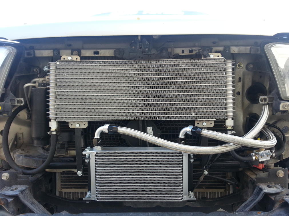

I got both coolers working trans cooler is working super good runs cool even when running hard. I also hooked up a thermostat switch threw the transmission hose to power the pusher fan at 180 degrees. The engine oil temp is really high 240 to 260 I ordered a bigger cooler and I will be mounting a small 9 inch fan on the back of it.

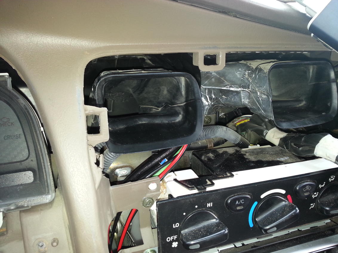

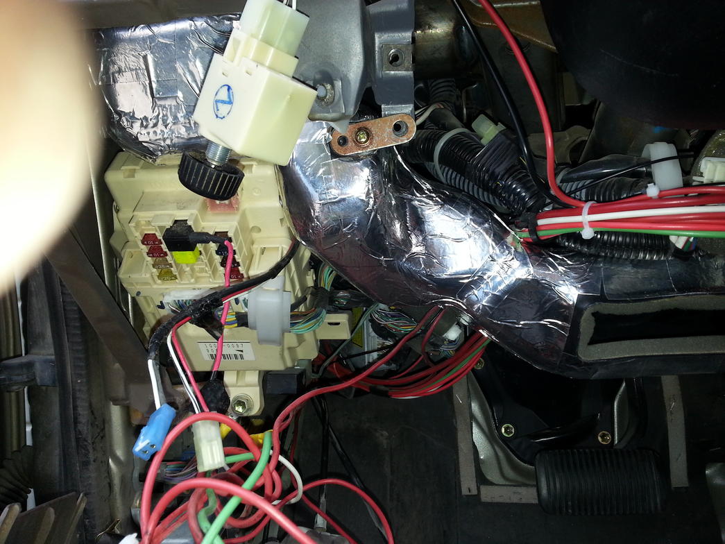

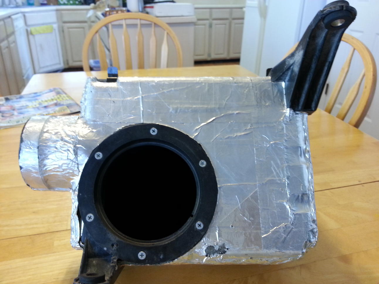

1. Heat taped all my air vent with aluminum tape.
2. Lined the bottom with silver roofing material. I forgot to take a pic when I was done.
3. Replaced all the stock foam insulation.

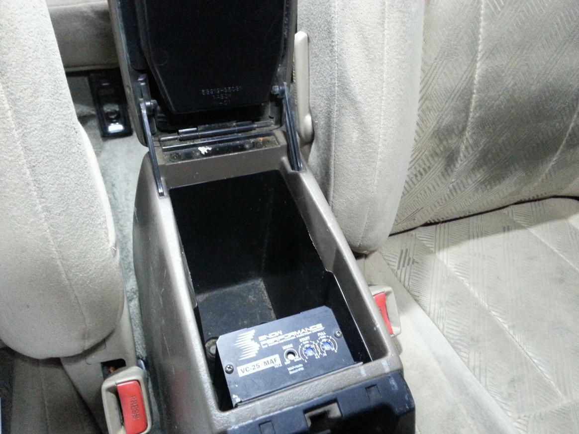

Relocated my meth injection control box to inside the center console for easier fine tuning now that I have the led indicator light hooked up and also to keep it out of the elements under the hood.

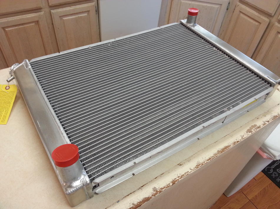

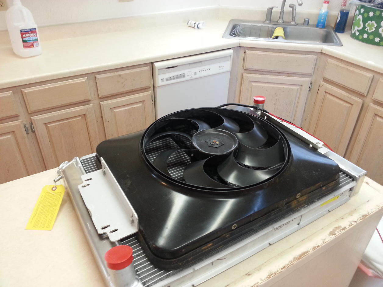

Stocked up on my methonol. And heres my project that im working on right now installing this fat 3 inch thick aluminum raidiator 28.5" x 19".

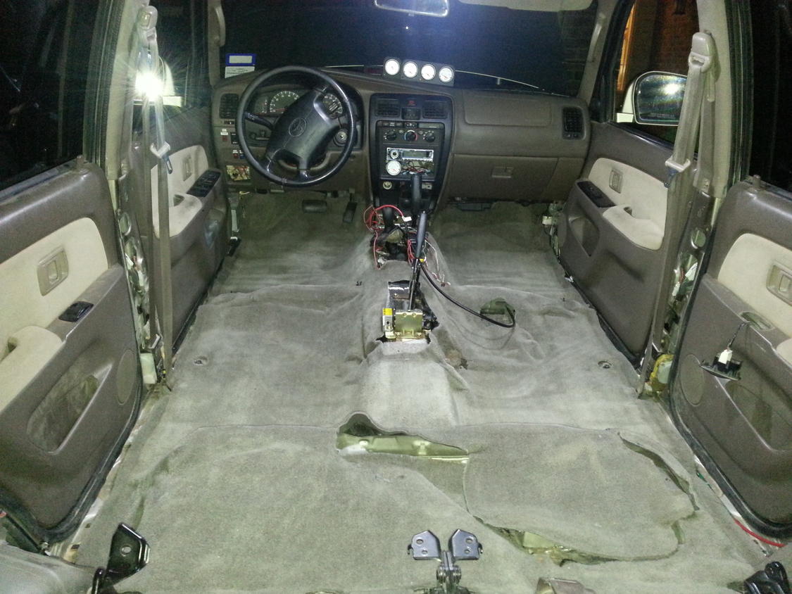

Finally put my rear carpet back in today it looks so much cleaner now.
