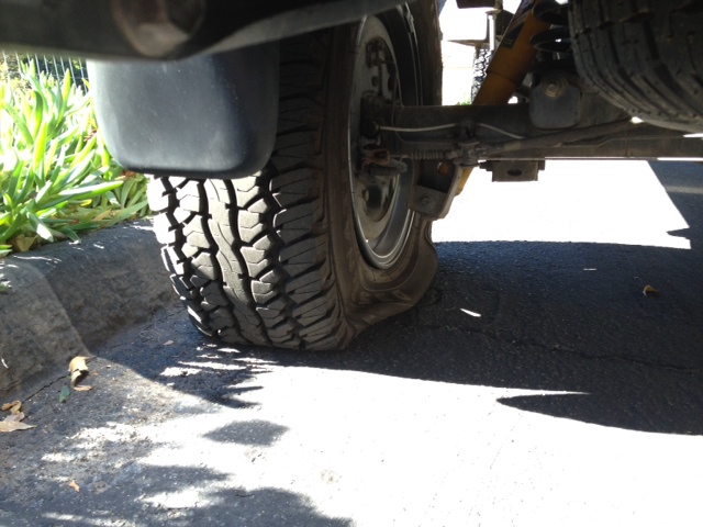

At about 10 this morning I was mountain biking, probably 15 miles away from my house. Then my ride was interrupted by my Mom calling my phone. She said "The weirdest thing just happened, I heard a gun shot, so I went outside, and I heard a whistle. It was coming from your 4runner tire, now there's a big hole in the side of your tire." So naturally I thought my 4runner was just shot, in my own driveway. I went racing home. I examined the tire only to find a giant hole, but it was in a perfectly straight line, like a seem. I went to firestone because that is where I bought them only 2,000 miles ago. Of course they said "Looks like you hit something to me, and you didn't buy the warranty. Let me see if I have one in stock." So now I'm out 200 bucks for a defect in my tire.

Dude I won't be the only one to tell you this: don't buy FireStone tires. I have never heard of that happening with a Michelin or BFG tire.
The tires could not stand your redneck ingenuity for the bumper fix, and decided to up you one on your game.
In all fairness, I have seen a BFG blow a side out and the tire right off the rim.
It was most likely a manufacture defect, but good luck on getting them to fess up to it.
Even if you did hit something, a good all terrain tire should be able to handle a light sidewall rub with out exploding. I know my BFG's and Falken's have both been rubbed on rocks and neither have had an issue.

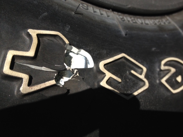

If your tire was shot, you would either have another exit wound or the bullet would be in the tire somewhere.
I'm guessing you found neither of these so i'm gonna go ahead and say that it wasn't shot. Bring the tire in and show them how it burst. i bet you get your money back for the new tire.
Not to mention that where it burst is right in the middle of the lettering with no signs of any damage around it. If hitting something caused that, you would most likely see some scuffing on the lettering.

What others have said. They just don't want to be out a tire. The burden of proof is on THEM to prove that it WASN'T a manufacturing defect; and to me it certainly looks like one.
For the record, my wife actually DID have this happen while clipping a curb at like 5MPH. Took it to the tire shop, and they asked one question - "If we wanted to, could you provide proof of how fast you were going?" Wife told them "Yes - I had a coworker in the vehicle at the time, plus the 2 guys behind me who stopped to help me out."
They replaced it free of charge. :)
Tires are pretty tough. If something pokes a hole there really should be some marking around it, no?
