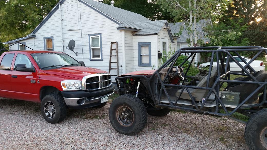

Nice, I scored, too. 07, 5.9, 6 speed, rebuilt. That and my yota buggy and I'm good to go!

Right on, looks like fun. I purchased a built Comanche for wheeling I don't do, restoring a 69 SS Camaro and I built a foxbody about 5 years ago now. Made 1038 whp on race and 890 on pump. Can't seem to kick the car habit, I also built a dune 450R and Raptor 700R (now stroked/bigbore 996).
Someday when I have more free cash/the 4runner is finished, I'll tinker with it again. I barely was able to pay mine off and now it just sit's unless I make money with it. The diesel that is.
I did a small lift and wheels/tires on mine. It's just kinda too much for a daily or I probably wouldn't have got anything different.
