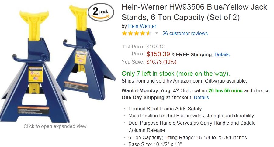

I really like Hein-Werner stuff but these don't have a pin for backup. The Torin's do, and they are a pretty good price... I think that might do it.
Does anyone know the minimum height to get the tires off the ground for this set up? I don't want to push the limits of the stands if I don't have to.
torin 6ton from Northern Tool can be had for under $40 with a sale and coupons. They can handle the height.

23" is the farthest the Torins will go. Other than the HWs that Brian just posted, I can't tell ya the rest.
If you get a Torin, or HF set, pull them out of the box and inspect them at the counter before buying to make sure the welds are good.
6 tons will work fine and I have the Torin's as well. I'm going to pick up a set of 12 tons soon though since I don't like extending the stands a lot and that way it will be a bit safer. 12 tons are a bit excessive though for a 2" lift unless you have the cash around.
