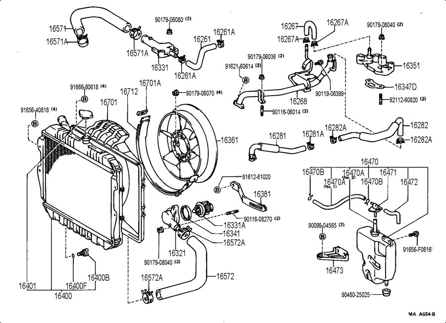

I have a 95 toyota 4 runner 3.0 liter and there is a 90 degree hose leaking at the back of the intake. Cant reach it without taking off the upper intake. Could someone give me a part number or a better description other than bypass hose which it isn't listed that way. I have a pic from a members page that shows the hose coming from the block and hooking into a metal pipe

I believe you are looking for the water bypass hose #3, part #16267.
mikedks thanks for the reply. Noone could find the exact part number. I work at a parts store and none of the books or hose diagrams on the computer show the exact part number. Went to the local yota dealer and it was a major fail. Well I got it ordered today with your help and will put it on next week when it comes in.
Put a request into our tech dept that overseas our data base and talked to a tech which told me he knew about the problem and would have it fixed in our data base.
