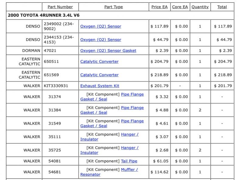

I did a a-z replacement on my Cali emissions 2000 Sr5
This is the parts list I ordered form Rock Auto,
Def has more power and runs smoother,

Thanks jjf8. Did you have any gasket issues between the Eastern Cat and muffler pipe? That looks just like what I was going to do actually. I am planning on buying the Walker muffler and pipe locally at Advance.
I bought the walker cats and they bolted right up on my rig. Walker 53616 & 52399. Amazon’s part finder says they don’t fit so you have to use Walker’s part finder. I installed the whole Walker system plus Denso sensors back in 2017 and they’re still going. Be sure to spay the walker parts with some high temp paint. They have a tendency to rust quick.
Edit: looks like the second cat has a different part number on the ‘02 vs the ‘00. Here’s the parts list...
