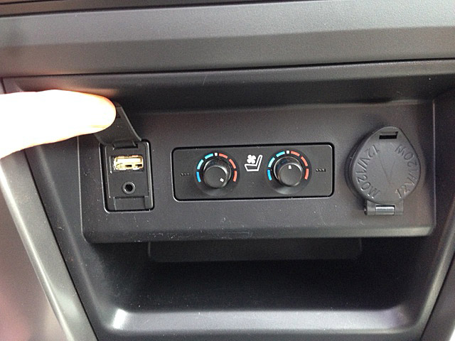

Need Pics of you USB Port ASAP Please
TOY2G
I am working with PAC for a solution to keeping my OEM USB port (the one under the head unit). But they plug they have listed as fitting, does not..
USB-TY2
it appears to be designed for vehicles with the USB port only and mine has both USB and AUX on the plug. I need to see what is the norm and where the split is.
So please post a pic along with year and trim
Thanks for the help.
My USB port is in glove compartment and it's standard since I can easily connect USB key or a standard USB cable in it. But AUX is in centre console under head unit. I can take picture later today of course but USB port is the same one we have on computers - nothing unusual really.
'14 LE.

Damn - you've got seat heaters AND coolers...!!!
I definitely like that position for those controls vs. the US models sitting just in front of the middle arm rest/storage box.
The US version is basically the same with Aux in the center console and USB in the glove box.
so you do not have one at all under your HVAC controls? Interesting.
That was one of the changes for 2013. 2012 and older have the setup [MENTION=56372]scanny[/MENTION] described: AUX plug under the HVAC controls and USB in the glove box.

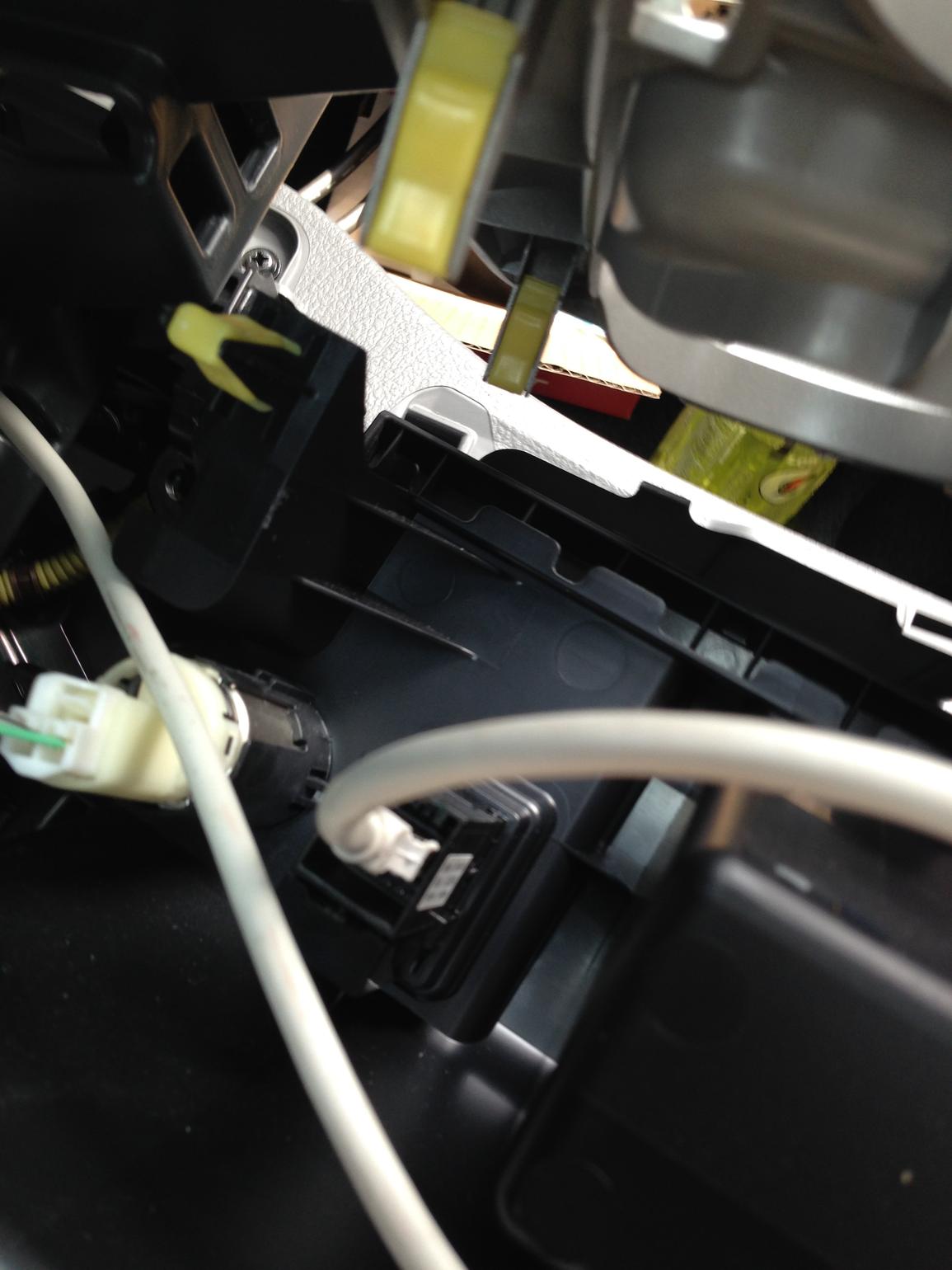

You don't need that cable, just need to modify a USB cable to fit -- I actually did this today on my 2013 4Runner. Don't cut the back of the plug like one of the people in the link I'm providing, just stick the USB cable in.

I used an old USB extension cable I already had. Just make sure to cut the metal off the correct side of the cable: Apple Genuine USB Mouse Keyboard Extension Cable 36" Long | eBay.
It, surprisingly, did plug in firmly. I planned on gluing it in place but I felt it was firm enough to stay in place and didn't want to ruin the plug.

Well.... I found a cable with two male ends, cut the metal of of one end, prayed the 4 contacts up a little to insure good contact....and nothing.

This is just guessing but I wonder if prying up the contacts was a good idea because it could have caused them not to line up properly -- maybe try plugging it in a few times to see if you can get them to seat. Also, I would try an extension cable before you give up. I feel very lucky mine worked.
I tried again with a new cable and still nothing works. I'm putting this one to sleep for a while.
