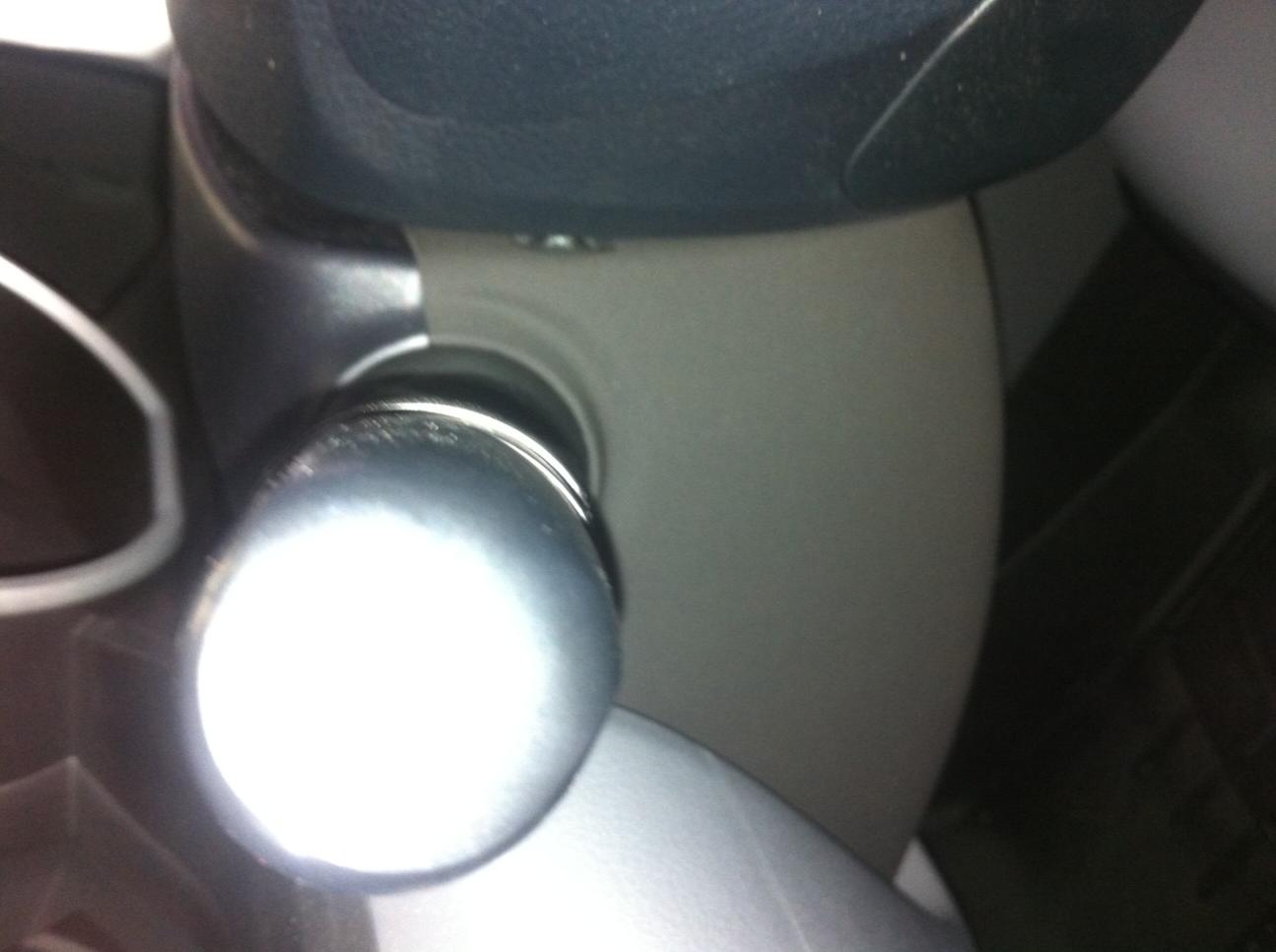

I put an aftermarket remote start/push button start system on my 4Runner SR5. I ordered a Limited lower shroud cover to hide the keyhole. The Limited one fits great. The only problem, the Limited cover that I received from Camelback Toyota is more of a flat black and doesn't match the black that is in my SR5.

The part number on the invoice is 45287-35410-C0
Here is a picture of it

There should be a number on your old one molded into the plastic
if the old SR5 number is 45287-35400 then you want a 45287-35410-C0
if the old SR5 number is 45287-60520 then you want a 45287-60530-C0
I'm not sure exactly what the difference is beyond there was a production change starting with vehicles built OCT 2010 (2011 models and newer). the one they gave you was for the 2010 model.
hope that helps.
