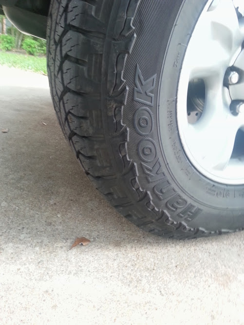

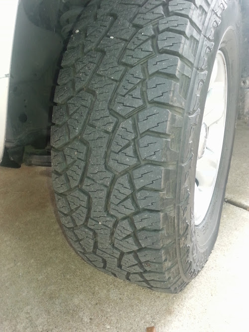

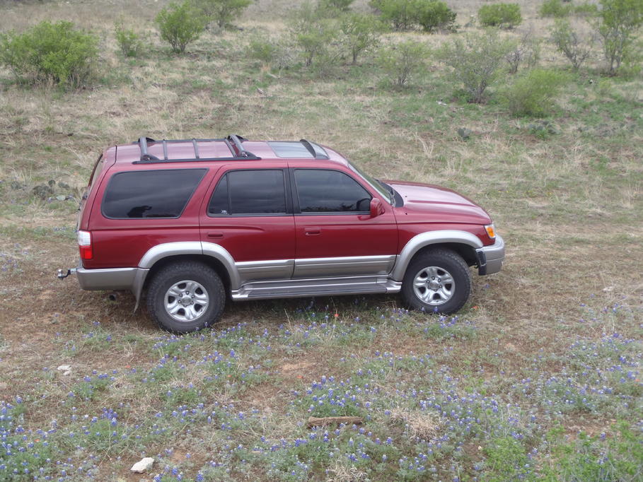

Hankook ATMs - inexpensive, very, very long lasting, smooth, quite, tough and won't make your truck look wimpy even though they're Ps. Many great tires out there, just another option. :banana:
