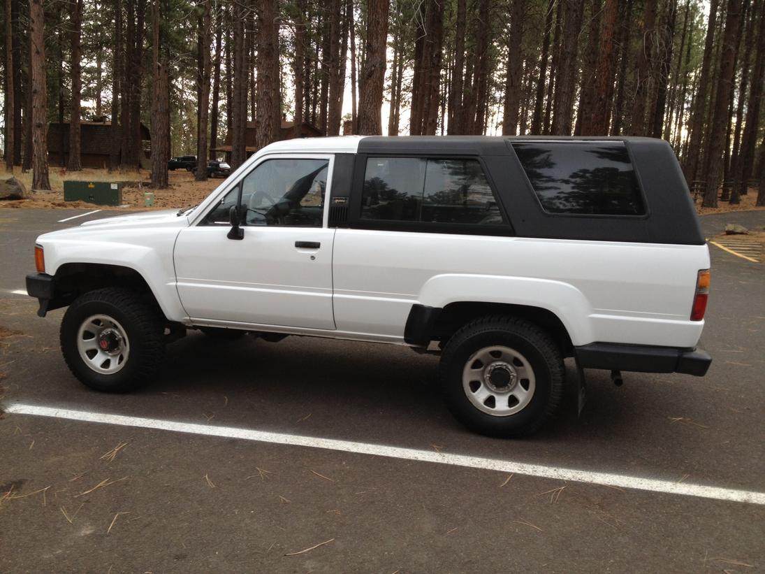

Hello all, I just picked up this 1987 22re with a 5-speed last month, and am getting ready to start upgrading a few things. First off I am going to be ordering some 12" x 125 lb coils for the rear and doing a zuk mod. Next up will be a set of new tires which will be mounted on a set of 16 inch Tundra/Tacoma twisted 5-spokes I picked up off of craigslist. My question is on what size to go with. I decided to do the 12" coils vs the 14" because I am trying to avoid bj spacers on the front and don't want a major front end rake. I have already decided that I am going to give the Treadwright Guard Dogs a try. Because I am going to be rolling 16's, I have narrowed my choices down to 245/75/16; 265/70/16; or 265/75/16. 30.9"; 31";and
32.2" respectively. Any specific advantages to any size vs another besides cost? Would the 245's be too small after the zuk mod? Conversely would 265's be look too big? Just looking for what other here are running and or your opinions and experiences are. I don't plan on lifting the rig, and it will mainly be used as my dd and as a camping/exploring rig. Let me know what you guys think and or show pictures of your set-up. Thanks in advance for the ideas and help.

Good looking 4runner!
