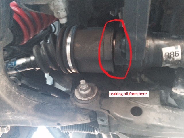

I install new CV's about 1000 miles ago. I was doing some work on the 4Runner yesterday and notice that the passenger side CV was leaking gear oil. I am wondering if I just didn't get the CV property seated or if something else is going on? I know these are the best pictures.
Picture 1 is the passenger side CV.

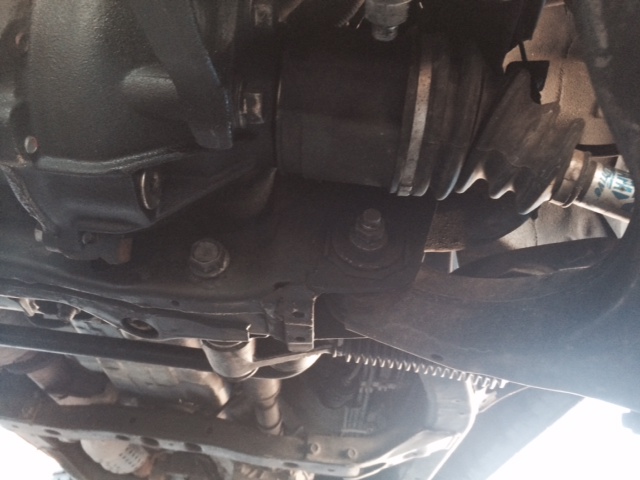

Picture 2 is the driver side CV (not leaking)

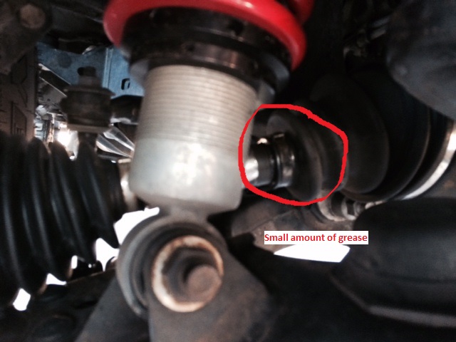

Picture 3 is the passenger side CV again, but showing the boot. It is leaking a little from here, but it looks more like grease than oil

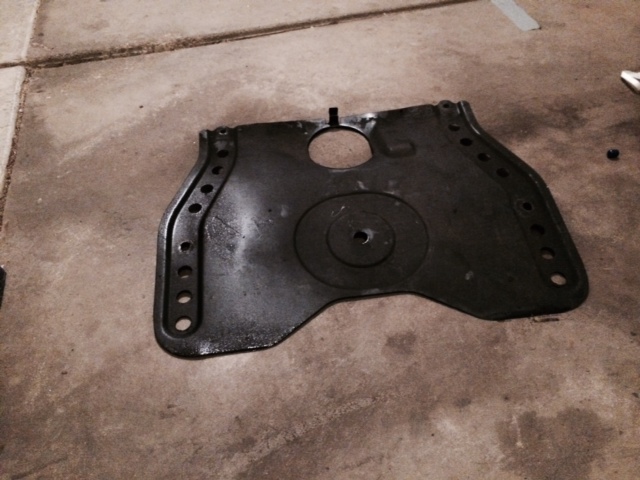

Picture 4 is the skid plate that shows where the oil leaked. I had degreased and cleaned this when I installed the new CV's.

It doesnt look fully seated but once it pops past the c clip its pretty much in there. To me the seal inside might have gotten damaged when you where installing the new CV. I bet the seal is bad and needs replaced.

Crap. I was hoping that it just need a little tap and it would seat and seal. However, the more I think about it the more I think you're probably right about the seal being damaged. One way to find out! Just wish it was going to be nice here this weekend. Hate not having a heated garage.
