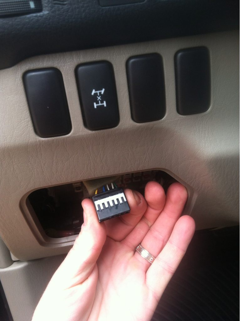

I also found this plug behind the lock differential button on my 2006. I thought someone posted that the '06 didn't have the plug?

Its srs off connector as you run sr5. Limited edition have button there. V8 connector is blue.
Anyway, I believe that is the same type of connector you need for fj button, but I prefer leave stock connectors as is, even if they are out of the use. It is up to you - you can cut it and use for the button to save some money.
It's so you can turn off your side airbags when wheeling. So they don't go off if you're on an extreme angle. you just don't have the button

To make it clear. That is NOT the same connector as V8 have. They got blue one with completely different wiring. The connector you found is for side airbacks off on Limited edition. As far you do not have side airbacks - you have no button for switching them off, but have redundant connector you found.

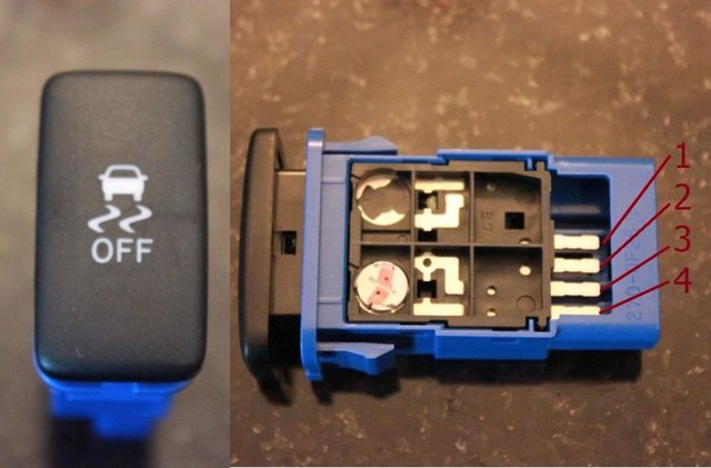

Okay, so I got my Toyota Swerve switch in the mail today and I'm hoping someone else can help me with the pinout. There are 4 pins on the back of the switch and I'd like to know if anyone knows what each goes to.

Pins 1&2 are for the actual switch, 3&4 are for the backlight.
This is pretty much true for all of the accessory switches that fit into slots like that, the six pin ones utilize a second light just above pins 1 & 2 (think the 110AC switch)
