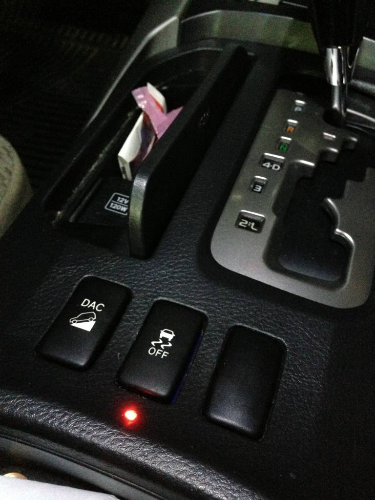

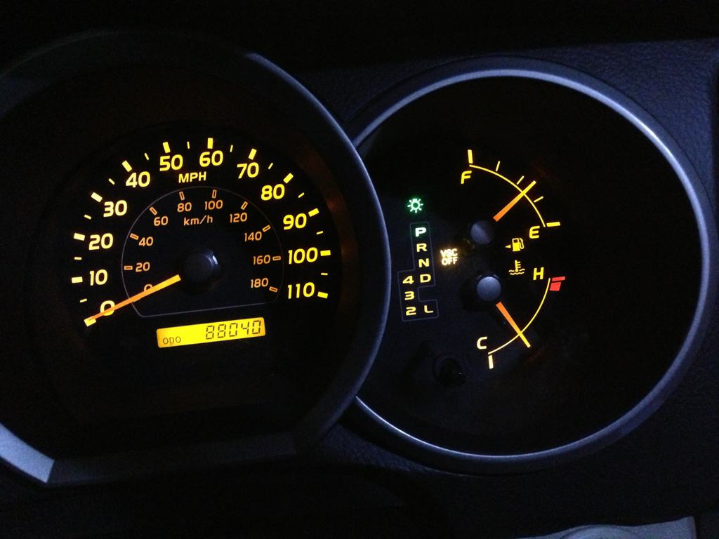

New fine-grained VSC OFF Mod for V6 1GR
Just got the kit installed. Took it around the block and everything appears to be working fine. So here's some pics.

So I understand correctly, the 05 V8 wih fulltime AWD and prewired switch connection, must use the same procedure Kliv and others produced to attain the VSC Off function properly, right? There aren't any shortcuts since the switch just needs to be hooked up to the prewired connection in the dash that allows this VSC Off mod work? I must still follow the directions of splices to attain function? Rounding up the splice connections and if not cutting any wires is possible I'd love to know...
If you want your dash showing VSC off correctly - you should follow the same installation. If you just need vsc switched off and can live with misleading lights on dash - just buy a button and plug it into existing socket

I've had my mod installed for a while now, but haven't really played with it too much. The "VSC OFF" lights up on the dash as it should in any mode. Over the last couple of days I've tried some different things and have some questions about the parameters in which this mod actually stops the "nannies" from intervening.
> "VSC OFF" in 2WD: One time I tried to break traction in gravel and the throttle cut out with some beeping. Another time, probably with more throttle, I stepped on it around a corner with some patchy gravel and really squealed the tires. Is there an RPM level or throttle position that overides the nannies?
> "VSC OFF" in 4WD (unlocked): I found some gravel this morning, stepped on it, and I really seemed to slide. It seems that in 4WD there is much less intervening.
