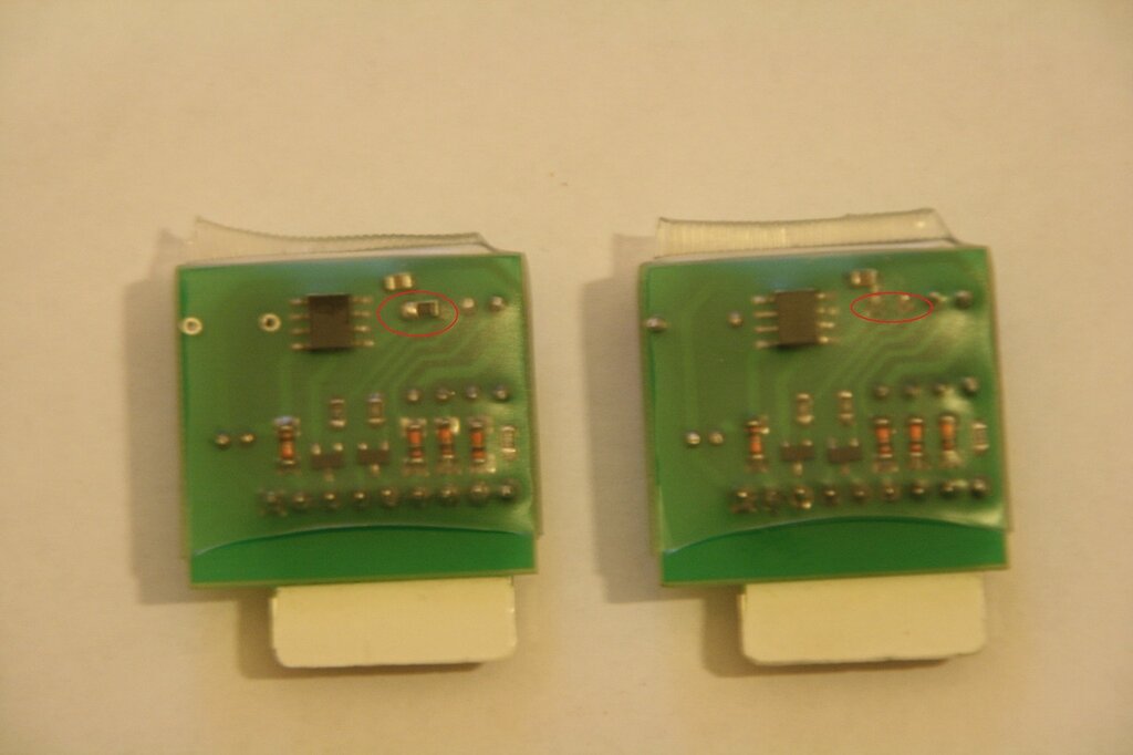

I finished the testing in different modes. The fix works.
If you decided to fix it yourself you just need to remove redundant resistor marked with red (Good one on the right). lexmedic157 did it. You may ask him about complexity of the action if you have doubts. In any case, I will ship you new unit if you return me broken one.
Took all of 5 mins to do it. Desolder the component and put some more shrink tube on it. Haven't had a chance to drive much though.

That resistor was wrong idea to make original unit better. Actually, that is the only difference in circuit comparing with the first item built and so called "old" units. So, all we did by removing the resistor is just make it the same as the first one. To be honest, I doubt I will think about improving the unit once again - it is in the shape it should be.

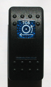

Can I use this switch? I have a bunch of these types of switches in my truck already and wanted to keep the theme going.
Product ID: V2DAA60B-00000-000
Manufacturer: Carling Technologies
V-Series sealed rocker switch, body only, no rocker
Details
* SPST Momentary ON/OFF switch.
* Single independently wired incandescent light.
* Rear barriers.
* Rated 20A @12V
This would be the rocker I'd get if the switch was suitable:
