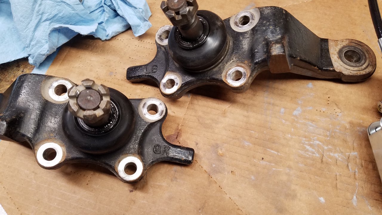

I just received my new oem lower ball joints from Toyota OEM Parts | EB TOYOTA PARTS | toyotaparts.bochtoyotasouth.com | Boch Toyota South
They're black and don't seem to have any of the markings that others have said to look for on genuine LBJ's but the castings including the machined areas look high quality.
I see some letters in the cast that I don't recognize though.
"DR" and "NRA" on one
"LJ" and "ALN" on the other
The tons of discussions about lower ball joints have me paranoid about getting the right stuff, is there a way I can confirm that these are genuine Toyota OEM parts?
Seeing that you ordered straight from a Toyota dealership, I'd put the likelihood of getting a counterfeit at 0%. There are no identifying marks on the ball joints that I am aware of. Install and drive happy.

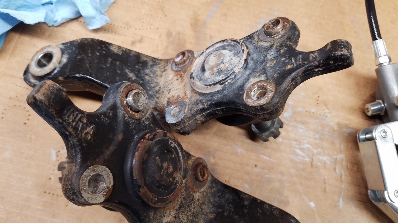

Markings on ones I replaced not long ago, they came from Olathe Toyota.
There's also 2 kinds, ones with boot protectors and ones without. I think boot protectors are for 2001-2002. They use different bolts with different torque spec. Flanged bolts at 59 ft/lb for regular non-boot protector LBJ and 37 ft/lb for the boot protector ones. The service manual doesn't make that clear. Then there's the debate over loctite or not. I put Loctite 243 on about 1/3 of the bolt thread. They have some green factory thread locker looking stuff on them new so don't know if it's really needed. Always use new bolts, they stretch out when torque.
