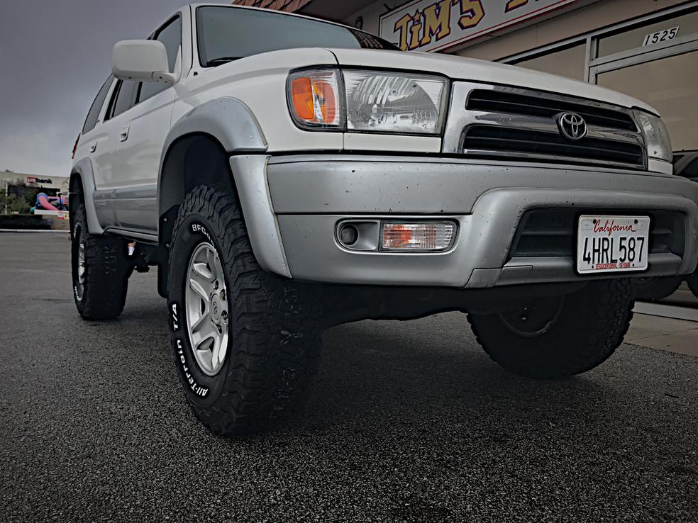

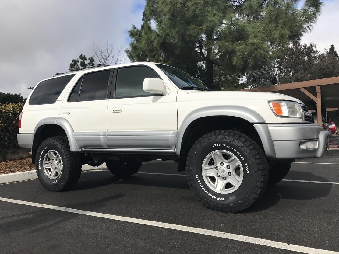

Installed lift and tires. Very exciting. Went with the Sonoran Steel 1.2 and some 285/75/16 KO2's. Installed the lift on mine and my friend's 4Runners this weekend (along with lbj's don't worry) and just got the tires today!

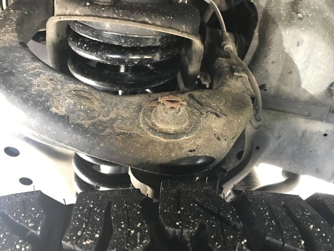

I noticed I'm experiencing some rubbing, I expected to have some work to do with the 285's. It's rubbing on the uca's and of course the lowest part on the inside of the front fender flairs. I ordered some spidertrax spacers to fix the uca's and will have to reassess the fender once the spacers are on. It sounds like a 1" body lift might be necessary.

Looks pretty awesome! I think you will have to increase the lift indeed, or maybe add some spacers.
I have the 285 duratraks. 3" toytec lift. I put 1.5" trail gear spacers on mine. No rub. I'd wait until you get those on until you change the lift. Or add a body lift, I don't like those (personal opinion)

That's good to hear. I'd like to avoid adding a body lift if I can. I don't mind doing a bit of trimming, I think once I add the spacers the rubbing to the fender flair will worsen. Then I need to play around and stuff the wheels up to see what else I get.

With just a 3" and 285s with spacers I could fully stuff with no issues up front. You should be okay.
If you use spacers and have the caster adjusted a bit, you shouldn't rub much or at all with those tires.

If only there were caster to adjust, I need to get uca's for that no?
I think you can achieve up to 2 degrees of additional caster with the aftermarket upper control arms. Really worth it if you are going above 2" of lift and want to use 33" tires.

Next step: save $500 for said aftermarket UCA's. Do you think uniball's are worth it? I can't imagine I would actually put them to use (or that really anybody not racing could).
