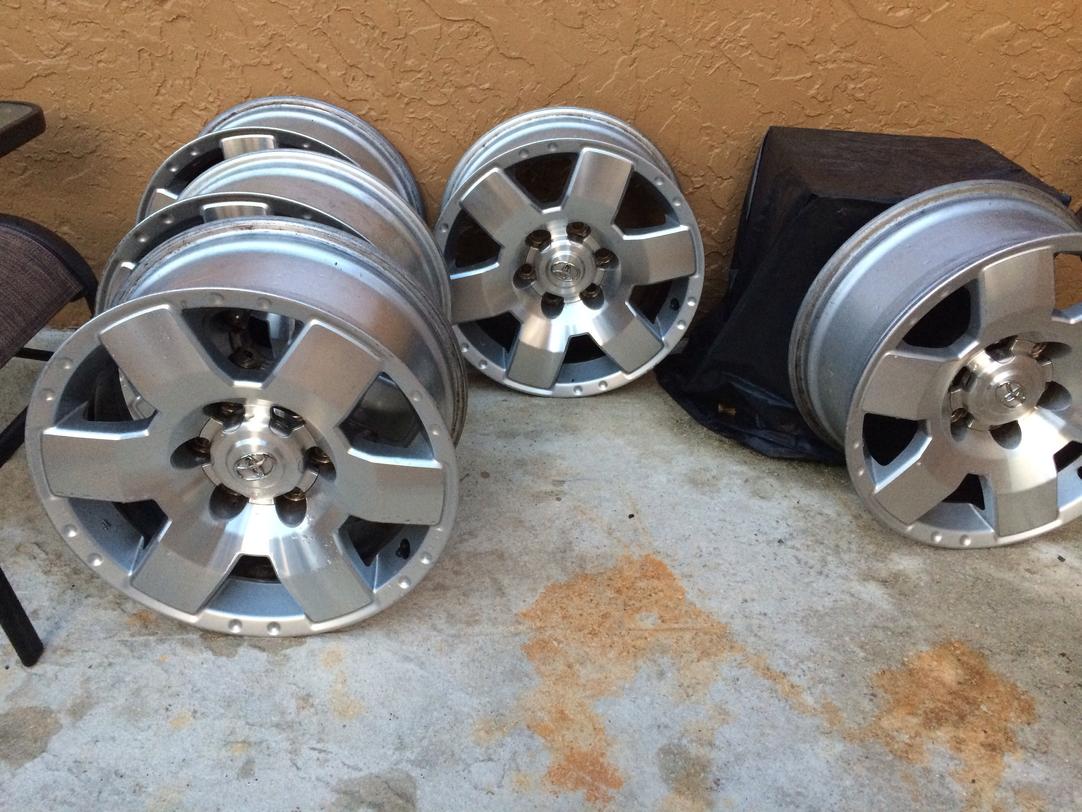

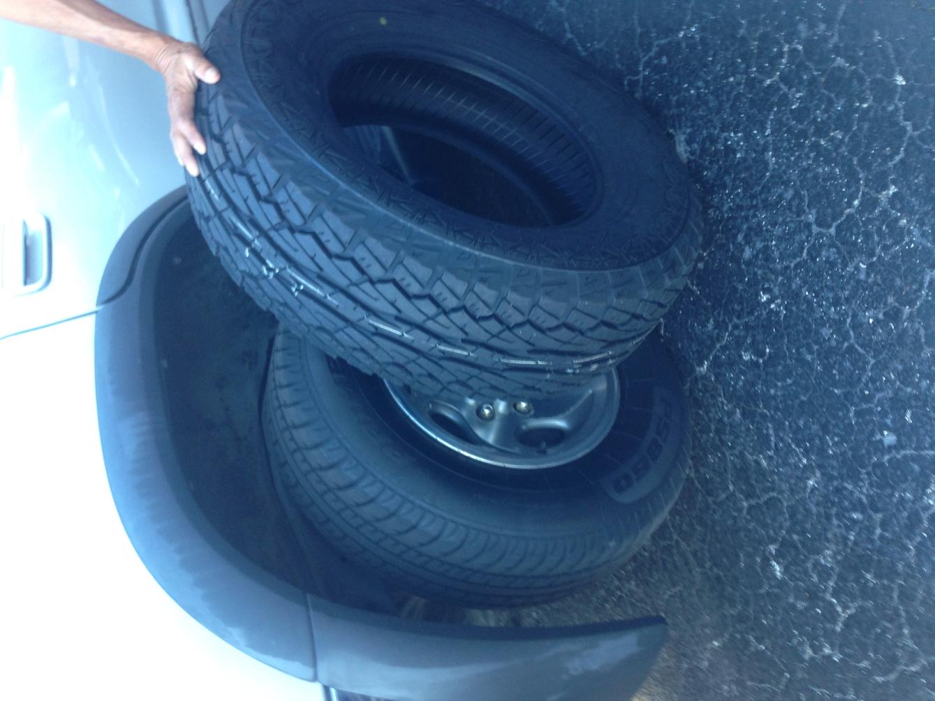

Hello guys and gals,
Two weeks ago I bought my first truck. A week ago I started to look around ebay, amazon, and craigslist for some new shoes. A couple of days ago I found toyota fj cruiser rims. Today I picked up the new set of tires (wild peak 265/70/17). I did a little research and I found that the lug nuts needed to be mag style. However the car came with acorn style lugs. I did a dry run and the acorn lugs actually tightened. Is this accurate? Can I just leave the lugs it has already? Thanks in advance. I'm so happy with my purchase.

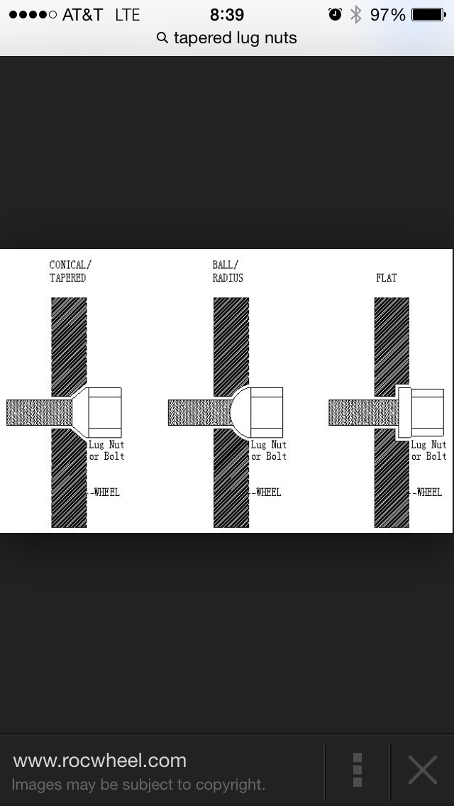

Check the seat on the wheel, if its flat you need mag type lugs, if it's tapered you need acorns.
Thanks Dr. But can you please tell me how it looks flat and tapered. I'm out of my element here. Thanks in advance

Currently, I have the rims the car came with. I believe they are ford explorer rims that they put on. Now I have the fj cruiser rims.

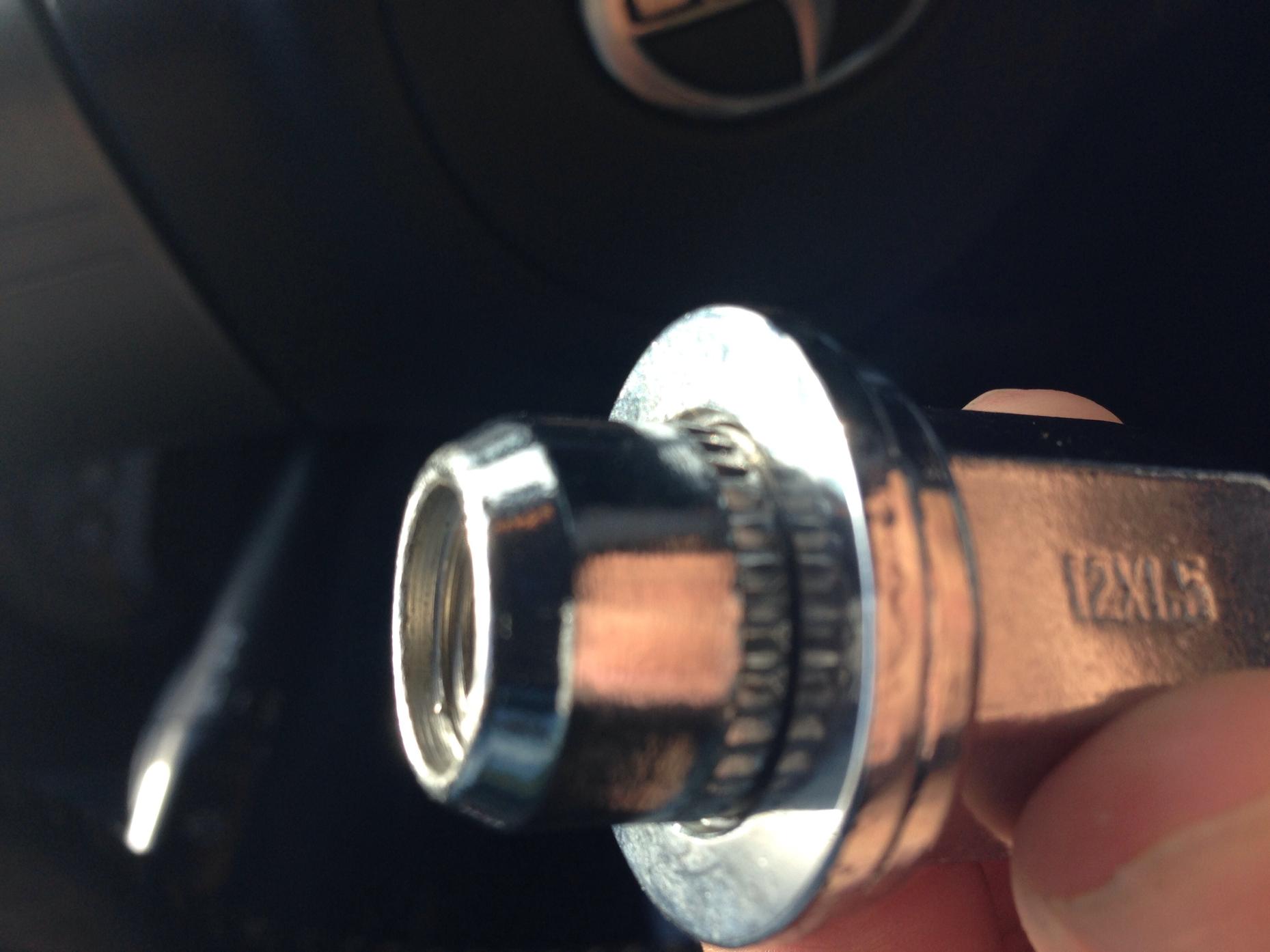

Those FJ rims don't take a acorn lug nut. You will need the shank lug nut like this. Note this is a wheel locking lug, but shank style.

Any type of lug nut will eventually tighten if you turn it far enough. That's not enough.
The taper has to match the taper on the wheels as the friction between the two is what keeps them tight. The same could be said of the type that use flat seats and those that have a hybrid of flat and taper.
The taper is also what centers the wheel on the wheel hub for any lug centric wheel.
K. Went to local autozone and picked up 20 shank lug nuts for the baby. LoL. Thanks for all the support. You guys really helped out. I'm located in miami, Fl if anyone one is around this way!
