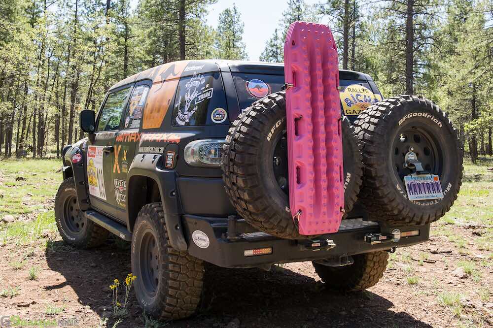

I'm still working on a filler plate using thinner gauge steel that will bolt to the bumper and also to the body of the truck using pre existing bolt holes. I was a little under the gun to get this prototype developed so some finishing details are still to be done.

We just did it last night i will get pics of it all asap! but we DID get it working i swear lol. The way we rigged the camera in the tire holder hole is still a little sunk in because i still see a portion of the rim when reversing and its not unbearable but it ignites my OCD lol
I basically followed the SSS instructions for camera relocating in their Lexus instructions but i will get pics of how that all turned out up here asap.

Yes and yes... =) you remove a few bolts and the jerry can holder slides out of the arm and the shock and swing arm can also easily be removed in 3 minutes or so

The bumper looks nice. I like the side mounted ladder, but I'd be concerned that the ladder support would quickly result in a broken window. Would it be possible to have the a ladder with an easy mounting feature that lets you remove it quickly when you don't want it sticking off the side of the truck?
The ladder currently takes me no more then about 2 mins to remove so in a tight trail i can quickly take it off if need be..

We banged the hell out of our prototype and exposed some imperfections when i purposely/accidentally dropped the rear end on some serious rocks meandering down some artificial off road structures trying to push the limits of the bumpers flexibility... haha... it EASILY passed the fenders avoiding any issues there but the tail light has a a slight crack not from the flex but from my not so smooth dismount of a big rock which caused the weight of the vehicle to kinda "crash" down on it for a quick second. But its performance overall was really awesome. (pics coming soon) I off roaded in the same place 6 months ago and used to bottom out on almost every rock last time so clearance compared to last time has been dramatically improved for sure. But I am just glad it was our rig and not any of yours lol. We head on a week or so overlanding/road trip ending in Maine today from Florida so well see how it does throughout this trip as well as a few rugged off road parks and trails we will be going on all through December.

Check out what we did last night =p
fargo4x4-albums-ig%3A+%40fargo4x4-picture36979-little-late-night-innovation-we-relocate-rear-view-camera-spare-tire-swing-arm-black-plastic-piece-actually-sheet-kydex-we-cut-size-bolted-stock-rear-view-camera-%3Dp-but-ofcourse-production-models-%40southernstylespeed-will-have-built-rear-view-camera-holder-you-can-relocate-your-stock-camera-but-our-prototype-will-have-make-do-now-%3Dp.jpg
A little late night innovation as we relocate the rear view camera to the spare tire swing arm... the black plastic piece is actually a sheet of kydex we cut to size and bolted the stock rear view camera to it =p
But of course on the production models you mentioned you will have a built in rear view camera holder that you can relocate your stock camera to right?
But for now our prototype will have to make do with this =p when i finish the wiring ill post more pics from the actual head units perspective

We trashed the hell out of our rear bumper on this trip but the bumper and fenders have experienced no damage at all and the bumper has yet to hit the fenders once... so far.
The bumper flex actually cracked our tail light a little but only because we dropped down a massive rock a little too quick and careless and ended up resting the whole weight of the vehicle on the rear bumper for about 1-2 seconds as we slid off causing it to push the bumper ALL the way up and it was a bit too much pressure for the tail light to take... So on production models SSS will improve the area around the tail light region to prevent this going forward. That being said we couldn't take a picture of the impact because it happened so fast lol but here is a pic of the taillight after the hit. Aren't you glad we are the test subject?! Haha that is why it is a prototype =)
fargo4x4-albums-ig%3A+%40fargo4x4-picture37182-cracked-tail-light-we-trashed-rear-bumper-trip-but-bumper-fenders-have-no-damage-all-have-yet-hit-them-once-flex-problem-actually-cracked-our-tail-light-little-but-only-because-we-dropped-down-massive-rock-little-quick-careless-ended-up-resting-whole-weight-vehicle-rear-bumper-about-1-2-seconds-we-slid-off-causing-push-bumper-all-way-up-bit-too-much-pressure-tail-light-take-so-production-models-sss-will-adding-additional-space-around-tail-light-region-help-prevent-going-forward-being-said-we-couldnt-take-picture-impact-because-happened-so-fast-lol-but-here-pic-taillight-arent-you-glad-we-test-subject-haha-why-prototype-%3D.jpg
Anywho
- the assist shocks provided by SSS worked great on the trip despite the cold weather and stress.
- The swivel mechanisms that control the swing arms performed awesome and were opened and closed probably over 50-75 times this week since we brought the dogs with us.
- Our DIY paint job held up nice except around the ladder so we will have to do a little touch up work there...
- The side ladder has a slight vibration at highway speeds but you cant hear it.. you can only see it from the side mirror and the rubber stopper never touches the vehicle until you begin to climb the ladder.
- The bumper makes absolutely no noise...
- the jerry cans do rattle a little when they are empty or close to empty...
When i clean the vehicle more thoroughly this weekend i will take apart the swing arms and thoroughly inspect the bearings and areas where we hit the bumper to see how it held up.
