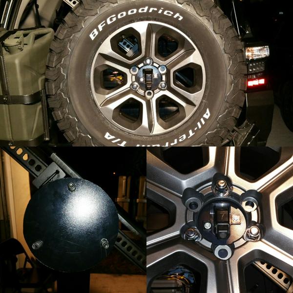

Check out what we did last night =p
fargo4x4-albums-ig%3A+%40fargo4x4-picture36979-little-late-night-innovation-we-relocate-rear-view-camera-spare-tire-swing-arm-black-plastic-piece-actually-sheet-kydex-we-cut-size-bolted-stock-rear-view-camera-%3Dp-but-ofcourse-production-models-%40southernstylespeed-will-have-built-rear-view-camera-holder-you-can-relocate-your-stock-camera-but-our-prototype-will-have-make-do-now-%3Dp.jpg
A little late night innovation as we relocate the rear view camera to the spare tire swing arm... the black plastic piece is actually a sheet of kydex we cut to size and bolted the stock rear view camera to it =p
But of course on the production models you mentioned you will have a built in rear view camera holder that you can relocate your stock camera to right?
But for now our prototype will have to make do with this =p when i finish the wiring ill post more pics from the actual head units perspective

Yes, production models will have a bolt on mount that will allow you to adjust the angle of the camera for maximum visibility. We use this on the GX models and it works great no matter the wheel/tire setup.

Have you considered building/machining a housing for the OEM camera, and harness, that allows more than just owners of the SSS products to relocate the camera? I could see this being nice to have for CBI/Shrockworx bumpers.

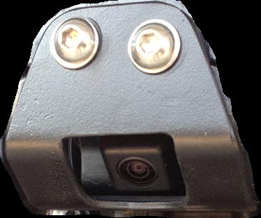

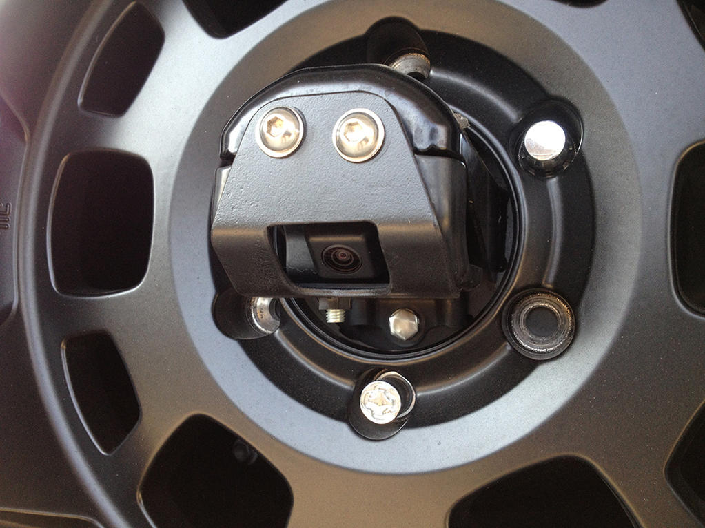

I was thinking the same thing when looking at the previous post.
When I had my FJ, I expanded on the camera area by making a cover/shield to protect the camera as well as deflecting some of the water that gets on the lens.
Something like this would/could be an asset to the builds.

Honestly I was thinking something ABS, hell you can 3D Print ABS well enough that a nice looking enclosure with rubber seals would keep it clean, especially when being mounted on a swing arm.

Wow that does look pretty clean, and hear i thought our solution was clever SMH hahaha do you have a install thread on how you did this because CHALLENGE ACCEPTED! Thanks for the pic!

The only part I made is what is pictured.
I just started with a piece of cardboard, made the opening size for the camera, folded and marked the cardboard where needed, marked my bolt holes, transferred these measurements to the mild steel & started cutting.
Trimmed, buffed everything, checked fit again...painted & installed with stainless button head socket screws.

Well all i can say is well done! I love DIY solutions, now do it 200 more times and start selling them! haha

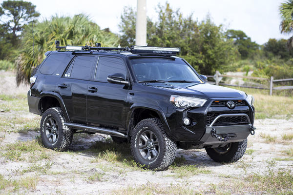

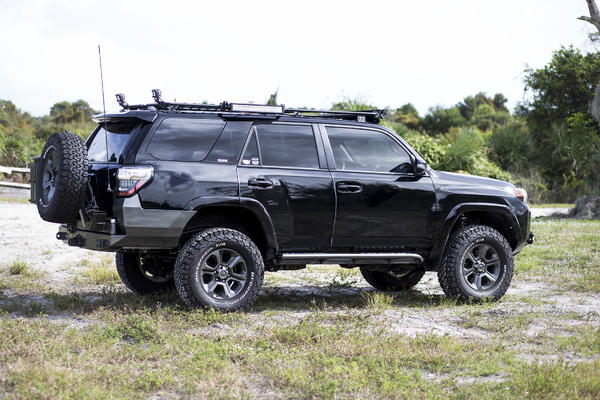

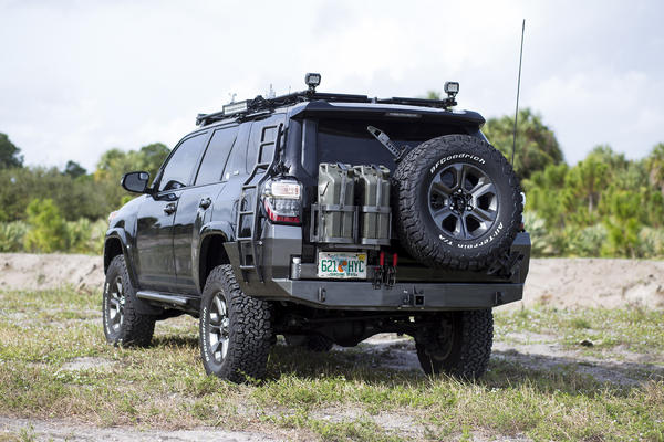

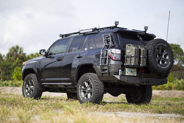

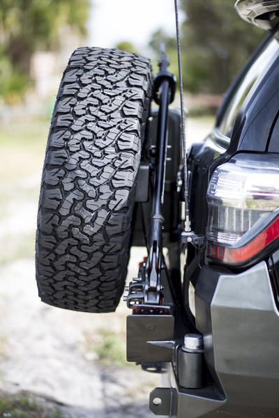

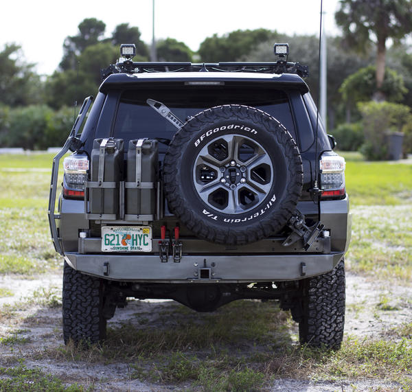

So new pics finally
I relocated the license plate too
Ill take close ups of that later after i finish a few things on it but here is a 360 view
fargo4x4-albums-ig%3A+%40fargo4x4-picture37000-maybe-we-should-do-baja-rack-color-too.jpg
fargo4x4-albums-ig%3A+%40fargo4x4-picture36996-relocated-license-plate-repainted-jerry-cans-darker-od-green.jpg
fargo4x4-albums-ig%3A+%40fargo4x4-picture36997-some-you-have-requested-centered-rear-shots-so-here-one.jpg
fargo4x4-albums-ig%3A+%40fargo4x4-picture36998-southern-style-speed-made-so-precision-tight-yet-has-yet-touch-we-super-impressed.jpg
fargo4x4-albums-ig%3A+%40fargo4x4-picture36999-those-you-who-dont-want-side-ladder-just-visualize-both-sides-like.jpg
fargo4x4-albums-ig%3A+%40fargo4x4-picture37001-southern-style-speed-front-bumper-c4-fab-sliders-fuel-tank-skid-southern-style-speed-rear-bumper.jpg
