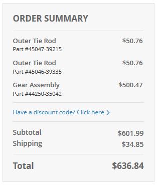

I can recommend ordering parts from Mcgeorge toyota for low as possible priced oem. Here's where my bill came out for rack which includes inner tie rods connected, I also ordered the outer tie rods. You may need both hoses/lines also as they tend to break a lot on disconnecting. I ended up putting in Energy Suspension rack bushings, which were about $30 with including shipping. If you want a rack that lasts, go oem.
