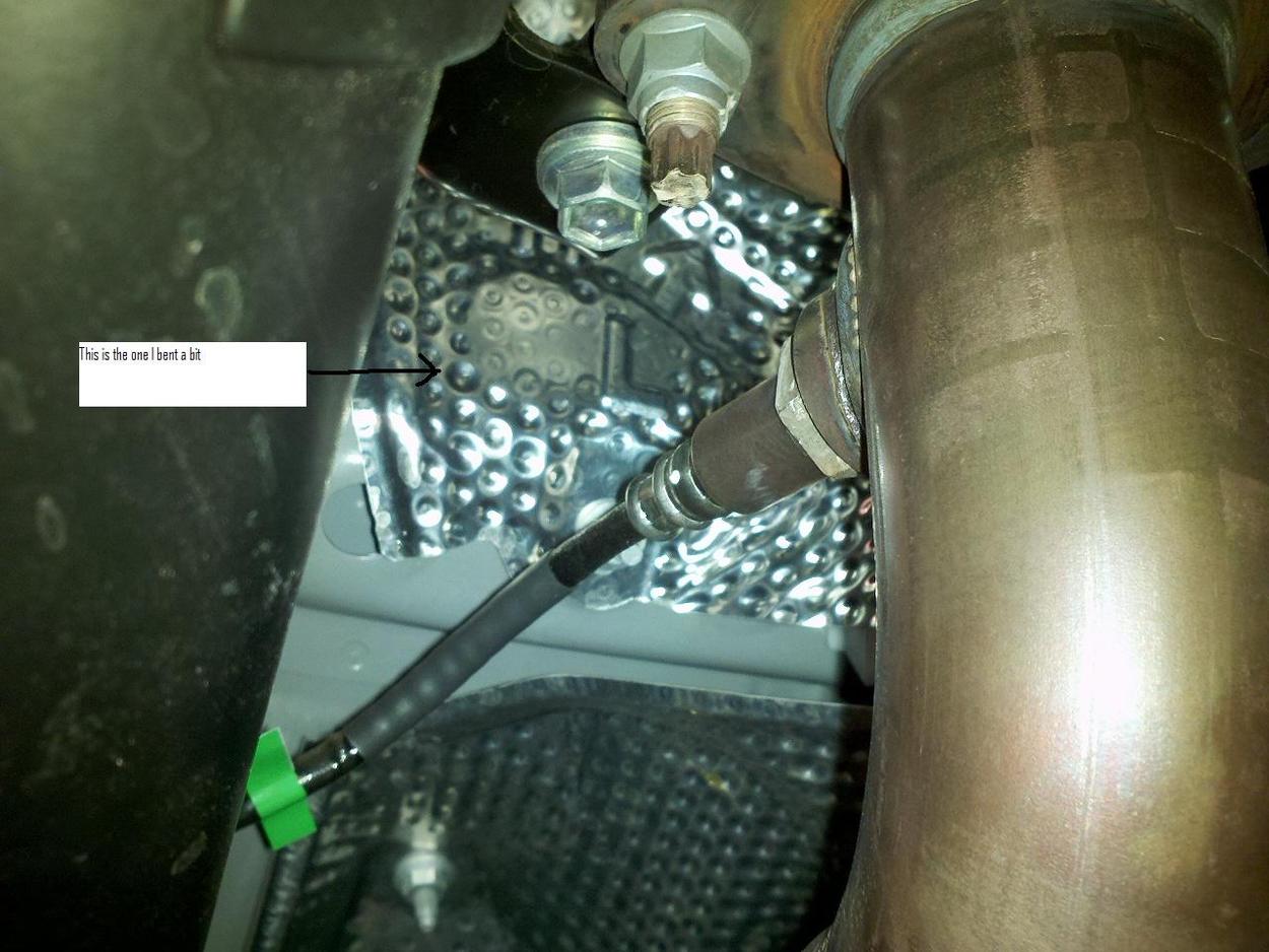

There has been some change but not completely resolved. Let me explain.
Two weeks ago, when my TE put in Drive/Reverse in stationary is very loud some times with high pitch. It even can be heard in parking lot without walls around. But it did not happen every time. I searched the forum regarding noise and found some thread mentioning heat shield vibrating and some trucks had those sound disappeared by them self later on.
Then I went underneath the truck from the passenger door side to check the heat shields. There are many heat shields there, big and small. I touched some that I can reach. There is one small piece that just above my head around one of the u-joint I think. I tried to bend it as I think it was too close to the body frame.
Next day I drove my truck and checked the sound when stopping and it did not happen. For two weeks now, those loud grinding noise has not re-appeared. I am not sure whether bending the small heat shield fixed it or it just cured by itself. I suspect that the sound maybe fainted to a level that is not obvious. The reason I say that is when I put it to Drive/Reverse with windows rolled down, I can still hear grinding sound but it is not that loud anymore. It sounds like some bell jingling with low level sound. When I start to accelerate slowly, I will hear some more clear bell jingling sound only for a brief period of time. As the RPM ramps up, there is no more jingling sound.
That makes me think that there is still some vibration or resonance with some heat shields or other parts withing engine/transmission compartment that will cause sound when the gears are in load. If that is the case, I will not worry about it too much.

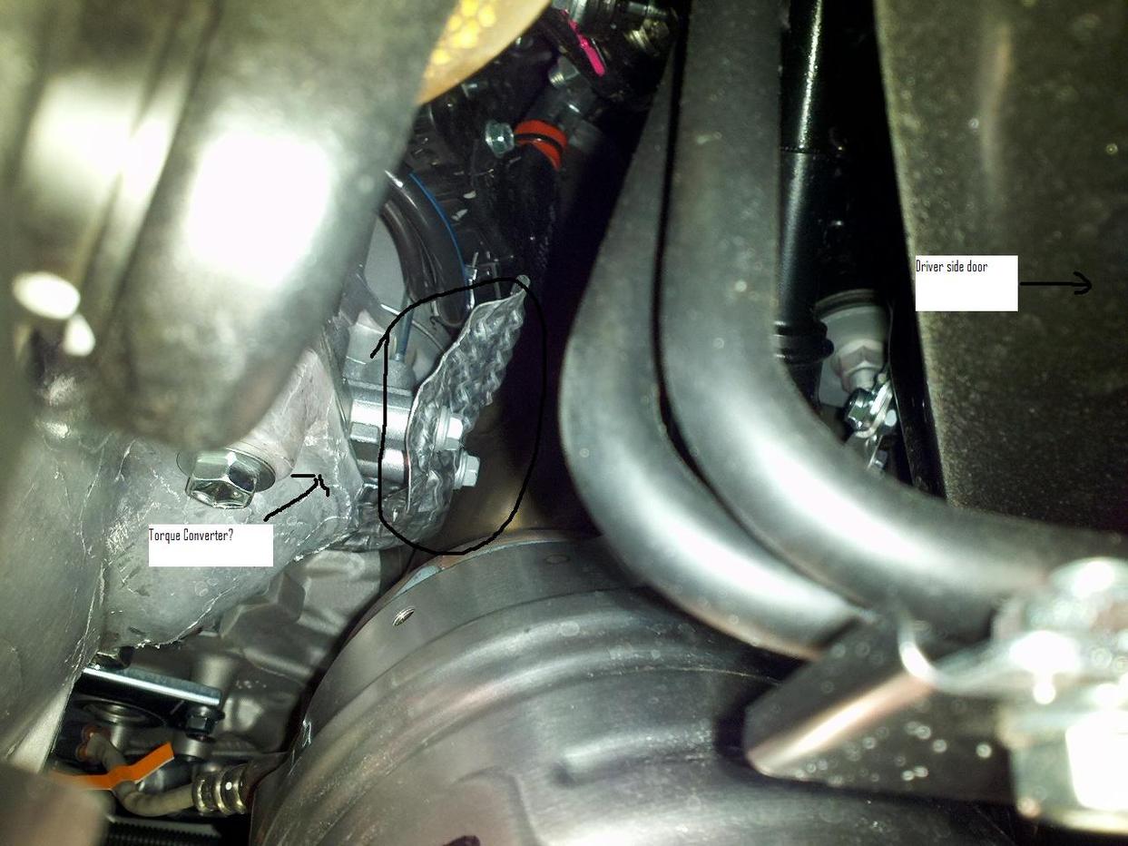

But I am not sure, as I can not reach engine compartments to check all lose parts. Also, I went under my truck the other day and noticed that there is a small heat shield piece that are attached to the torque converter (I think it is the TC as there are two aluminum colored tranny like housing, the one I saw is the front one). It is attached with two bolts. Guess what, it is loose and moves around. The bolts are tight just the piece is free to move. I tried to tight the nuts but it is hard to reach so I gave up. Not sure it is the one that causes the sound but I doubt it, because when I touched it, although it is loose, it did not sound like it.
That's the one that was rattling on mine. I would hear it when sitting in like a drive thru next to the wall and foot on brake and in drive. I could put it in Nuetral and it would stop.
It's like the piece or the bolts were designed wrong as it can't be tightened any more and it was real loose. It's a silver heat shield with 2 bolts on the drivers side just forward of the front cat. When I put DT headers on I just took it off.

Here is the picture of the heat shield that I bent a little bit. Not sure this cures the loudness. It is right underneath near driver door side.
The second picture is the heat shield that I think Harper7 had removed and it is really loose although with two bolts tightened.
Thanks for the pics. Have you tried bringing your T4R in & if so, what did the dealership say?
I haven't been to the dealer. Maybe on my first scheduled maintenance I will bring this up to them. I am thinking maybe if they putting two larger washers will make the piece stable. Maybe worth a try.
