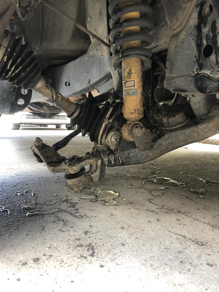

Yesterday between 2 and 2:30 in the afternoon Shadow went from being on 4 wheels to this:
attachment.php
attachment.php
All 4 bolts that hold the lower ball joint to the knuckle sheared cleanly off. We assume it was a hit and run where the other car hit/bounced off the rubber of the tire and left very little other damage. That's our best guess.
$2,500 of work. Replacing the CV axle, LBJs (both sides), Knuckle, and front shocks (left one was badly dented).
My mechanic said he had seen another 3rd gen 4Runner that was hit by an Uber in traffic on the wheel with the exact same failure.
This is a huge achilles heel. Pretty scary stuff.
I love this vehicle. We drove this 4runner 22,000 miles through South America. But it's pretty troubling that there's not really any way to guard against this type of failure. All 4 bolts looked shiny and strong. I followed the torque guidelines when putting those LBJs on. :shrug:
attachment.php
attachment.php
Wow, sorry to see that. Hopefully your auto insurance will cover the damage. Generally the LBJ won't take a shearing hit like that but it's still kind of scary. I would rather see a bunch of bent stuff as opposed to a failure. If you are super worried about it you could weld a bead along the edges and grind it off when you need to change them out, easy enough to handle.
This is making me wonder if the OEM bolts could be upgraded to a higher strength / class fastener. I need to verify but I think the factory bolts are metric class 8 which is equivalent to a grade 5 SAE. A stronger bolt like metric 10 or 12 would allow us to install the LBJ with higher torque values.
