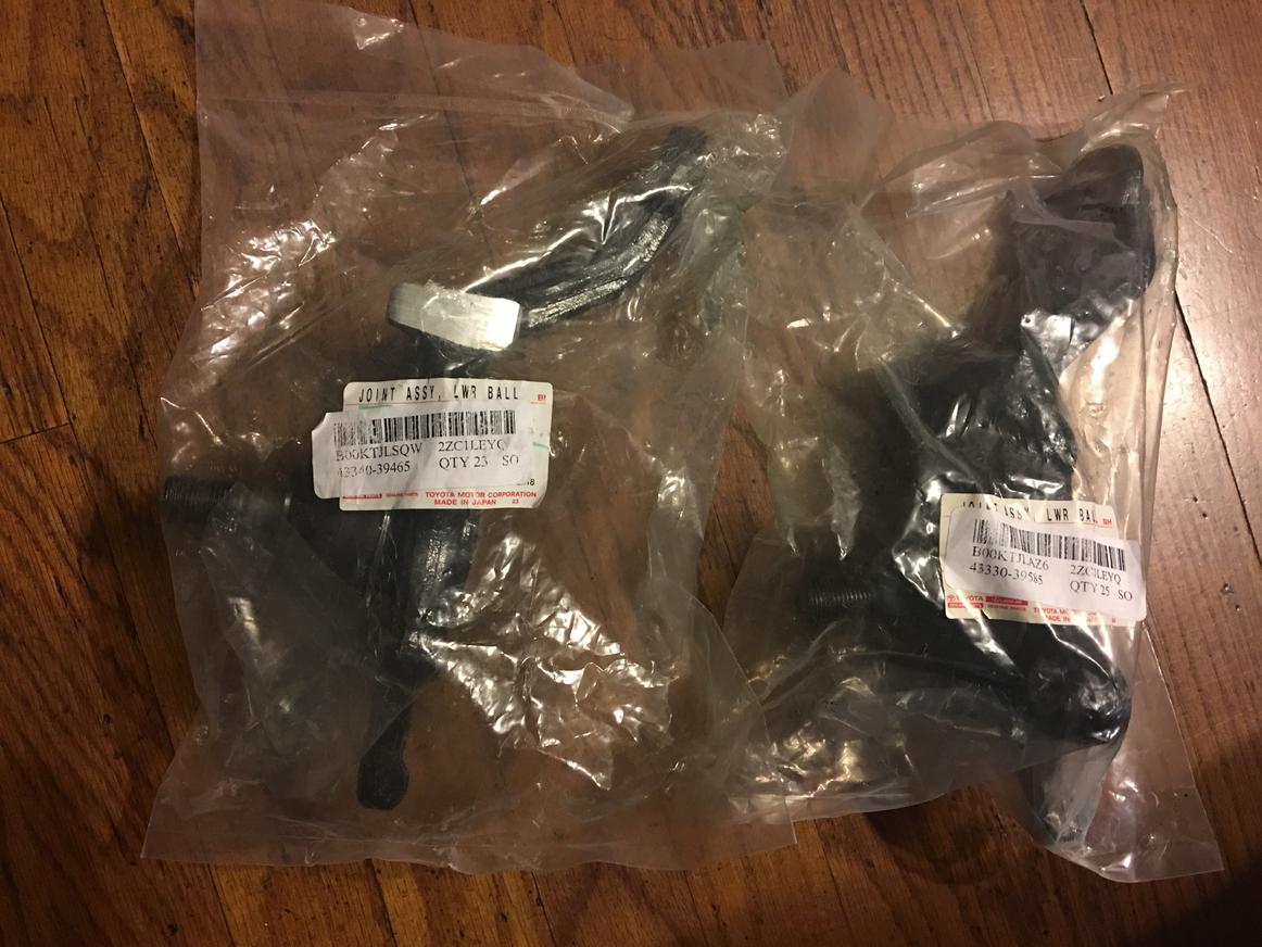

So after seeing this I legit purchased some lbj but I have some doubts . I posted in the what did you do to your 3rd gen today but figured I’d post it here as well since it makes more sense here.
I Got my ball joints in today from amazon but to my surprise amazon stickered over the Toyota part number? Wtf? How do I know if these are legit? There’s a Toyota sticker underneath the amazon sticker but anyone can resticker the bag. Plus I can’t read what the sticker says underneath because again the p/n is blocked off... any help would be appreciated are there any indicators I should look out for that let me know they’re legit?
