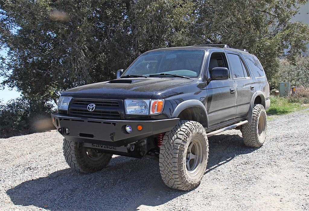

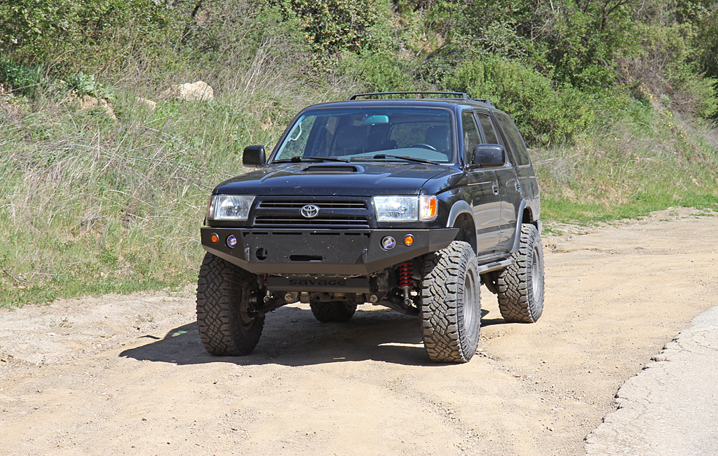

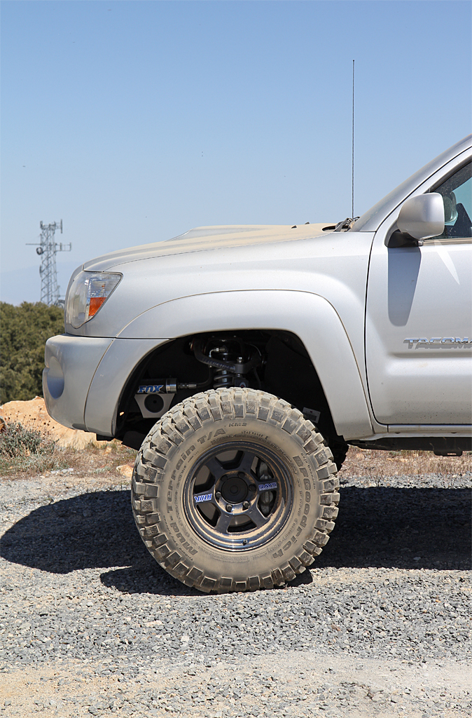

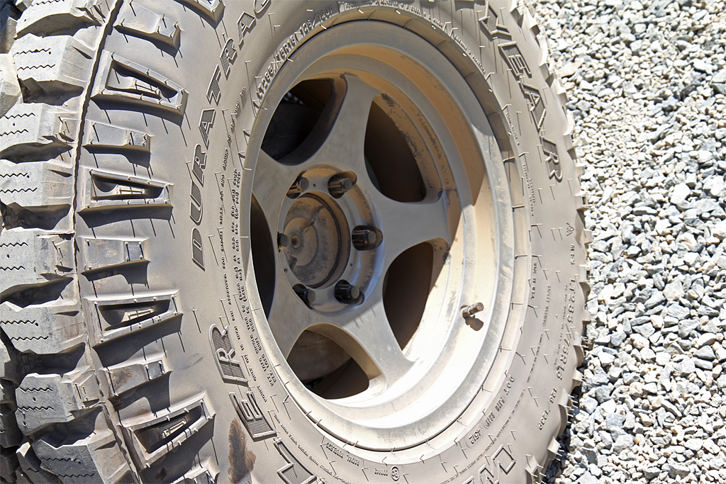

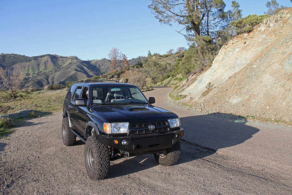

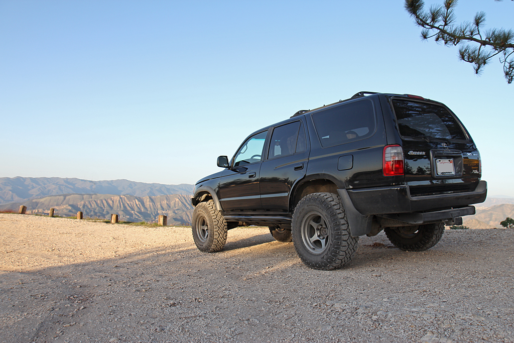

I fiiiiinally took some proper photos of my 4Runner with the new lift and wheels/tires. It rained here yesterday, so it made the local trails nice and muddy for the photos! :)

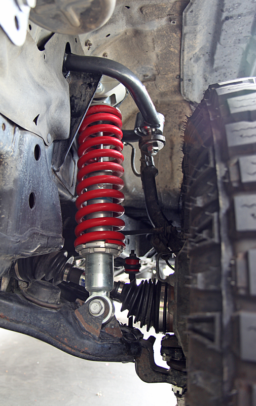

wow man great transformation! hows the lift ride with the coilovers, better than stock? im looking at the same kit. and those wheels look so goo
Thanks dude! The suspension feels great. I can definitely notice the stiff springs at times. But, overall, I have no complaints.
Pine Valley right?
It's actually Trabuco Canyon.

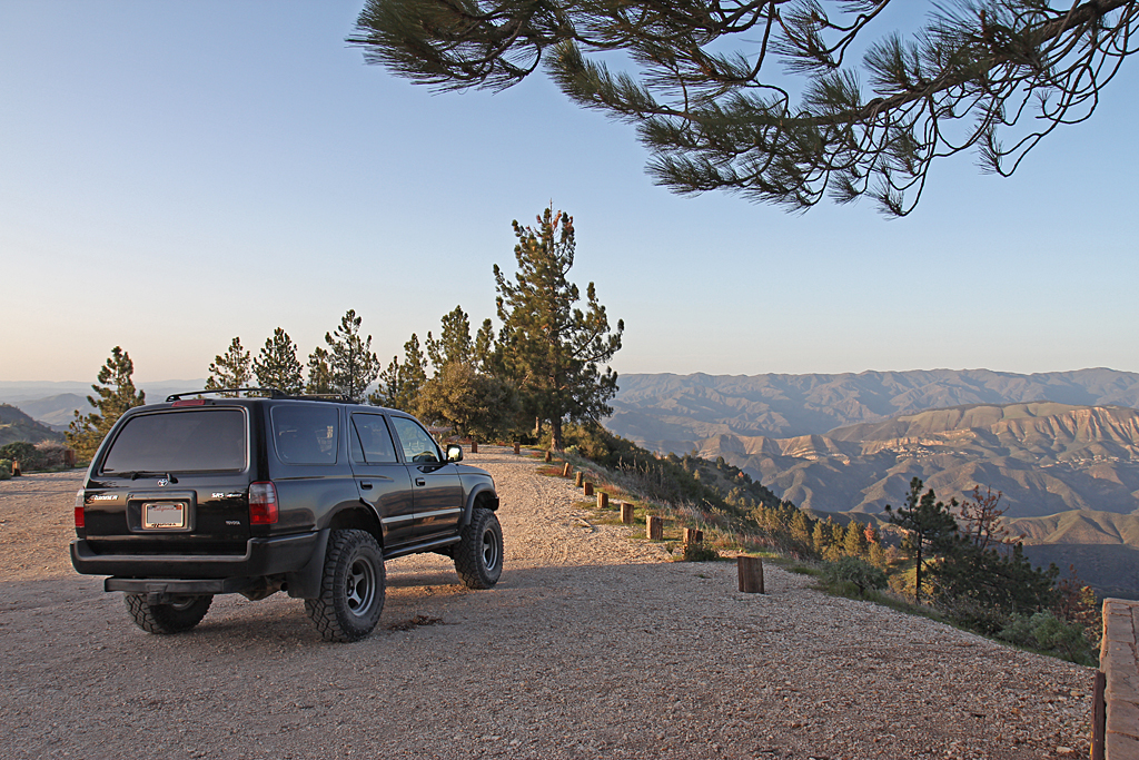

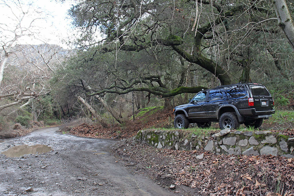

I went on a camping trip this past weekend to the mountains of the Los Olivos area, just north of Solvang, CA. It was mostly hiking and sitting around the campfire, but I was able to sneak away for a little bit for some fun in the 4Runner. :) Here are a few photos from the trip:
On the way back home, we stopped at the Cold Springs Tavern off the 154. Nearby is the Cold Springs Bridge. Pretty neat!

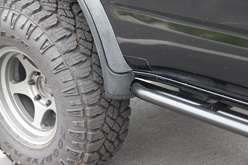

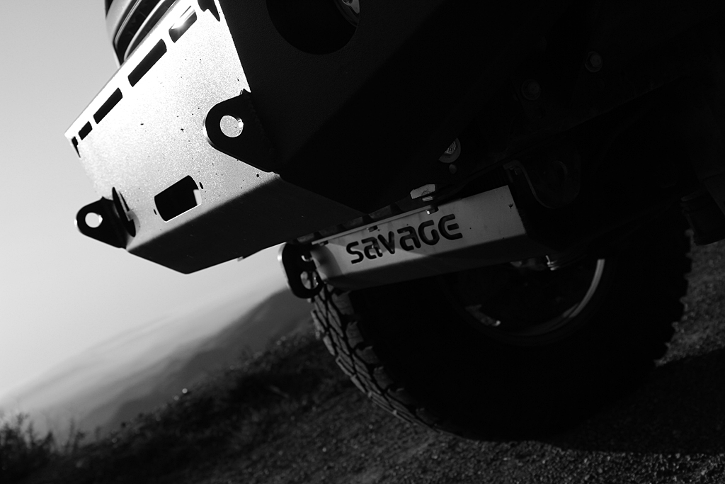

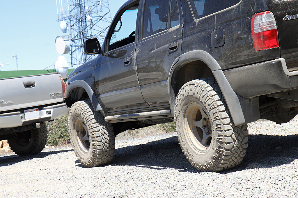

1. I'm missing part of the rear fender flares. They interfere with the sliders, so I had to remove them during the installation of the sliders. I've just been to lazy to modify the flares and re-install them. Hopefully I'll get to that project soon. The poor thing looks unfinished! :(

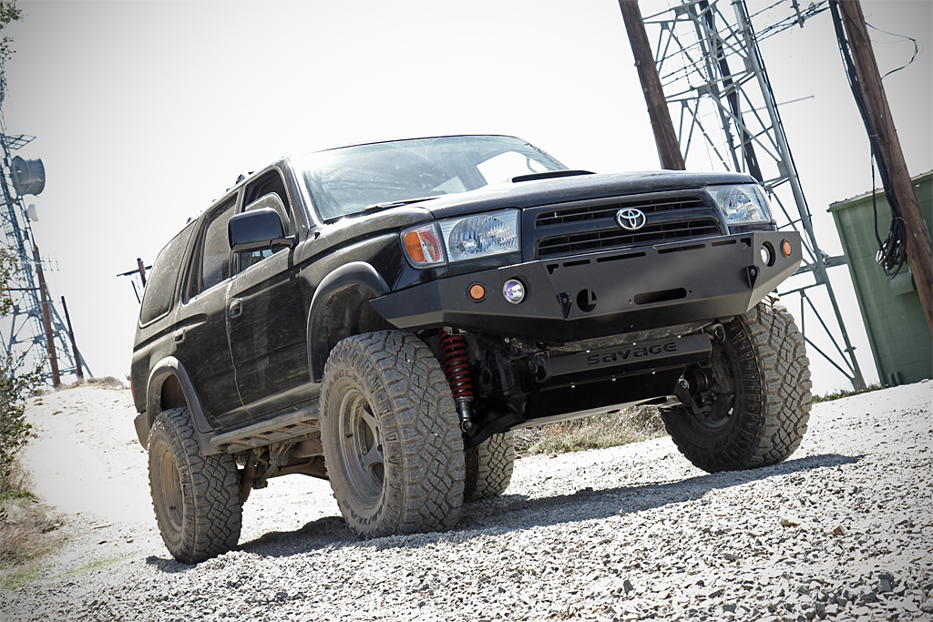

2. I only have half of the Savage front skid plate setup installed. It turns out that one of the lower threaded holes in the chassis is stripped. I didn't want to risk having the heavy skid fall off, so I just kept the lower part off for now, until I can re-tap that hole. Also, the lower part of the skid actually makes contact with the lower control arms. I'm going to have to notch the lower skid a bit before I can install it.

How do you like the combo of OME 890 coils with the bilstein 5125 w/ adapter in the rear? Does it ride too stiff for a daily driver? I know if you get the OME shocks in the rear with the OME coils together those are way too stiff for a DD, so how is the ride with the bilsteins? Also, does that adapter make a lot of clunking going over bumps and stuff? I'm debating getting the exact same setup you have for the rear and wanted to hear what you thought of it!

I have no complaints about DD'ing with this setup. The combo of the 890's and the 5125's is pretty soft/comfortable. I get no noises from the rear what-so-ever. There's no reason that the adapter should make any clunking noises...unless it's not tightened down all the way! lol The only thing with the adapter is that it's kind of a pain in the butt to install. There's not much room up in there for tools.

The installation of the Savage Offroad sliders required me to remove part of the rear fender flares and trim them a bit. I finally got around to trimming them up this past weekend. Now I finally have my rear fender flares again! :) It's a little hard to see in the photo, but I basically just had to cut out some of the lower part of the flare so that it clears the sliders.

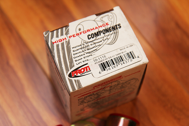

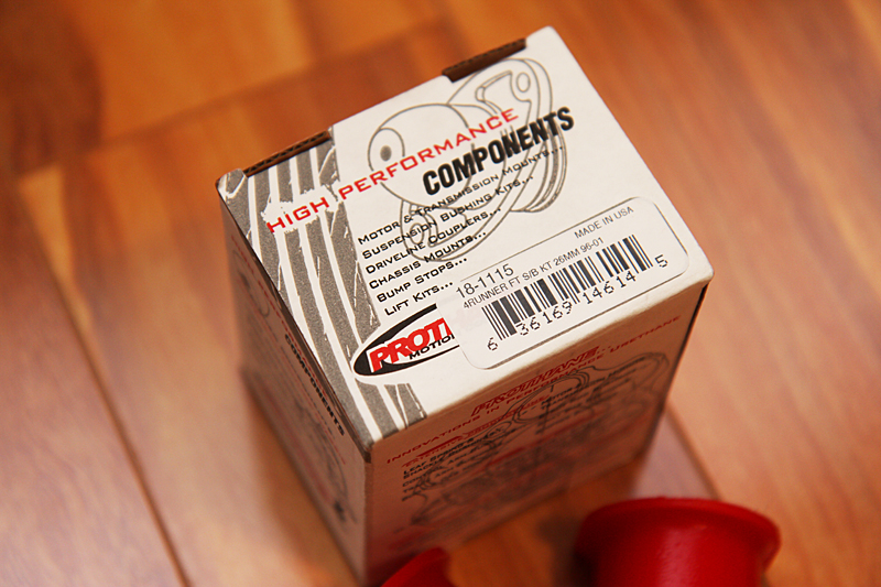

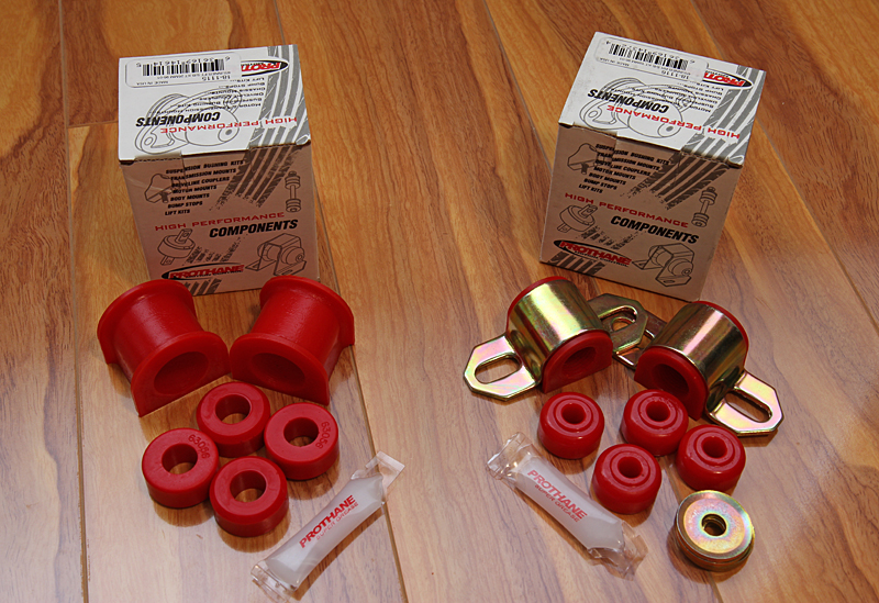

I bought some Prothane sway bar bushings a while back, and finally got around to installing them this weekend. I don't have any "installed" photos yet, but here are a couple photos of the parts:

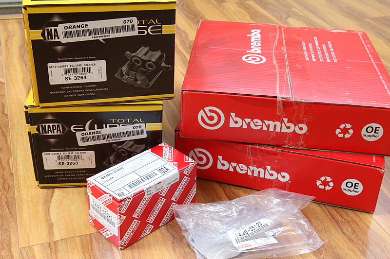

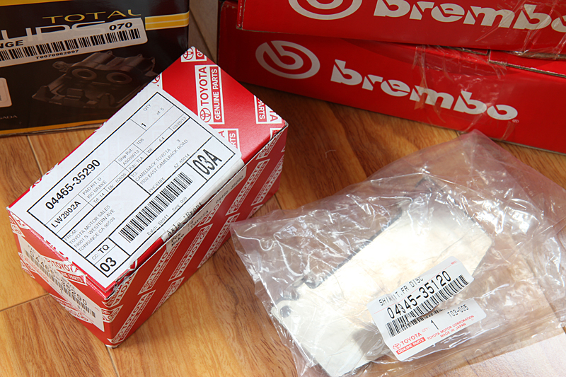

I've noticed a slight pull to the left when I really brake hard. I figure that the caliper is probably sticking. I really hate doing brake diagnostics, so I thought that this was a good opportunity to "upgrade" to the Tundra brakes. So I've collected some parts for that project. Hopefully I'll be able to install them sometime in the next few weeks. Until then, here are some photos of the parts. I went with "semi-loaded" calipers from Napa, Brembo rotors, and Toyota pads/shims:

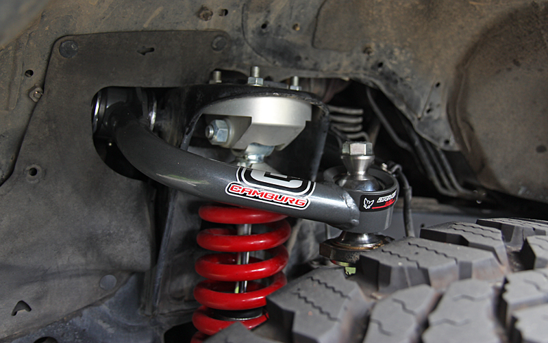

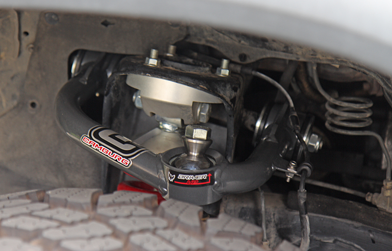

And lastly...this weekend I also finally got around to installing my Camburg upper control arms. It was a super straight-forward install. Even before getting it re-aligned after the install, the truck already feels amazing. The added caster really helps the front end feel more stable. Unfortunately, I ran out of daylight and I didn't get to take any photos. Stay tuned for those.

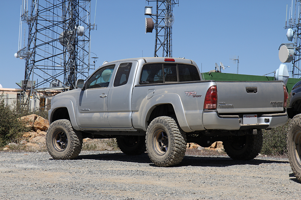

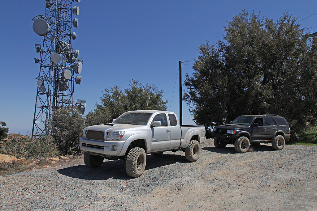

Today I did a little wheeling trip with a group of guys. We went to the same local mountain peak that I went to last weekend...but this time we accessed it from a different trail. For those that are familiar with Santiago peak...we took Main Divide Road from Ortega Hwy up to the peak, then back down the other side into Orange County. Our group consisted of 1) 4Runner (me), 2) 2nd gen Tacoma on Fox suspension, 3) Tundra on Icon suspension 4) 1st Gen Tacoma (stock for now), 5) Jeep Wrangler 6) Jeep Wrangler Rubicon. Anyway...I'm sure you guys would rather just see some pictures...so here you go:
This was the group:
The Tundra had to bail after a while, so we were down to:
And here are a few action shots:
