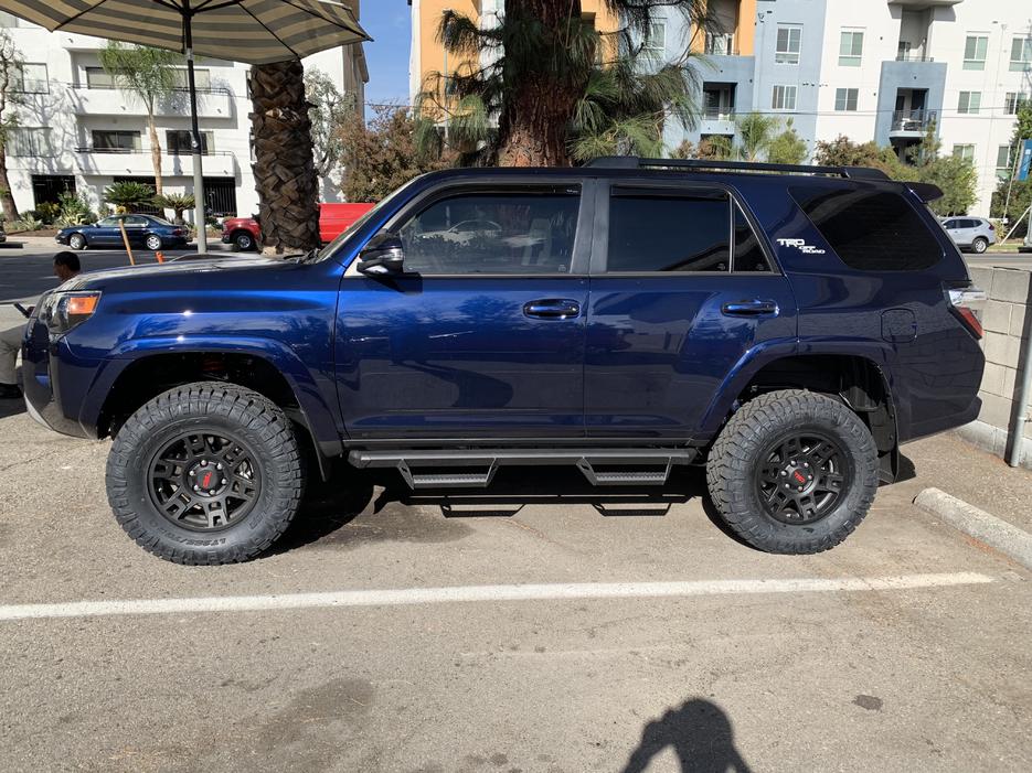

Just installed my Ridge Grapplers C-rated 285/70/17 and loving them. Quiet on the road. Haven’t tested off road yet but love the way they look.

They look great! Did you have to do much in terms of trimming to avoid rubbing? Curious what lift you went with. About about to do the same tires, TRD Wheels and sorting out the lift.

I went with TRD pro suspension coz they were on clearance and did icon 2” lift for rear coil and then added spacers for the front to get 2.5” lift front and 1.5”lift on rear. No rubbing but my shop pushed my front wheel well a little bit
