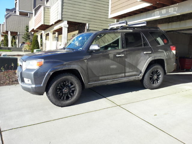

Will say, after trips up through the passes, I do a quick (high-pressure) rinse at the local "wash-it-your-damn-self" place; as you can see from pic, with so much grime, I just can't get myself to take the direct to wash plunge. However, for regular to medium dirty-ness, works great.
