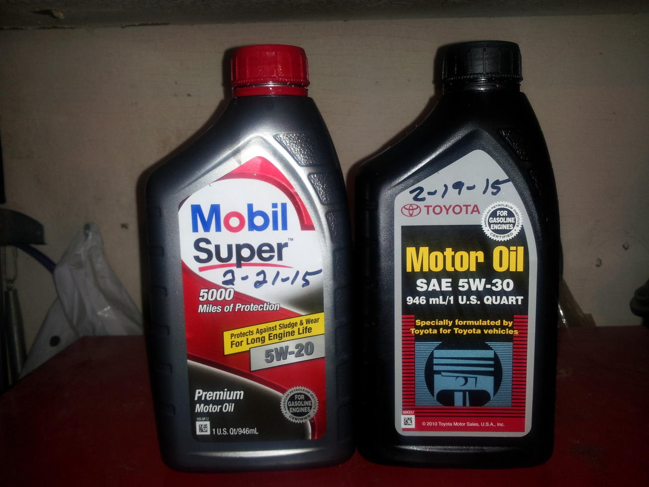

My otherwise-very-good dealership service dept used to use Kendall, now I think Castrol as their "house brand" oil. The stuff comes in a 55gal drum (or metric similar). I'm generally dubious so request Mobil1.
What do you refer to when saying "Toyota" motor oil?
It is this one:
CAM000111_zpsbd807ebe.jpg~original
CAM000141_zps6c0b0a44.jpg~original
It is supposed to be the top group IV motor oil. With an amazing additive package good for extended drain intervals (hence 10k change intervals per owners manual).
I'm torn between using the Toyota Synthetic 0w20 and Redline 0w20. Toyota has a VI of 214, whereas Redline is in the 170 VI at best. Most of the bobtheoilguy forums guys believe VI (viscosity index) is the be all and end all. But I still believe that the Redline oil being a Group V oil is still better than the Group IV Toyota 0w20.
