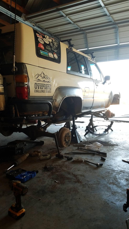

My 84 came with a 3” block lift, I’m doin the 63” rear swap as I type this. After I see how much lift that gives me in the rear I am goin to pick up trail gear springs and front hanger kit for the front with the same amount of lift to level her up. I’m doin a lot of extra’s “while I’m in there” like a rear housing truss, longfield rear axles, rancho’s to bilstiens etc. wanna be ready for this spring when the sun comes back out!

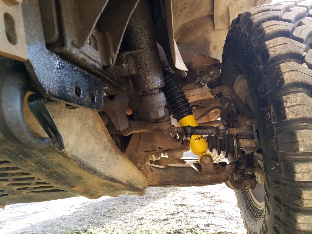

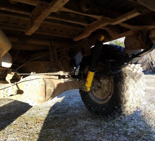

Recently upgraded to OME suspension. Previously had 1" lift blocks on the rear, TJM XGS shocks on the rear, SenSen shocks up front. Now have Nitrocharger Sport Shocks all around (ARB 60065 and ARB 60072) with Heavy Leafs (CS010R) with the third leaf removed. Running 265/75/R16 Falken Wildpeak MT01. Also just trying to get my post count up so I can create a build thread.

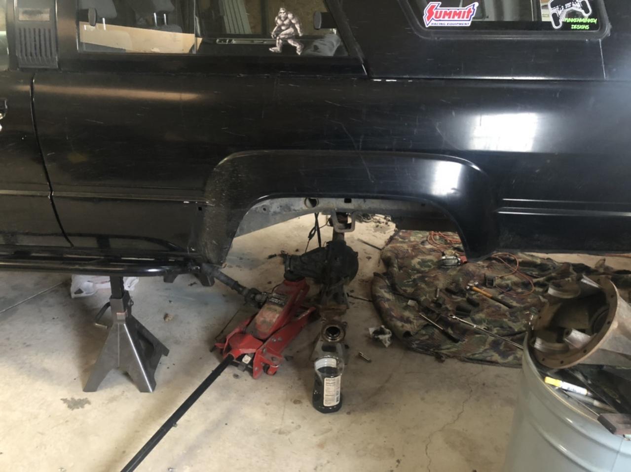

Hey there, I'm trying to figure out how I want to lift the front end. I've seen mixed reviews on bj spacers but with my current setup and plans they're sounding like the best option?
87 4runner, ifs. Just got 32s. The biggest i think I'd go is 33. I'm not interested in a SAS. While it's not a daily driver, I want to be able to have a nice ride on the road. I do some off roading but its mostly light stuff- sour grass and deer valley, not the Rubicon.
I added an extra leaf and some greaseable shackles in the back. I think i just need something to get me to 2 inches in the front so I don't rub the wheels. I'm cool putting some crank on the torsion bars but I don't want them to be super stiff. I'd like to avoid cutting fenders if possible as well. I also got a bumper on the front. I'm wondering if the 1.5" bj spacers wouldn't do too much damage elsewhere, or if there's something else I should to to keep it going good? Most issues seem to be with those that did 4" lifts or higher with the spacers. I don't have a ton of money to drop on it. Here's a pic from back before I lifted the rear.
