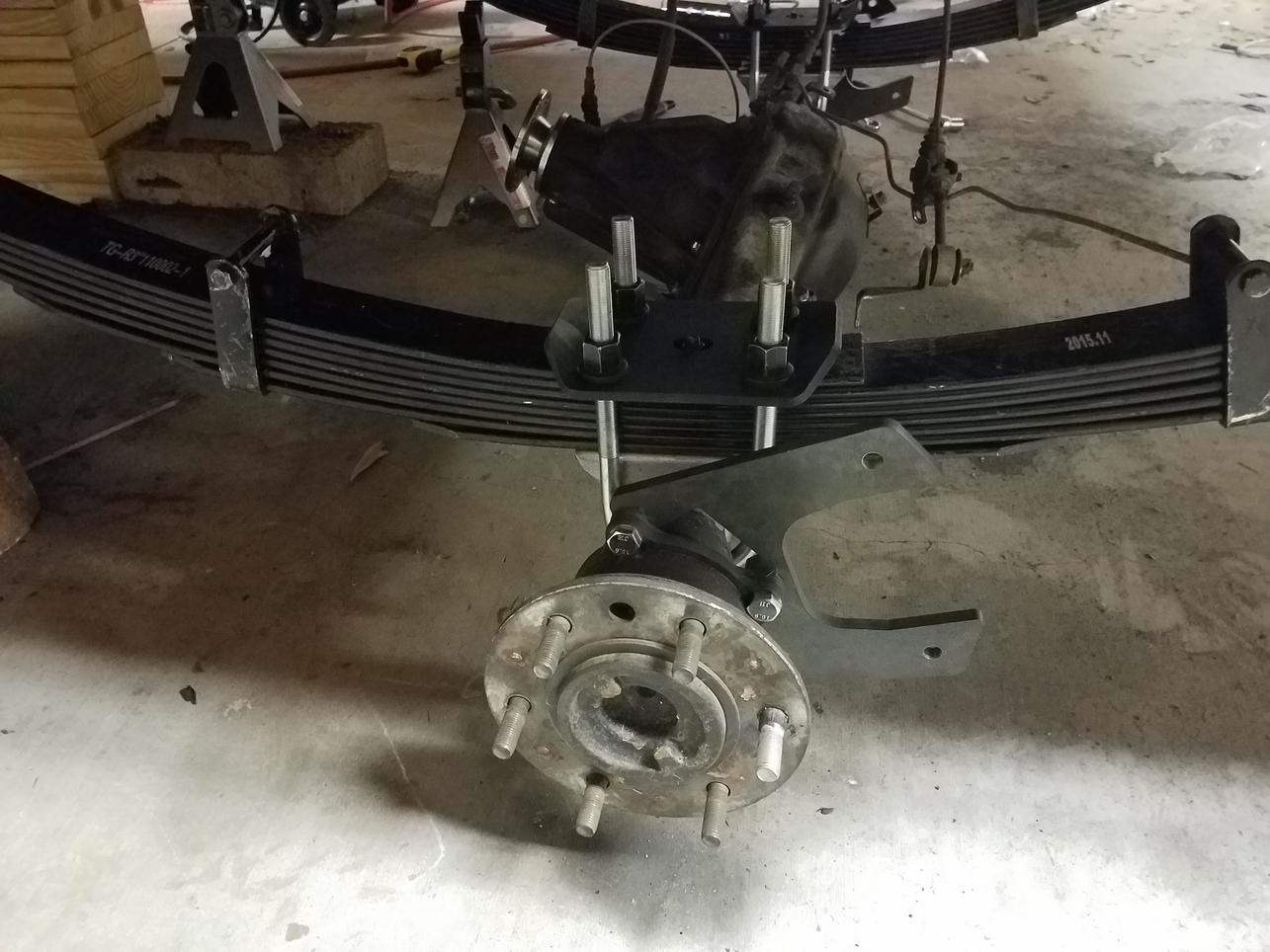

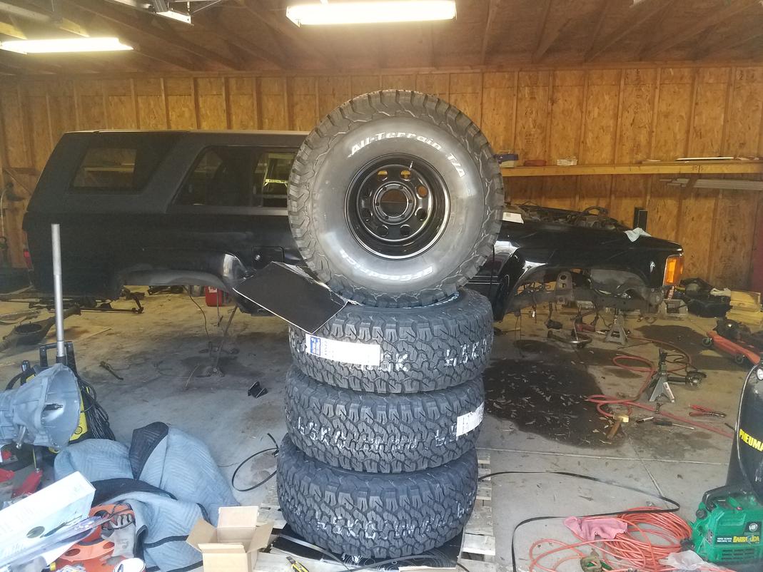

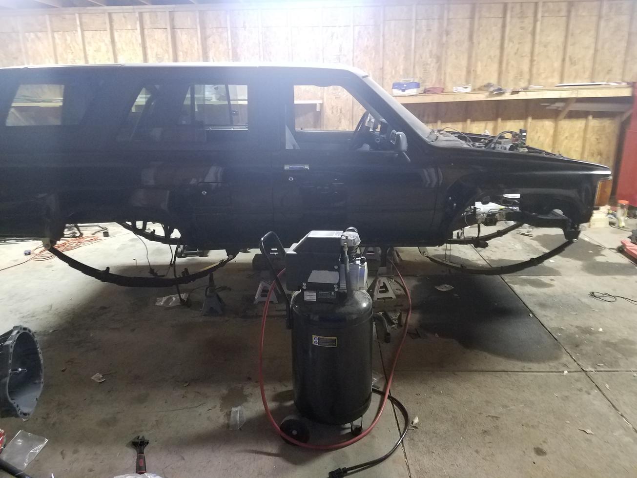

They come with U-bolt flip kits, brake lines, all kinds of goodies. Here's some pics of mine when I was building this portion.

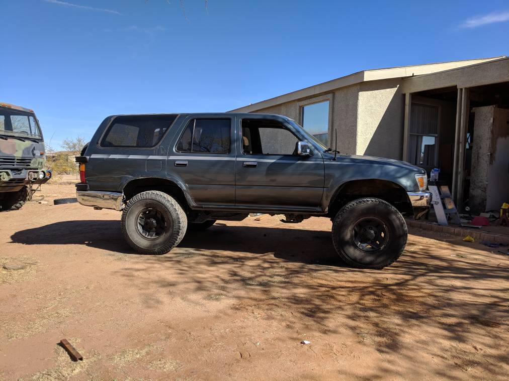

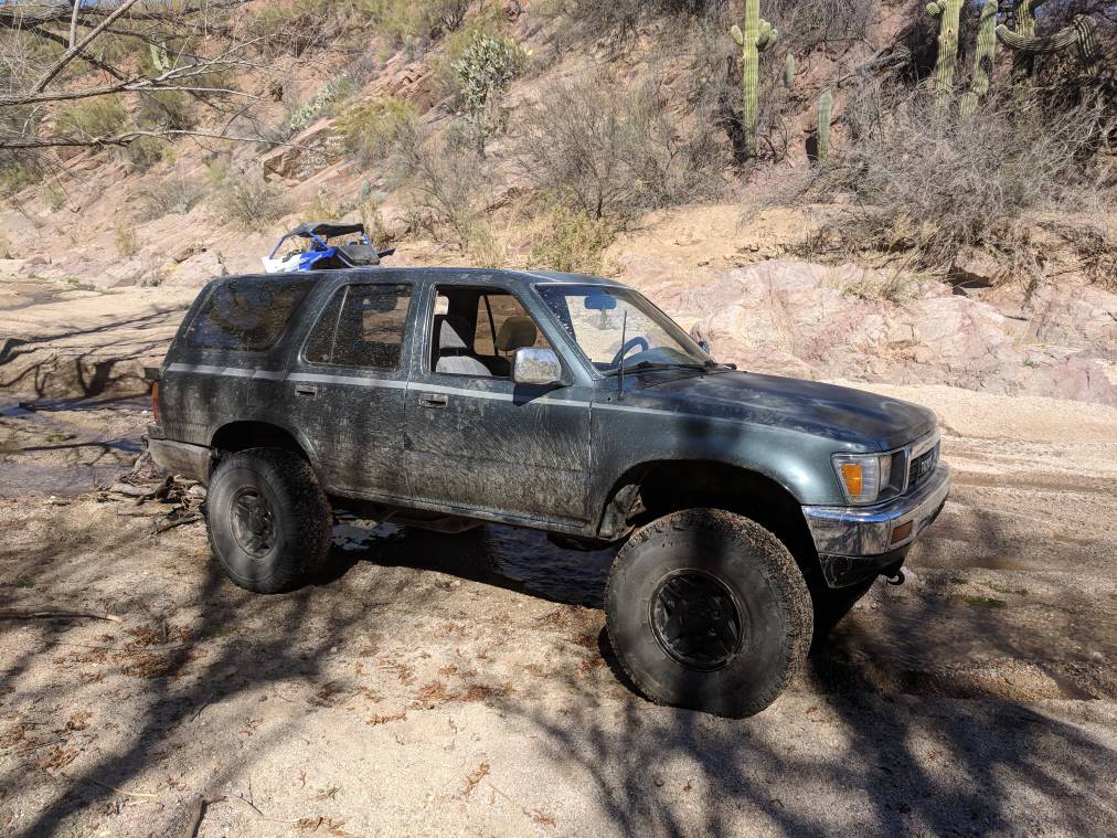

Sup guys. I've been digging around in this thread for a bit trying to make some decisions on the future of my build. It's gonna be for overland stuff. So far I've got BJ spacers and OME shocks and springs that I got on craigslist for $150. We (and by "we" I mean, my qualified mechanic friend) put all that stuff on and it came out perfectly level which is good because we could NOT get those old torsion bars to move. Then I got these BFG 33" mud tires and wheels for free from someone at work so I def wasn't going to turn those down. Right now I just barely get some fender liner rub at full lock, but I can always trim that a bit. But I do know my steering stops need to be adjusted because my turn radius has been garbage ever since I put some new plastic caps on them.
In the future, I definitely plan on replacing the tires with ATs since most of my trip mileage will be on-road and the rims with some Pro Comps. But, I'm trying to decide if I want to get wider tires and the considerations I need to make for that in terms of rim width, backspacing, etc. to avoid rubbing and an overly wide stance (I actually how the stance turned out with these wheels and tires.) What's the benefit of wider tires over narrow and what do I need to consider when making that decision?
EDIT: So, I've learned that I can definitely run a 12.5 inch tire on an 8 inch rim, but I believe I will require another inch of backspacing in order to keep my stance width as it is and put more of the tire inside the wheel well, which it seems like there's plenty of space in there. Is this correct?
